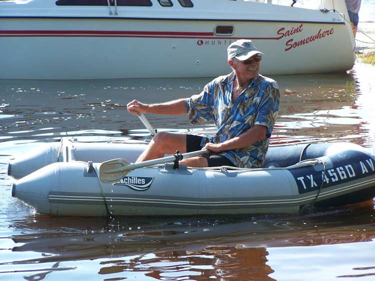

I've had several dinghys over the years, from 6 foot hard ones, to 12'6" inflatables. I now have my second Achilles 7-6 roll up. My favorite by far.
