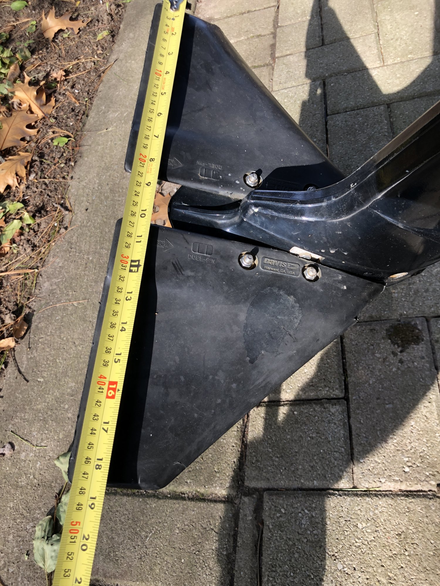

@Hunter216 where did you get the small engine hydrofoil? I have a 2 stroke Johnson 4HP but cannot get on a plane. The foil may make the difference.
This is the foil. Made by Davis, no actual model number but it also says DOEL-FIN
Mounted on a 2003 Merc model 4M. 4HP 2 stroke short shaft.

The Davis Doel Fin currently available says for 5HP and up but looks a lot like the one you have. Probably worth looking in to. I see in your picture it hangs over the back quite a bit more than in the product photos but it sounds like it still performs quite well.
Quite thick plastic so not much flex in the overhanging part. Small motor so top end speed doesn’t make your eyes water anyway :)
