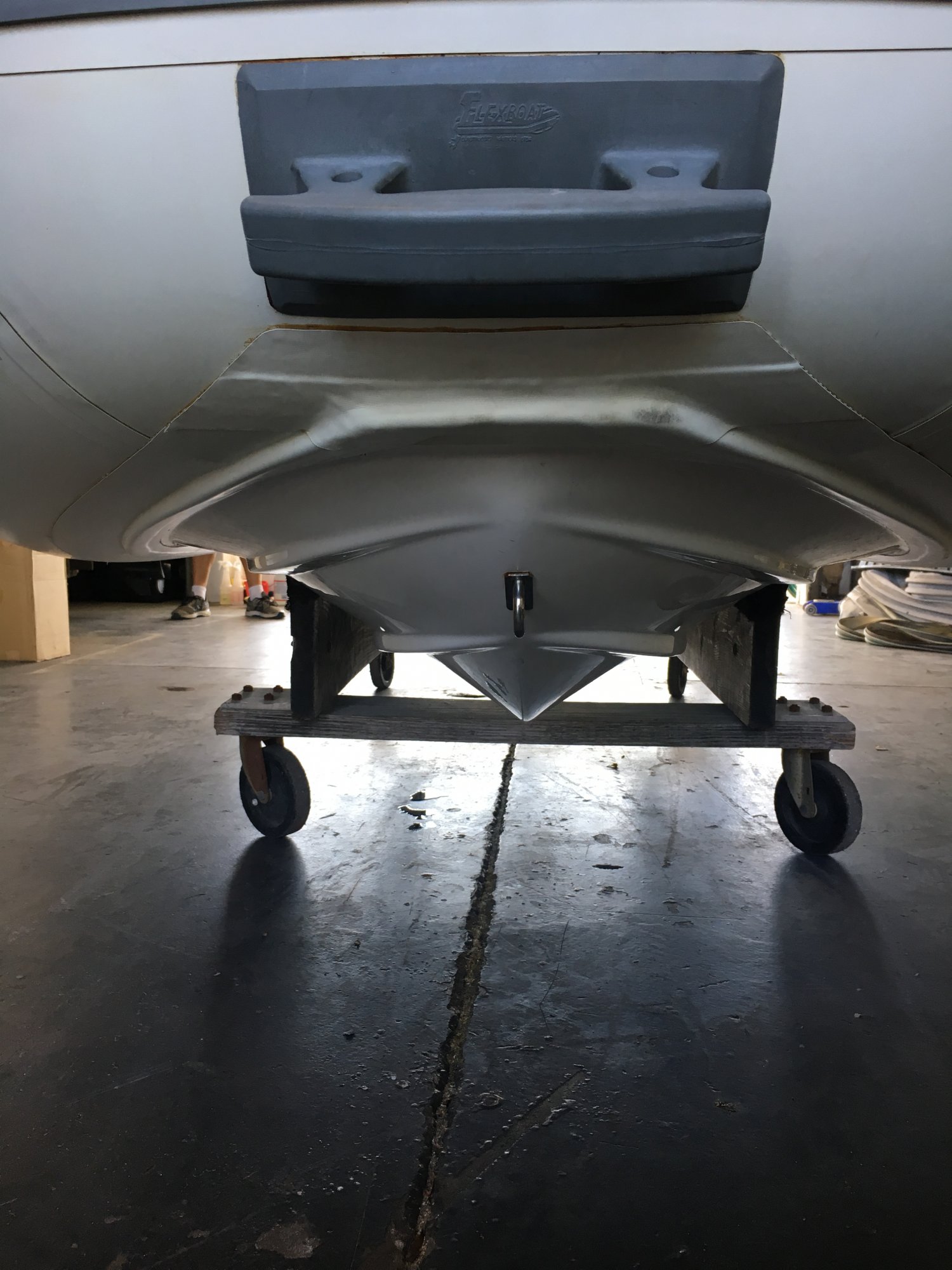

Hull: A deep V hull forward, gradually morphing to a flatter bottom with a bit of a bustle in the aft, and having considerable chines that are designed for more than just strengthening a cheap layup on the hull. The chine design is important because the boat is going to be riding and steering on them. The bottom should sit lower than the tubes the entire run. All of this was missing in that Achilles - in particular the tubes sat below the bottom for most of the hull run and resulted in a moon-bounce ride that was actually dangerous in waves larger than 6". It was the only RIB that ever frightened me.
Surprisingly, if you look at the hull form of the West Marine 360 RIB, you will see one of the better hull form designs out there. Others that are acceptable to us were Caribe, Flexboat, Novurania, and AB (Novurania has since stop making their smaller tiller boats). Attached are bow and stern profiles of a Flexboat showing some of these design elements. There are equally valid variations on this theme. For example, Novurania's design is a deeper V at the stern with a single larger chine, while West Marine's has a pronounced flat bustle almost like a whale tail in the stern with a chine ending further forward. The overall goal is to get the boat on plane and controllable, while not reacting vertically to waves, and guiding water away from the boat instead of inside it.

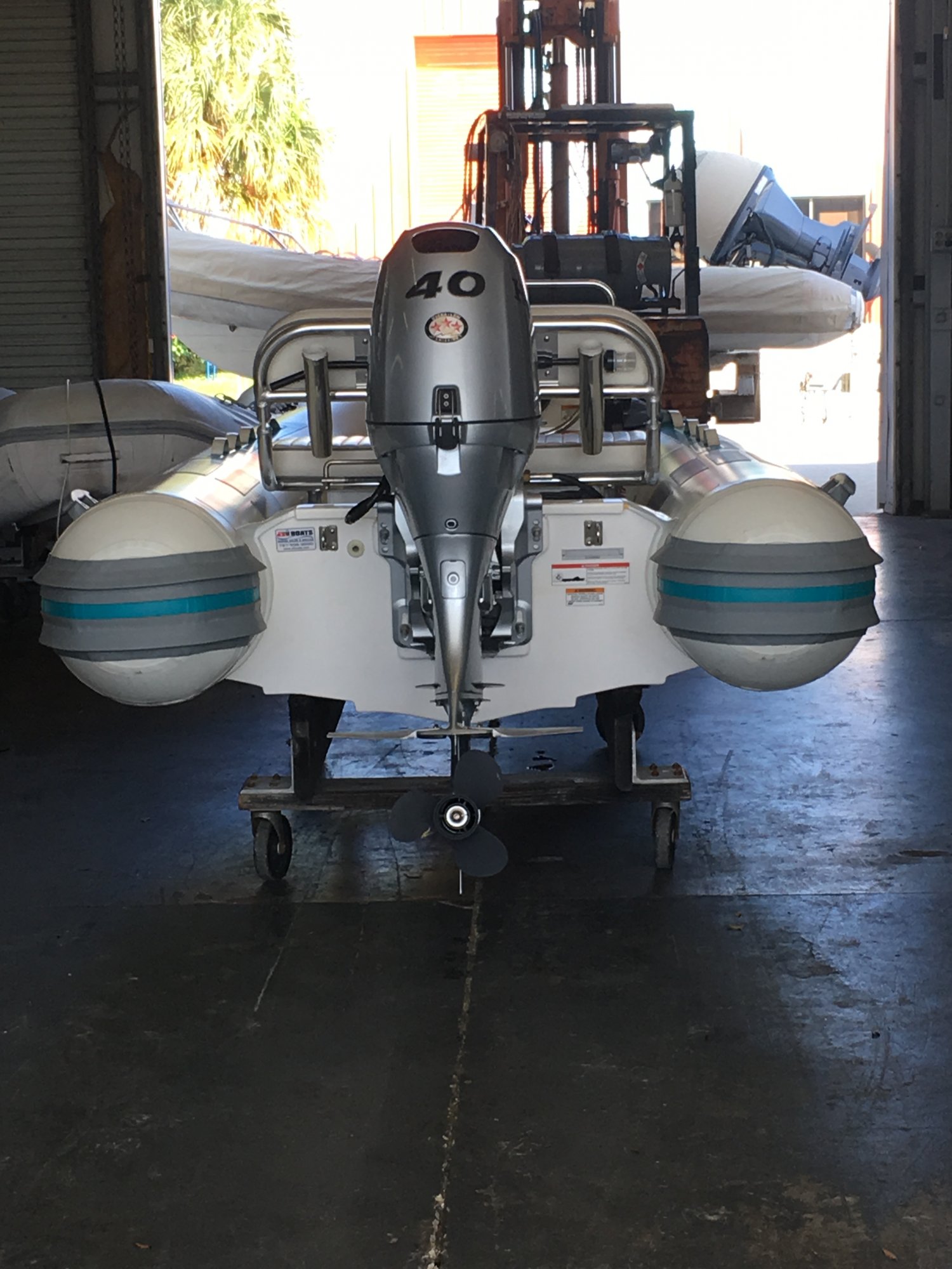

Flexboat is without a doubt the best of the lot. The only downside is weight, but this is also the downside of having a good hull design and heavier tube fabric in general. All the good boats are heavier than all the cheap boats. Flexboat is made in Brazil, and there is only a single US distributor. At the time we were trying to buy one, Brazil and US were having some type of import row with shipments held up. We could not get one in the timeframe we needed it.
At the time, we were living just down the road from the Novurania factory, and I approached them about restarting their smaller RIB line again, or at least pulling out an old mold and making me a one-off. They were actually interested and designed and built a new hull form even better than their old ones. Unfortunately, they had very strong opinions on scantlings, and this hull came out grossly heavy. No amount of discussions with their engineers could convince them that this size of boat and its intended usage didn't need some of the scantling dimensions they were using, as well as some of the design features that added unusual weight. In the end, we had to continue our search elsewhere. They eventually brought the boat to market, but it failed to generate any sales because of the weight. They ended up turning it into a even much heavier console boat. I don't know how that is selling, and they don't publish weight specs for it. A tell, though, is they recommend a minimum 30hp engine for a 11.5' boat.
