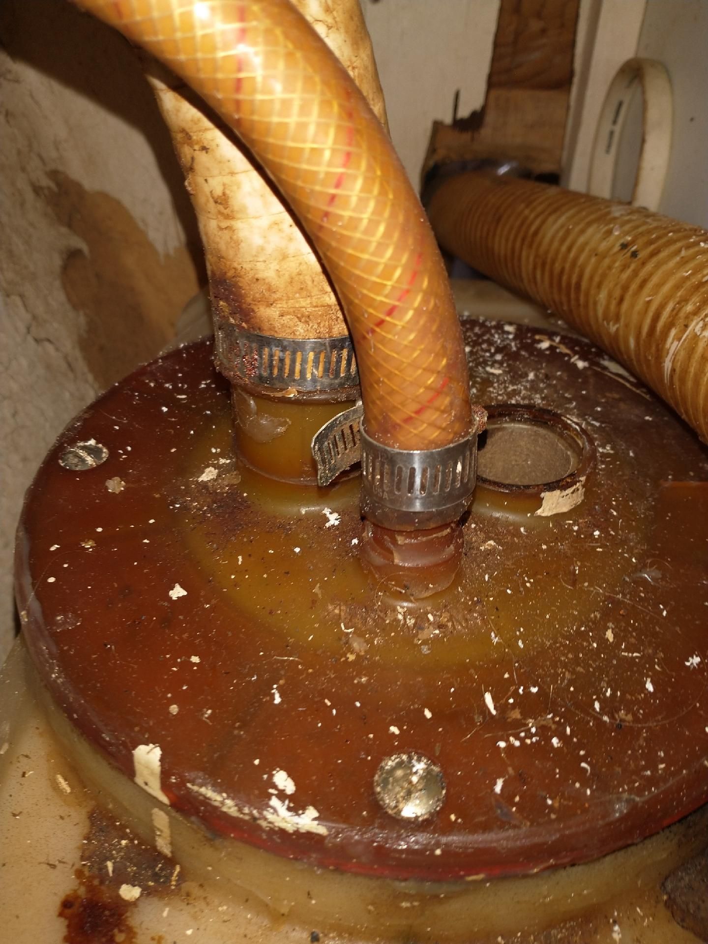

Here it is, Jabsco. Doubt I can buy just the cap so I might have to make my own until I can cut out for a new larger tank.

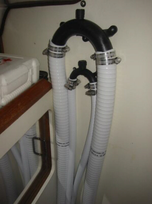

Vented loops can be that low on a powerboat because powerboats don't heel, but to put them the required 6-8" above waterline on a sailboat AT ANY ANGLE OF HEEL, not just when the boat is at rest, puts 'em 2-3 FEET above the bowl. And he's gonna need one in the intake too...and it also needs to be just as high. That one does not go between thru-hull and the pump...it needs to be between the pump and bowl, which requires replacing the short piece of hose the toilet mfr uses with two that are long enough to connect to a vented loop where it belongs. (see attached photos)

The only option I really want to try is to patch or rebuild the tank top if I can't buy just the top. The boat will be at it's mooring for the coming months as a liveaboard.

My latest idea is to remove the tank lid and add a simple, plastic through-hull fitting in the hole where the old fitting broke, and then reinstall the lid and connect the hose. This boat's maintenance was horribly neglected and the walls of the old hoses and fittings were lined with deposits to the extent her little (gloved) finger would not fit. The new head is in and new hoses and loop vent installed up to the last connection to the tank. All I have to do is make that one last connection and performance will be like night and day.
Thanks again Peggy for the contact info. I will try to score a new lid from Jabsco but lacking that I will one way or the other succeed.

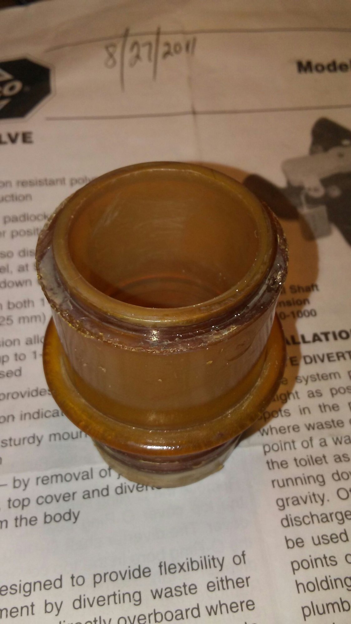

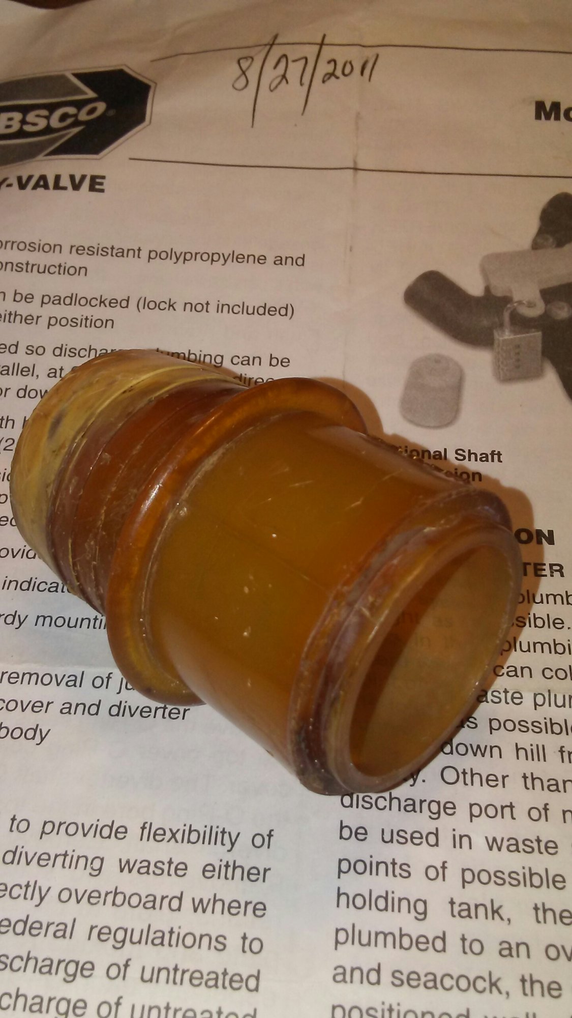

So friends, after cleaning the piece of fitting that came loose from the tank I came to the realization that this fitting did not break, rather it was the connection that failed. You can see in the picture the smooth, finished edge leading me to believe this fitting was attached to the tank with some sort of adhesive. Now, all I have to do is find the right adhesive.

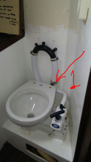

Well that job is done. Made some changes for better performance.

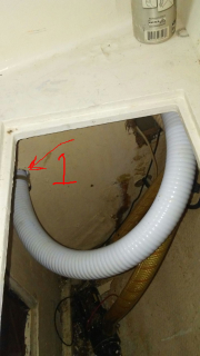

#1 marks the spot where waste goes through the bulkhead behind the toilet and into a forward compartment.
Here is the other side of #1 in the forward compartment. In order for the hose to make the needed bends to get to the tank this hose was originally over 6' long and going through the hole on the upper right that looks like it was cut by an ax murderer. I drilled a new hole higher up and shortened the hose by over 3'. Below is the macerator pump sloppily just laying against the hull. That will be changed.

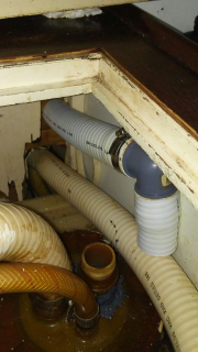

And finally, here is where the hose continues from the forward compartment and instead of looping up and down I added a simple elbow to go right into the tank fitting. Notice the JB Weld. On the other side of the partition on the right is the toilet where our journey began.

Only one thing left to do: install a vented loop in the toilet INTAKE. You'll see where it has to go in the drawing on p.3 of the Jabsco Twist & Lock owners manual Jabsco Manual Twist & Lock owners manual and it needs to be at least 6-8" above waterline AT MAX HEEL, not just when the boat's at rest..which puts it about 2-3' above the bowl on most sailboats That requires replacing the short piece of hose that toilet mfrs use to connect the pump to the bowl with two lengths of 3/4" sanitation hose long enough to put the loop where it--and any discharge loop--has to go (see attached photo for the most common location)...the smaller loop is the intake. The discharge vented loop in your photo is way too low, but a discharge vented loop is only needed if you flush directly overboard (only legal when at sea beyond 3 miles), which is unlikely in this instance so it's really just some unnecessary plumbing that may or may not cause problems if solids flushes aren't followed with enough water to rinse it out.
