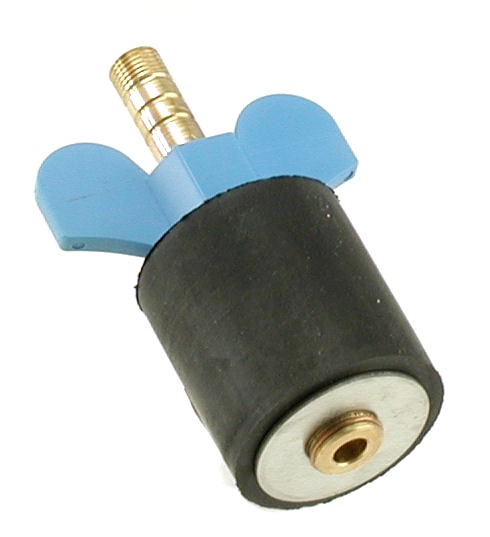

:plus: the traditional emergency fix @justsomeguy
there are a few variations like.
  • Stay Afloat Emergency Leak Sealant
  • then there is the rubber plug.
    FORESPAR–Sta-Plug® Emergency Plug

Thanks Justsomeguy, those plugs look great.

Those emergency plugs look like they are meant to be hammered home for 1 use. Last thing I want to do is stress this area.

Just read the instructions on this -> FORESPAR–Sta-Plug® Emergency Plug
It says just twist and insert by hand, I like that

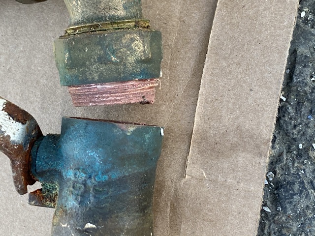

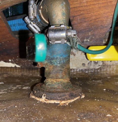

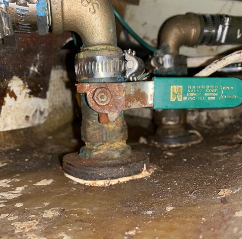

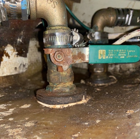

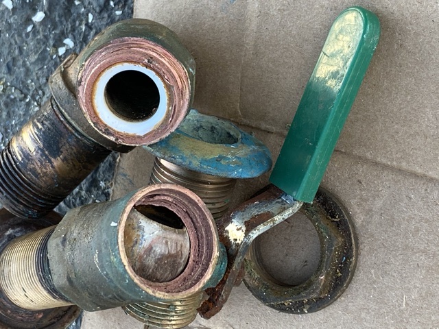

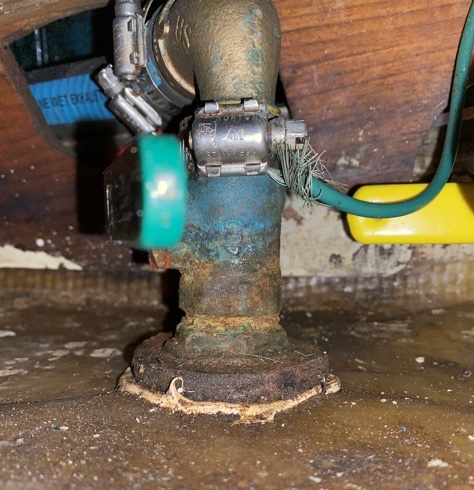

Jim. Safe is a short haul to assure that the seacock has not failed. If failed you may be replacing both seacock and thru hull.

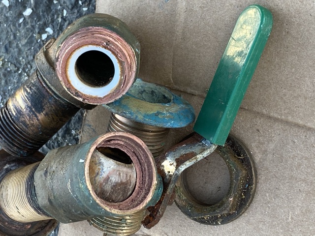

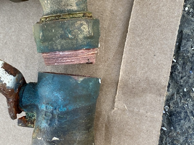

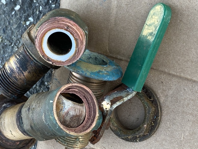

This seacock looked ok. I was worried about its sister next to it. When I attempted to work it the seacock came apart in my hand. It had deteriorated on the inside. Sometimes you never know. I am thankful it happens while I was out of the water.
How the Valve looked before I hauled the boat.
old but serviceable. Never an issue opening or closing the valve.
what happened when I tried to remove the valve so I could inspect/replace the thru hull
Turned out to be a just in time fix.

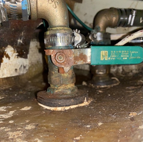

View attachment 185644View attachment 185645
View attachment 185640View attachment 185641
These should have been a red flag from the beginning. These are NOT seacocks. This is a ball valve threaded onto a through hull. More over they look to be brass instead of bronze.
I recommend all start with reading this article from Mainesail. Seacock & Thru-Hull Primer - Marine How To

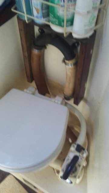

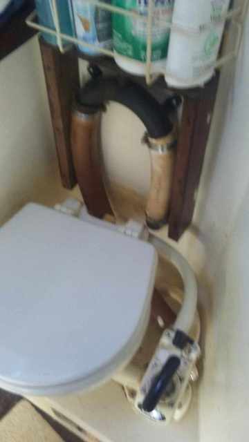

Here's a pic of the head with the loop behind it. Since the loop is above the waterline, is it OK to change the hose from head to loop? Still itching to shut that waste seacock but I'll be satisfied for now just to change out the head. The head needs rebuilt and the kits cost nearly as much us a new head so I'm starting fresh and replacing the whole unit. Guess I'll do the hoses and seacocks when hauled out.
24,454
Oh Jim... That looks to be a messy task. Flush Clean the tanks and suck all the hoses using a disposal system first. You can deal with a dirty hose if the hoses contents have been flushed clean and the tanks emptied. If you have blockage in the hoses there is not a mask the can protect your nose from the stench. Then is when I resort to a dab of Vicks under my nose and short exposure time events.

Here's a pic of the head with the loop behind it. Since the loop is above the waterline, is it OK to change the hose from head to loop? Still itching to shut that waste seacock but I'll be satisfied for now just to change out the head. The head needs rebuilt and the kits cost nearly as much us a new head so I'm starting fresh and replacing the whole unit. Guess I'll do the hoses and seacocks when hauled out.View attachment 185692
As long as you’re sure the top of the loop is at least a few inches above the waterline then I agree you should be safe to replace that section of hose. But with regard to leaving the seacock open, you need to weigh those risks carefully. You’re basically trading one risk (that the seacock could fail when being closed) with another (that some other hose or fitting inside the seacock could fail with the seacock open). Moving the hoses and fittings around to do things like update the plumbing only increase the chances that the outermost section of existing hose could crack and fail. If it were me I’d probably hold the body of the seacock firm and gingerly try moving the handle to see if it could be moved without moving the body too much.

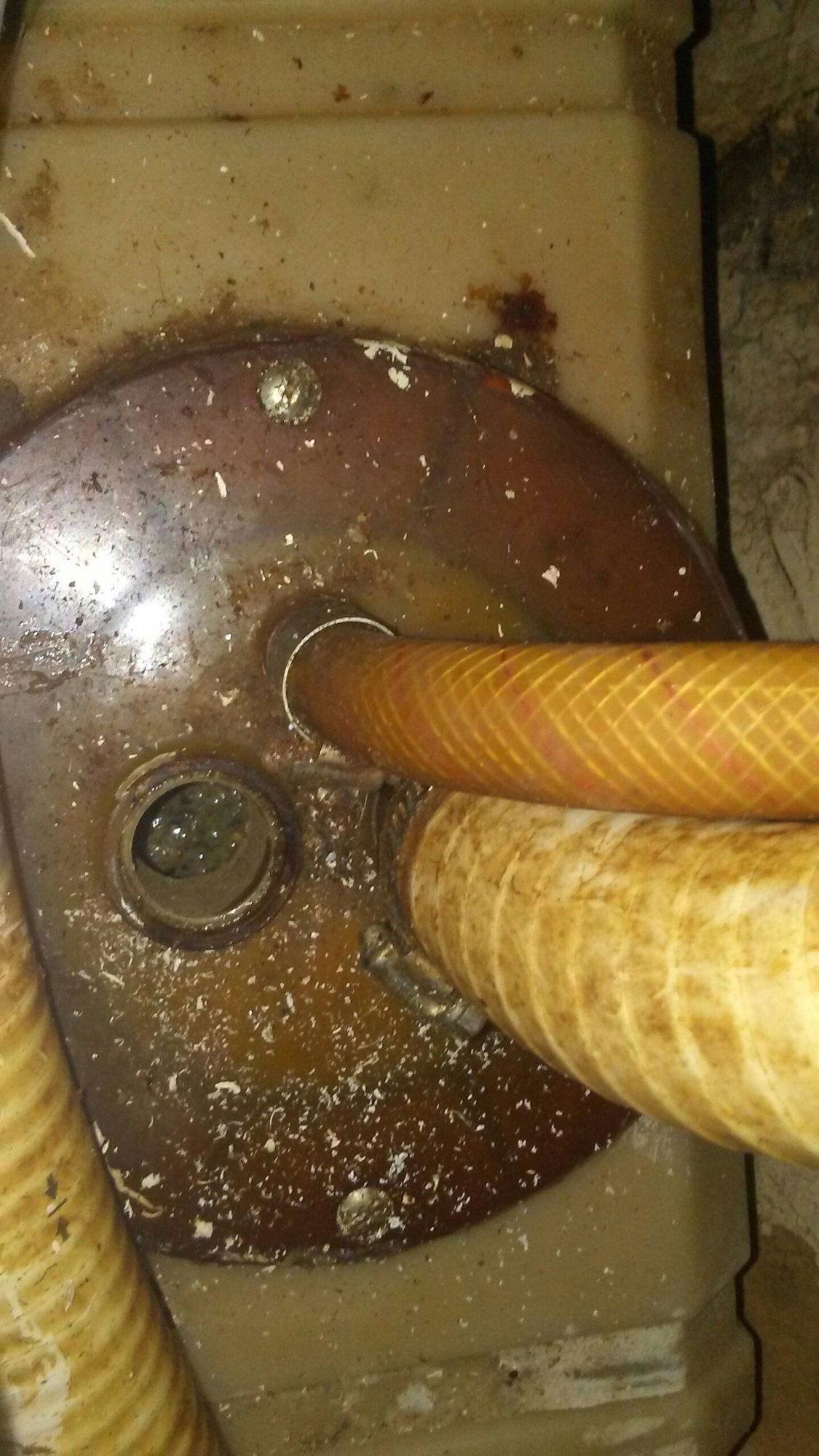

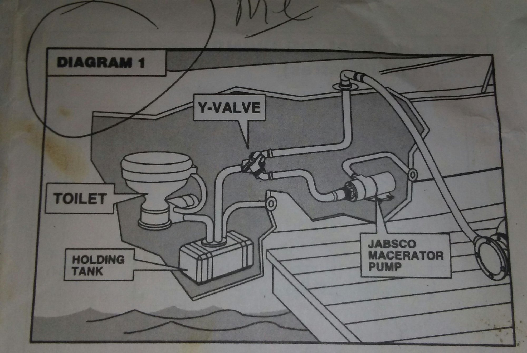

So, finally getting my head around the head and it's tributaries I realized so long as the holding tank is above the waterline I can replace all the hoses from head to tank with no worries of flooding the boat. The last hose to remove went into the top of the holding tank and wouldn't you know it, the fitting broke. (see photo)
The top, small hose is the vent, the hose below to the right goes to a Y valve pumpout/macerator) and the hole to the left is where the hose coming from the head should attach. The tank looks very old and I'm wondering how to proceed. Let me say right here that this is a low budget project until we have all systems working and decide whether the boat is worth putting any real money into. My first thought is to attempt to epoxy the neck of the broken fitting and gently reattach the new hose but I don't know what kind of plastic this is and what will hold. Second thought is to replace the round tank cover but I have no idea if it is possible to find something that looks like the pic. Third is to make my own tank top cover with 3 new fittings. Lastly (because we would like to one day put in a larger tank but not now). is to replace the tank with another the same as what's in now.
So, asking for help again. Sorry to stink up the forum but believe me, it's worse on my end.
In with the boats paperwork was a manual for the Jabesco Y valve with this pic. The tank looks just like this. Maybe an old Jabesco tank?
