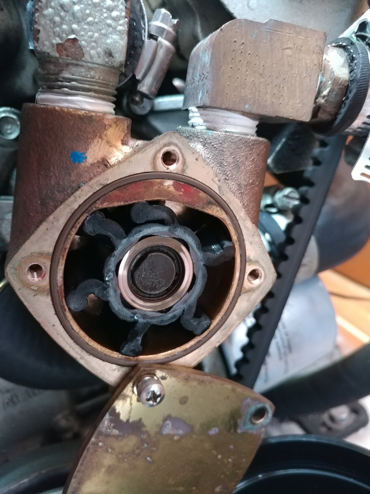

I'm no expert, but when was the last time that impeller was changed? It doesn't look so good.
Likes: DaveJ

WOW.. look at that impeller! SawyerCurt is right.. i would replace it, there's a good chance that's your issue.
May 12, 2004
1,505
Agreed. Replace ASAP. If that were to deteriorate any further and break up, it could possibly block chambers in your heat exchanger causing you a lot more headaches.
BTW, how is that impeller even sucking water?

I agree to change it, right away. But I have seen worse that work fine. But it looks like it's about to self destruct. I think it would still pump OK, for now....

Ok thanks all, I have a replacement, I guess I don't understand what is bad in the picture. Any tips I should take away?

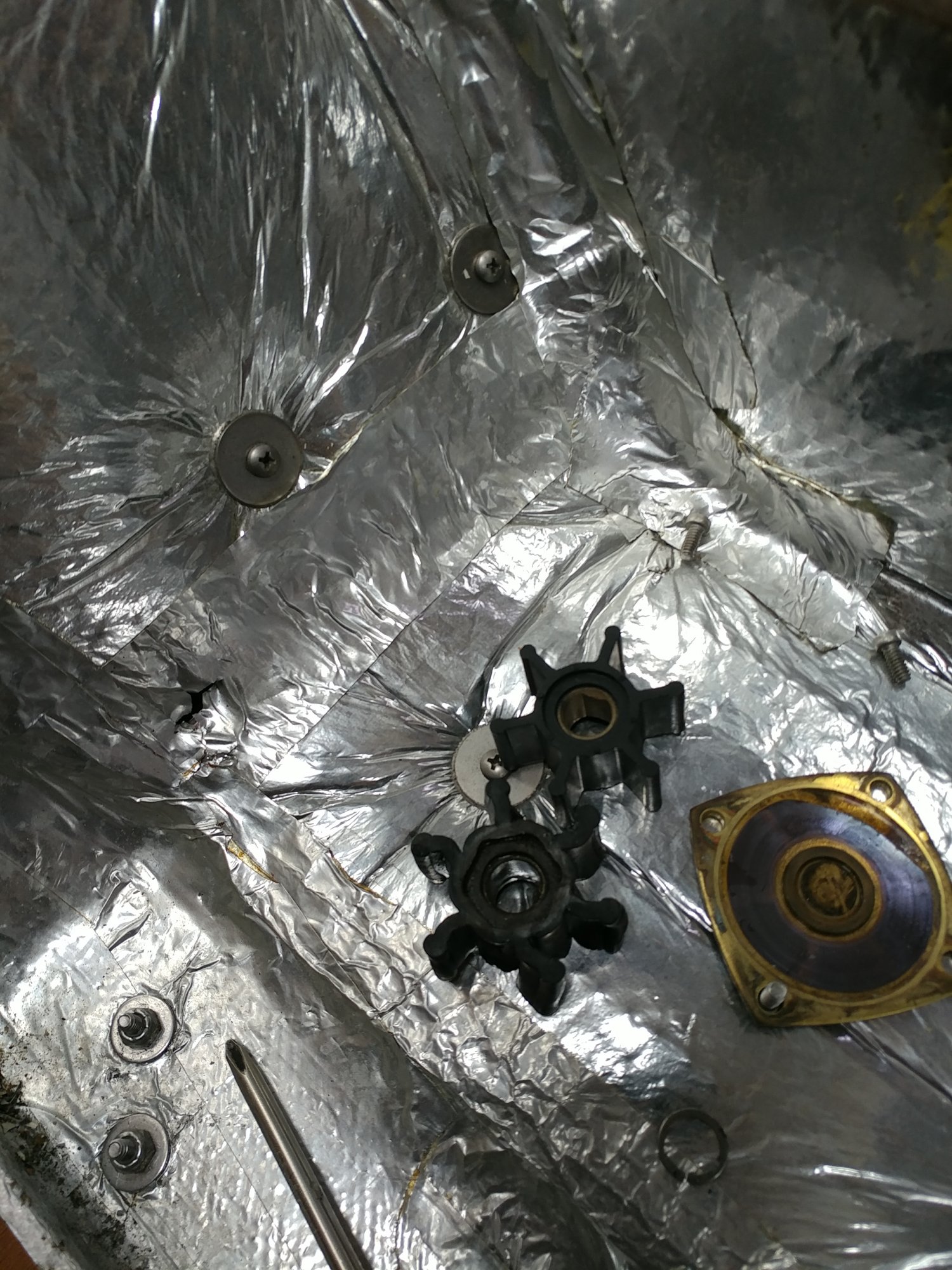

Easy fix yesterday for a change! No sailing but my daughter had fun with the canoe around the marina. Hope for some wind today to make high lake bearable.
Yes.
The grey circular area is the worn seal against your pump's face plate.
The new one is a perfect circle.
That face plate seal will continuously bypass and reduce your water flow.
The flex vanes are about to break off and lodge in your exchanger.
Changed, just in the nick of time!!
I am not so sure the impeller would even turn...it looks like it is completely delaminates from the hub that makes it turn.
I see you already changed it, can’t wait to hear how well it works now.
JamesG, much better response than mine, explained simply. Only so much I can do on a phone....
JTR, glad you posted this, some of us need the reminder to change that impeller....even if the temperature reading is OK. Mine has been in 2 years, will order the new impeller tomorrow.

Got out yesterday, water temp was 79-82 degrees, run of 2500 rpm for 45 min temp gauge showed a few degrees under 180. Ran her a bit harder coming back and stayed below 180 by maybe 1-2 degrees. I'm disappointed that the new impeller did not get me back to 170. We have a lot of grass in the lake but the stainer is clean and flow is good and increases with more throttle.
Sounds like you finally cleaned your temperature sensor too.
Crud on that sensor insulates it a bit or lower sensed temps.
Most diesel engines temperatures are controlled by its Crude Thermostat.
180°F sounds great.
