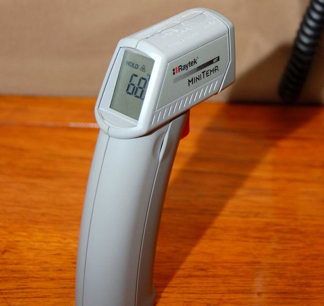

You can buy a fairly inexpensive IR thermometer (inexpensive in the boat world, I guess) and check the temperature at various parts of the engine. I like this little one.
Likes: JRT

I haven't seen this mentioned. Here is how I assess heat issues on Smitty.
Jun 11, 2004
1,933
Oday 31 Redondo Beach
Precision is ±0.1°F
Inexpensive non contact thermometers are great and I think everyone should have one but don't confuse resolution with accuracy. While the readout may resolve to .1 degree F the accuracy is more like plus or minus 3 degrees F. Not a big deal but something I think a lot of people overlook (and the advertising leads them to do so).
