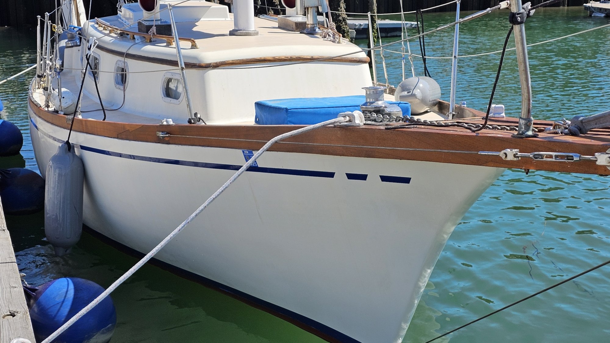

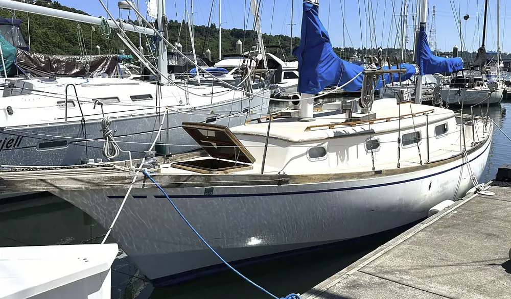

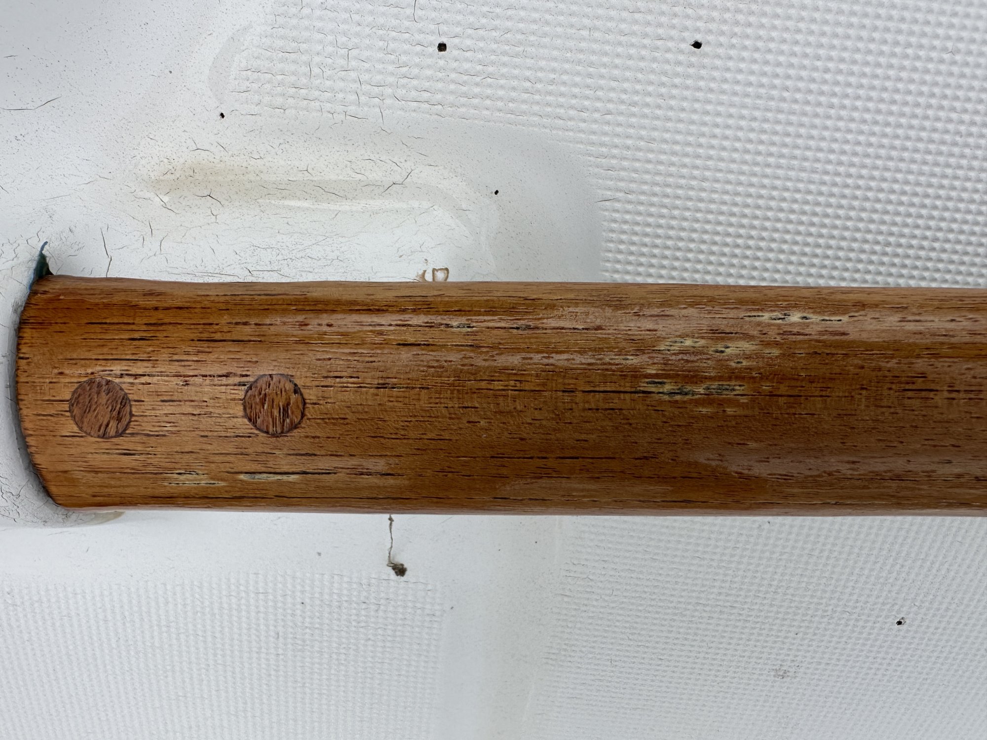

I have been systematically getting rid of varnished surfaces on our boat. It looks good when pristine, but looks shabby when it starts to peel and is kind of a pain to restore if you let it go too long. With oil, we do a deep clean in the spring and usually one or two other light cleans throughout the season. We just do a bit of oil here and there as it occurs to us. Surfaces we walk on don't get oiled.
A previous owner covered all of our toe rails and some other previously beautiful wood with some stain/sealant combination that just completely took away the natural beauty of the wood grain, giving it the appearance of simulated wood grain panelling from the '70s. Then, they varnished over that ... I guess ... and eventually let that go.
Before:
After a bunch of sanding, scraping, scrubbing, and oiling:
The lighting in the photo isn't great, but the wood maintains a nice satin sheen. It is still definitely aged wood, but at least it no longer looks neglected and it only takes maybe an hour per year to maintain.

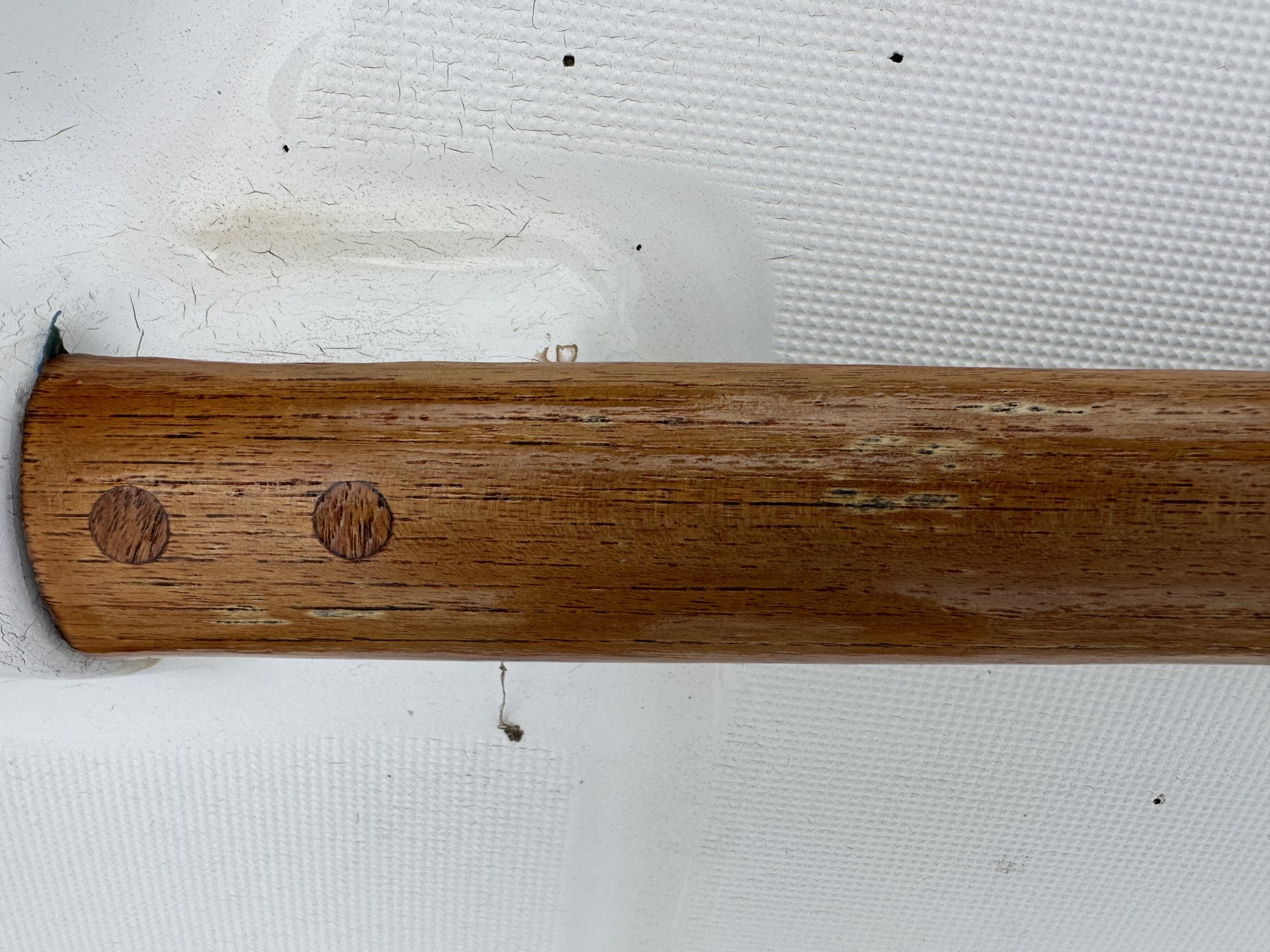

My Beneteau 311 has (with the exception of the inserts in the cockpit) not too much teak, so I've done a careful job on the companionway trim and the hand rails with 3 coats Cetol Natural Teak + 3 coats Cetol Gloss.
It's starting to show some age, so before it gets too far and I tackle it, I'd love to know what folks here do in such a situation. In the past I've sanded the small area to at least get the gloss off and show a little bare wood, then NT + gloss.
Suggestions? I don't want to screw up my previous nice job :) .
Think you are on correct track. Scrub it well & dry. Very light sanding to remove gloss & recoat. I usually get 3-4 years before recoat is necessary. I use Semco on teak seating surfaces.

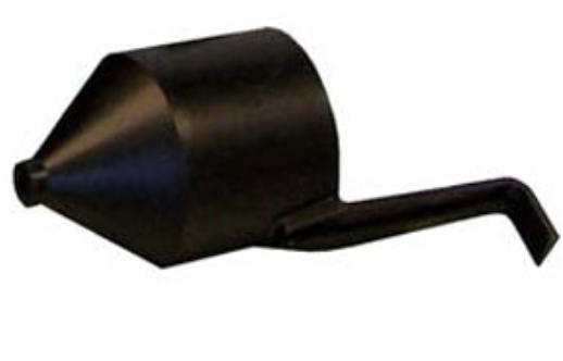

To fine tune your finishing process.
Keep a log each time you paint of your finishing process of:
1. Viscosity, with a #4 ford viscosity cup in seconds
(This is specified by manufacturer). In the manufacturer's technical data sheet (TDS), also known as a Product Data Sheet (PDS), It is a document that details the composition, physical properties, and proper application of a specific paint product.

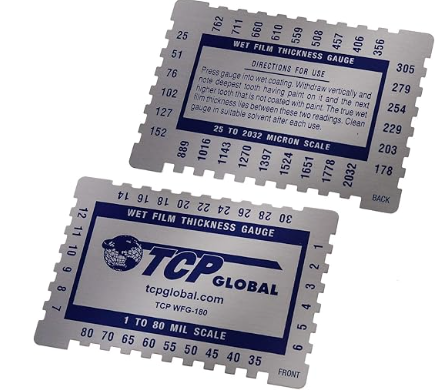

2. It's thickness, with a wet film thickness gauge. to achieve a consistency in the desired thickness. Some finishes have a maximum build. You will need to know the percentage of solids by volume of paint after it has dried. 33% solids by volume at 4 mils thick wet, will be 1.33 mils dried. Three coats will be 4 mill after drying.
(Finished thickness as specified by manufacturer)

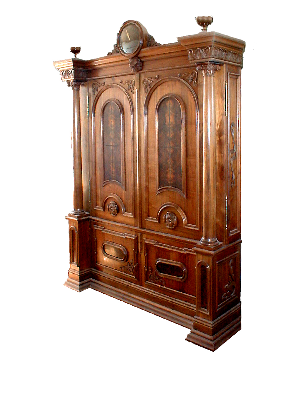

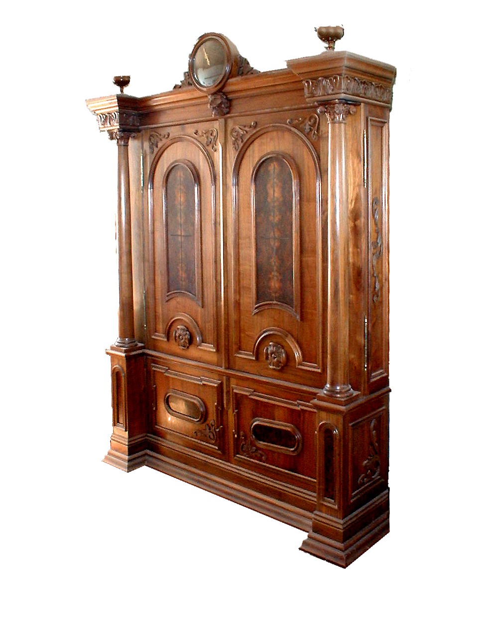

Here is one of my design and build.
The Solid Walnut Armoire I design and built in Victorian revival style.
A story in wood of the Arthurian myth as told by Geoffrey of Monmouth's Historia regum Britanniae, written between 1135 and 1139 and others.
The lower section is about Merlin’s encounter with Uther Pendragon the building of a castle and Arthur father Askanar. There were two hidden dragon eggs under mountain were it was to be built.
Excalibur is the sword that divides the doors and extends into the lower sections connection the two story of Arthur and Merlin.
The upper section is about Arthur Camelot, as you look at each carving you can attribute them to Arthur story. The handle are dogwood flowers for the christ, shields are for the Knights of the Round Table, columns are fore the Camelot, Excalibur connect the two stories together with the story of sword and the stone, on the hilt of Excalibur is a lions head is for Arthur, a top of that is a clock for the round table its self, and the finials are the for the grails and the search of the purer of heart.
Picture was taken before it was completely finished.. I used Waterlox but I normally used a conversion varnish that was used by well-known builder of a grand piano company
