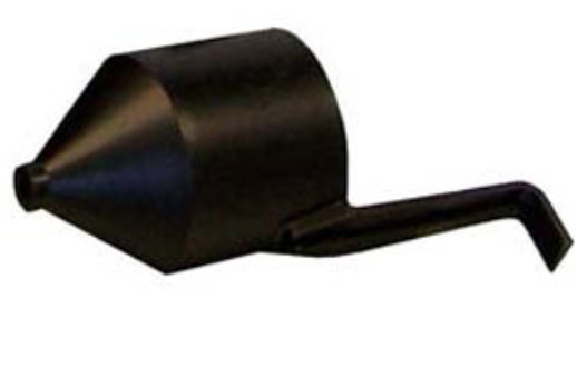

Keep a log each time you paint of your finishing process of:

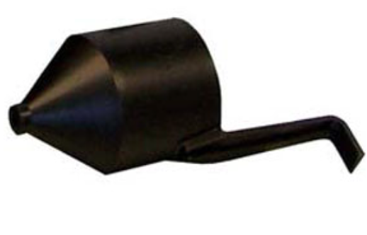

1. Viscosity, with a #4 ford viscosity cup in seconds
(This is specified by manufacturer). In the manufacturer's technical data sheet (TDS), also known as a Product Data Sheet (PDS), It is a document that details the composition, physical properties, and proper application of a specific paint product.

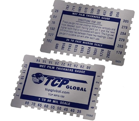

2. It's thickness, with a wet film thickness gauge. to achieve a consistency in the desired thickness. Some finishes have a maximum build. You will need to know the percentage of solids by volume of paint after it has dried. 33% solids by volume at 4 mils thick wet, will be 1.33 mils dried. Three coats will be 4 mill after drying.
(Finished thickness as specified by manufacturer)
