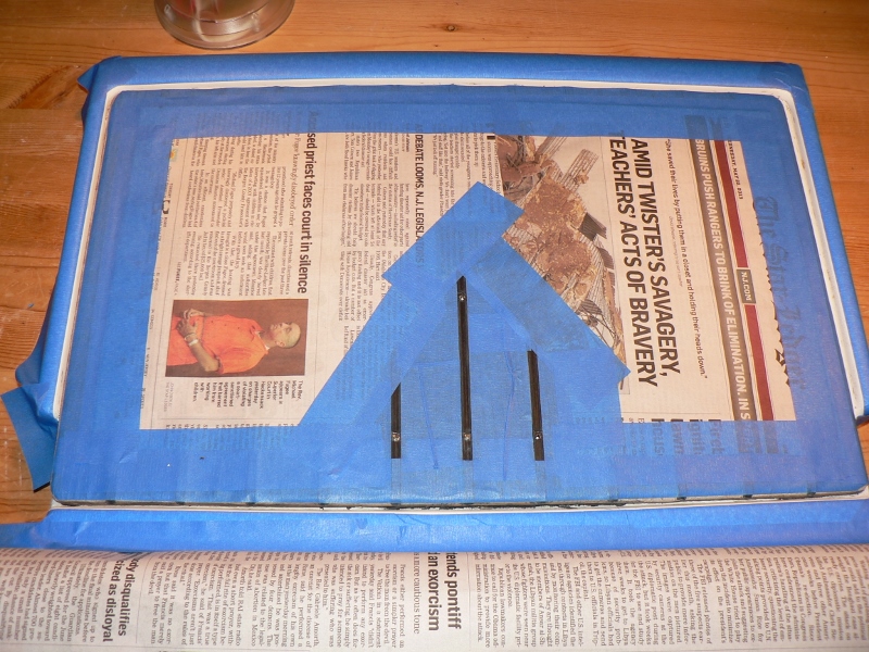

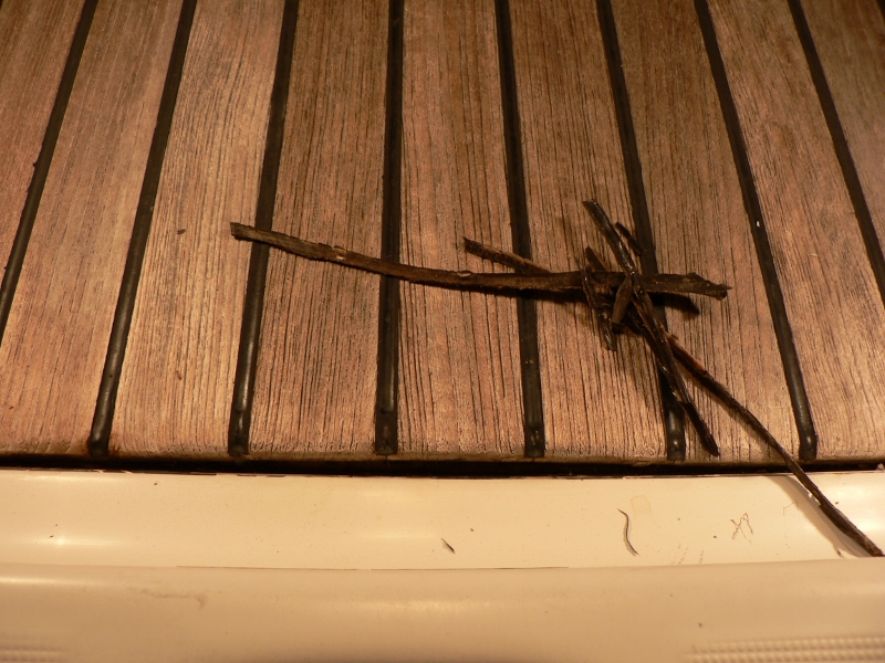

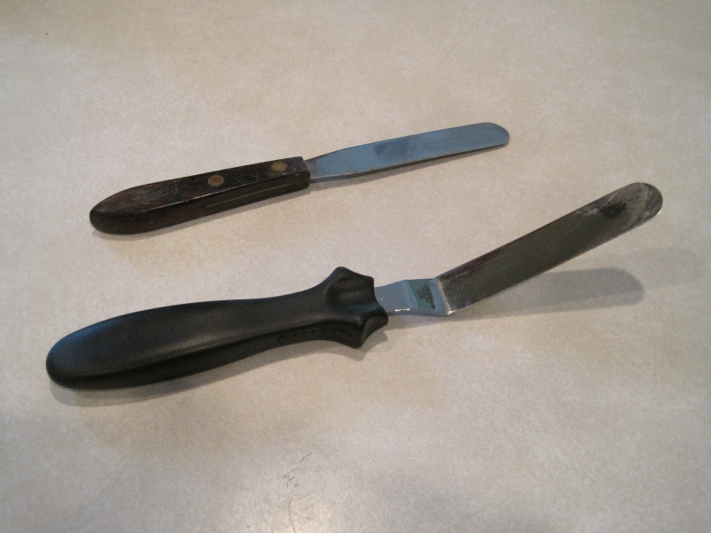

I used a small (1/2" wide) spatula with a very bendable blade to clean underneath the slats without trying to remove them. Worked reasonably well.
I have some photos if you are interested.

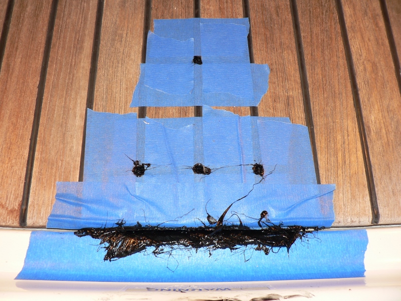

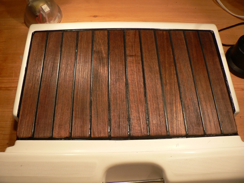

Luckily my problem was in the removable seat, so I could bring it home. That made it easy to use clamps to hold the teak in position while the adhesive dried. Just noticed that I have another problem which will need to be repaired in position. Applying pressure will not be as easy.
Also, removing the old adhesive and water with a thin rag helped. You could see when the location was finally dry.
Supplies: Boat Life Silicone Rubber caulking (black)
Sikaflex 291LOT adhesive (black)
#6 x 1/2" stainless screws
Good luck......

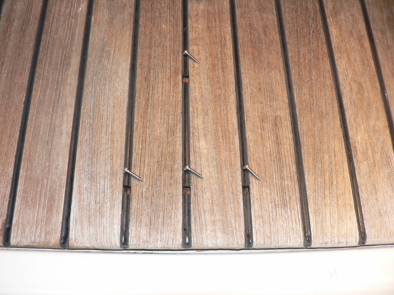

Hi Ron,
Thanks the photos. They're very helpful. Are the screws important? Can you recall how long they are? Thanks again.

I used the screws because Beneteau suggested them and wasn't convinced that adhesive only would do the trick. I believe they were #6 x 1/2" stainless steel.
