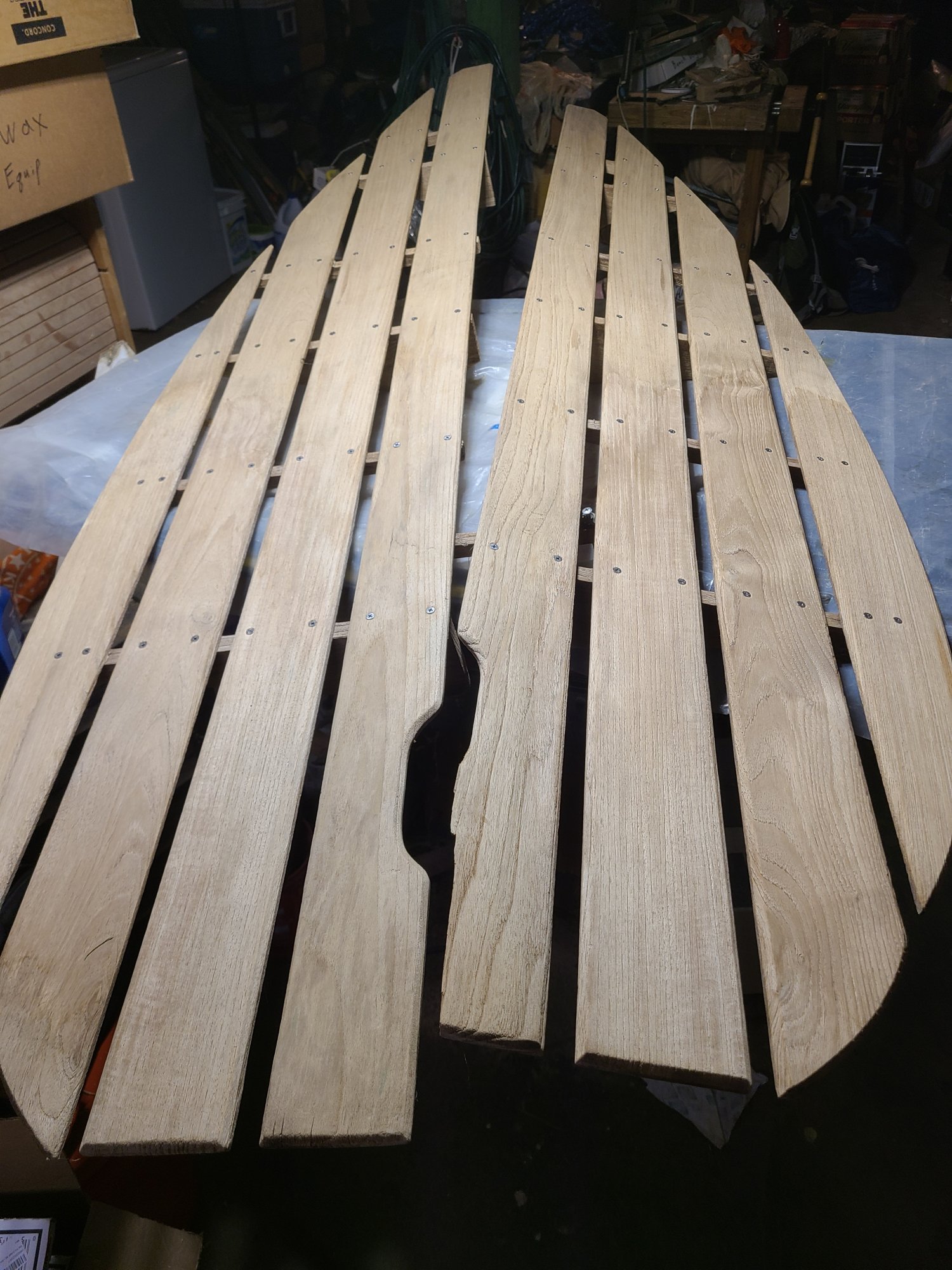

I'm restoring an old Trinka 10. The original teak floorboards were oiled, but I'm tempted to varnish them, just because I like the looks of varnish better. I'm thinking I'll do a satin final coat with non-skid texture if I varnish. What do you folk think?

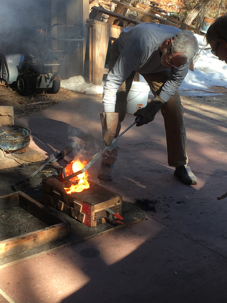

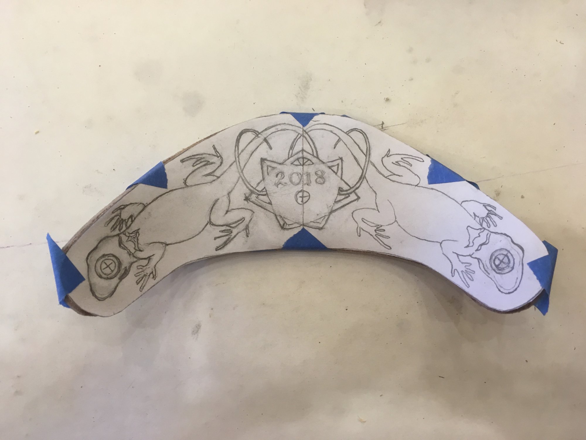

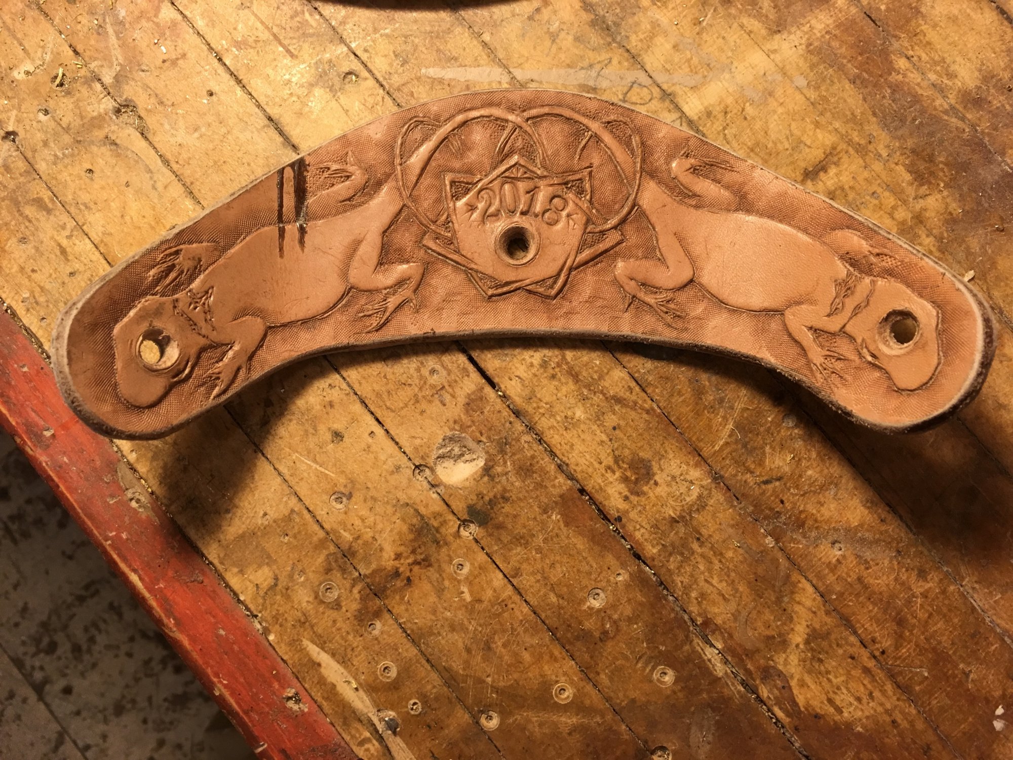

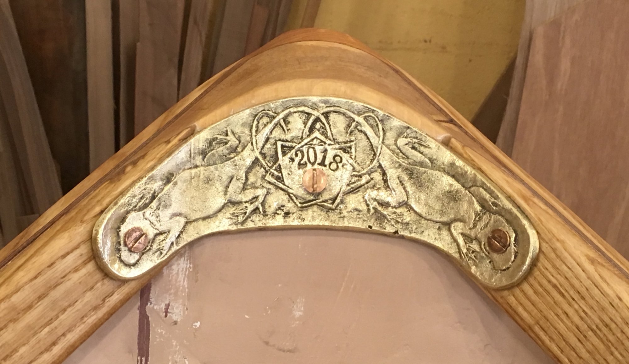

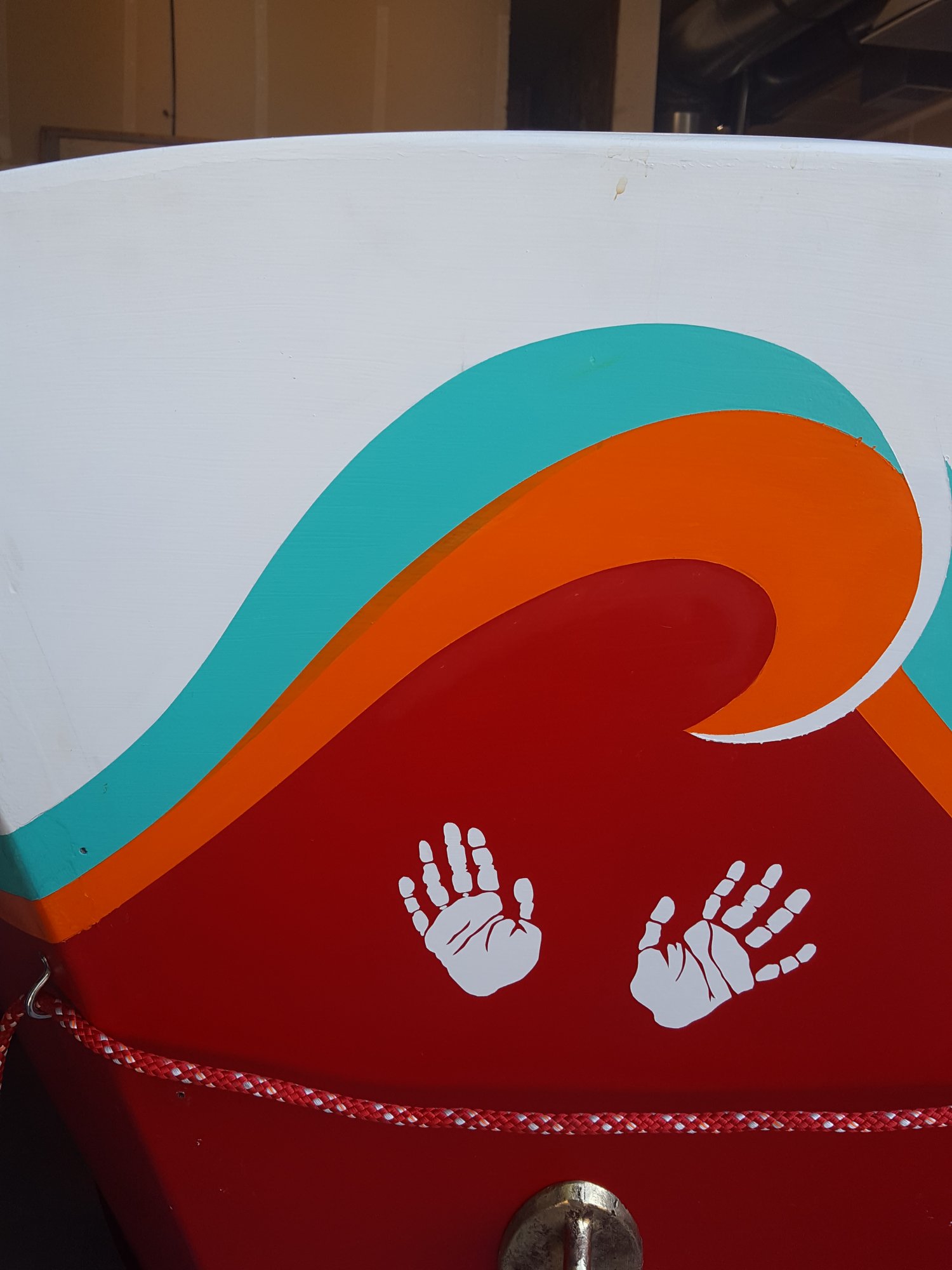

When I built my dory I prepared a gallon of "boat soup" under the direction of Grand Canyon doryman Brad Dimock of Fretwater Boatworks. Mix 1/3 varnish, 1/3 linseed oil, 1/3 turpentine (NOT thinner). A dolllop of japan drier and a dash of pine tar for fragrance. No teak aboard the dory, so your mileage may vary. The dory has ash for the gunwales, cherry for the bow and transom trim, Port Orford cedar frames and hydrotek marine plywood. Everything looks and smells wonderful. I enjoy the annual ritual of recoating everything. Wipe it on. Wipe it off. Let it dry. Go boating.

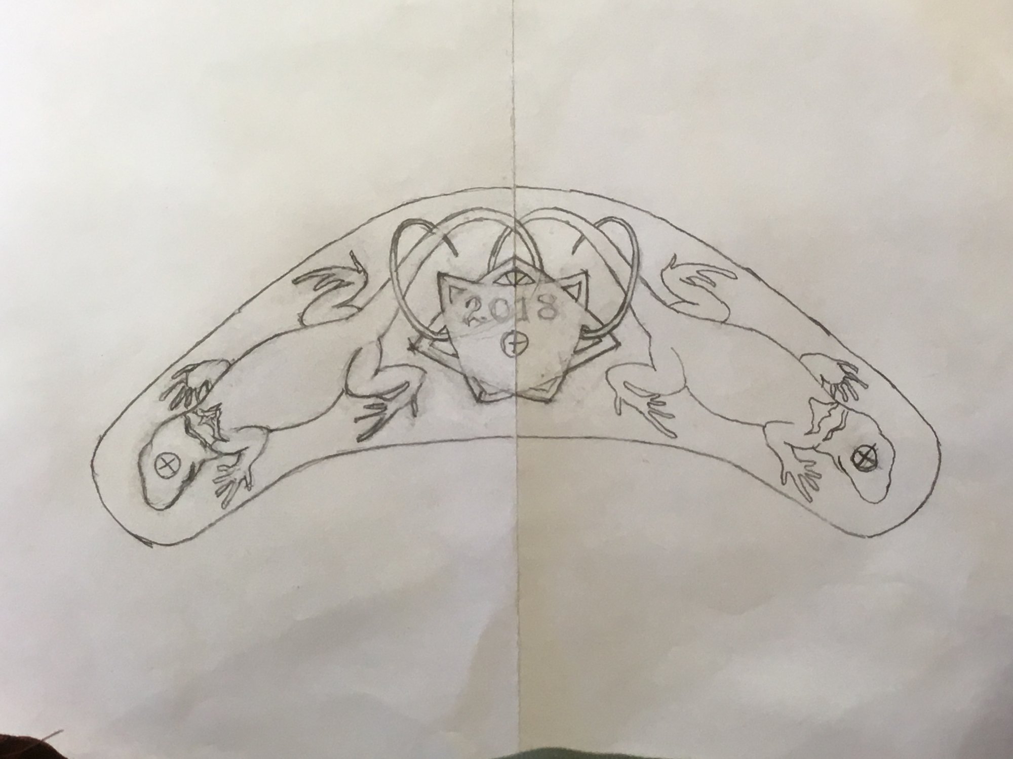

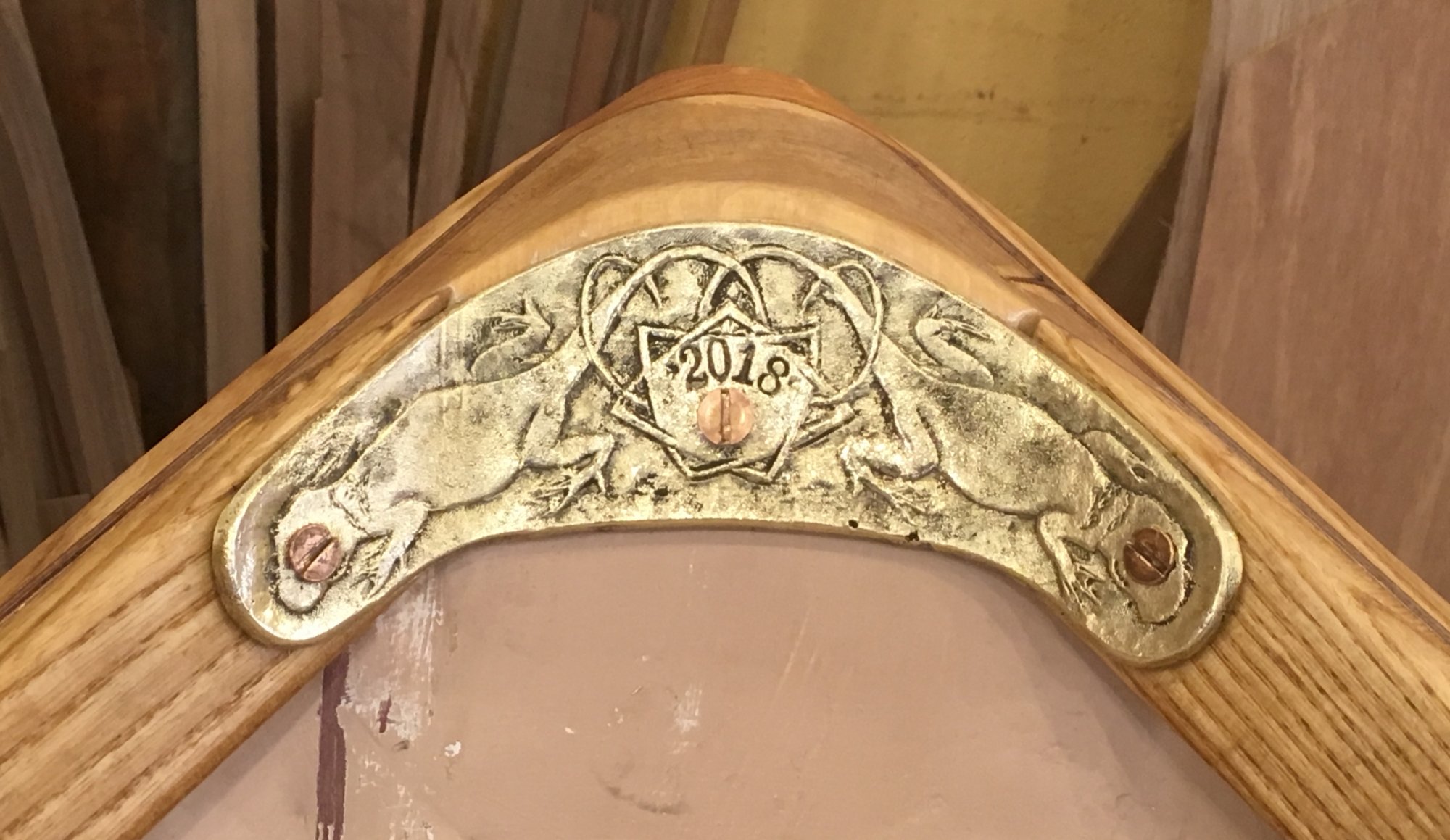

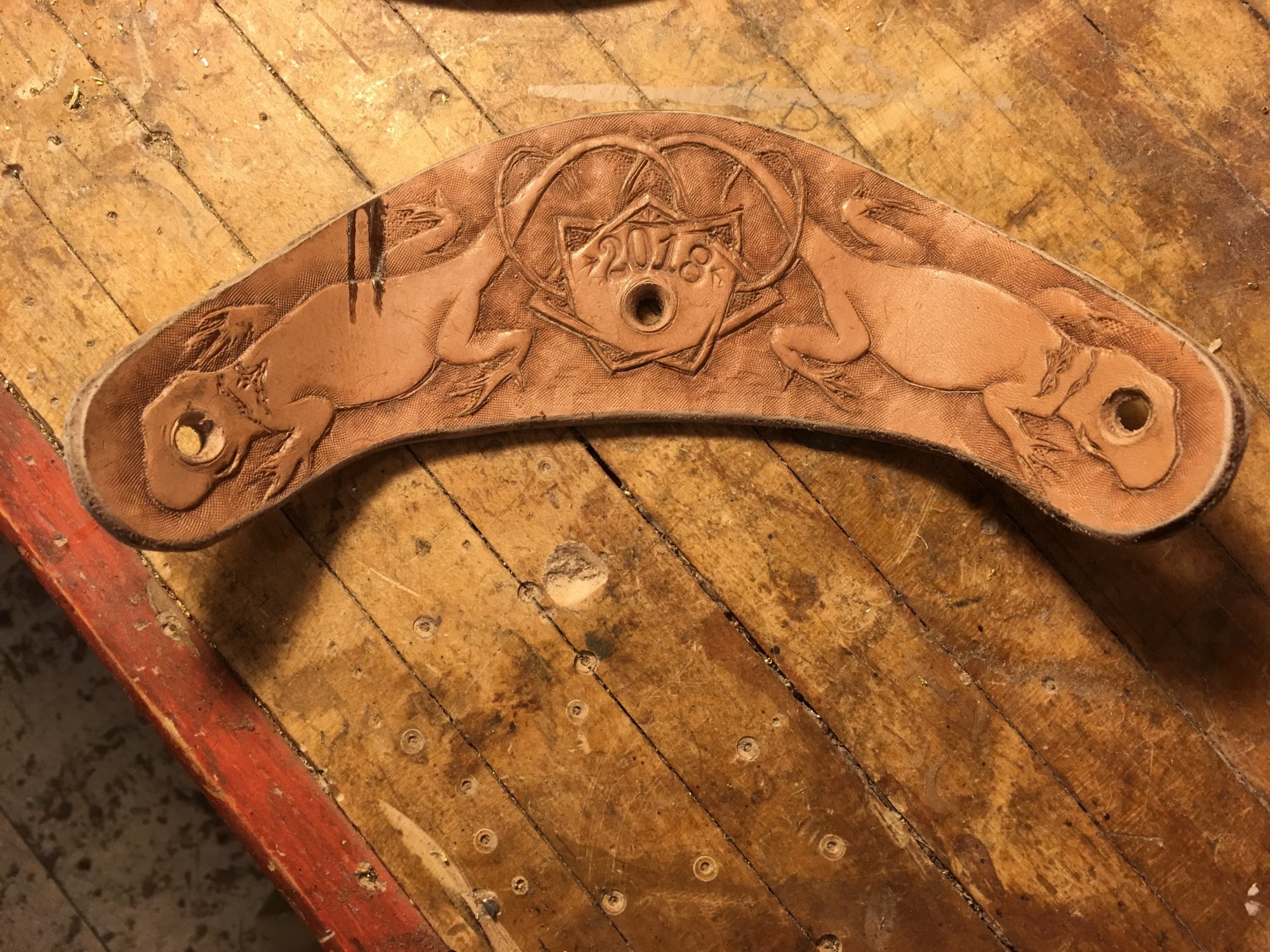

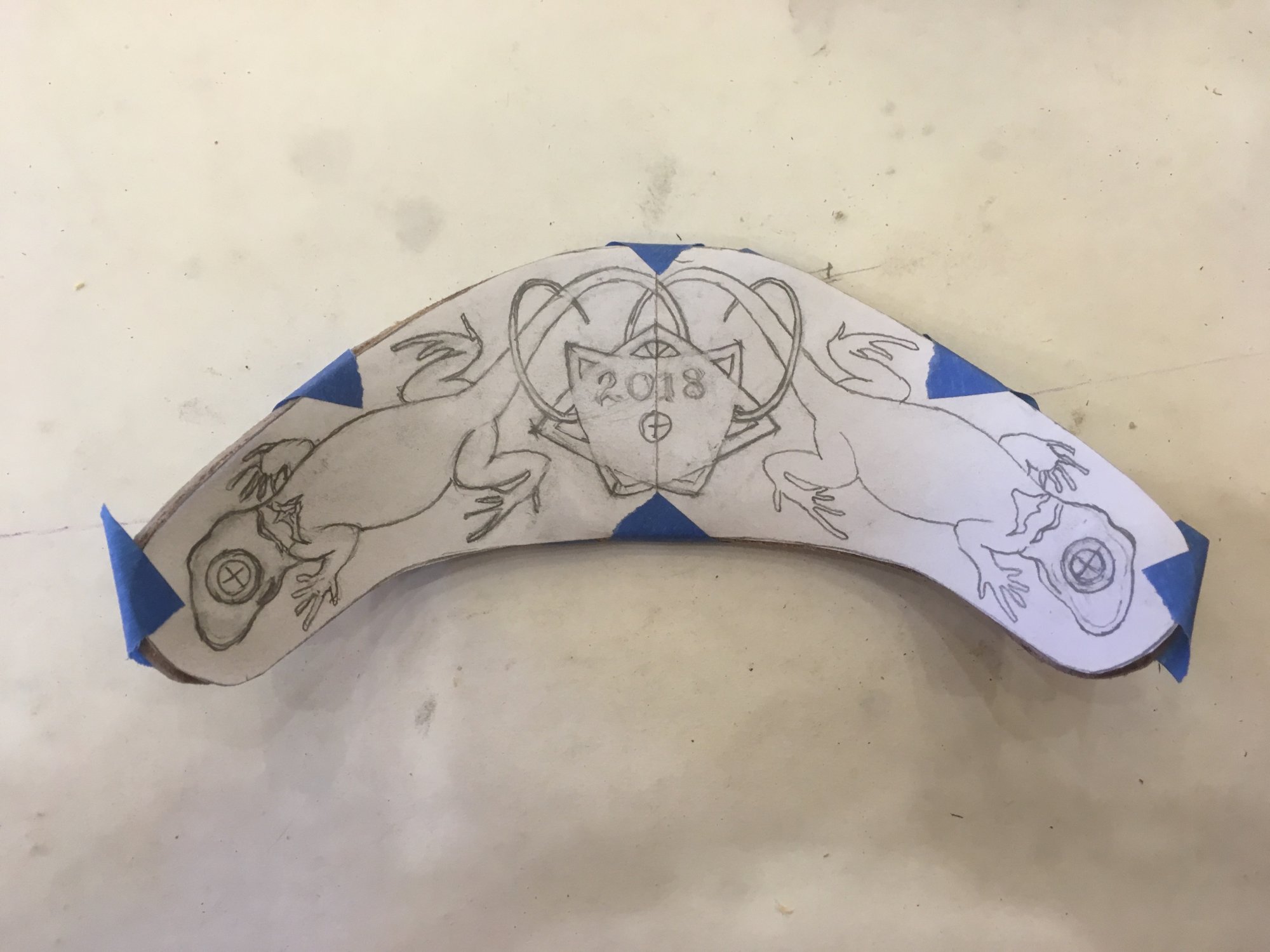

Sailboats are not my only love.
