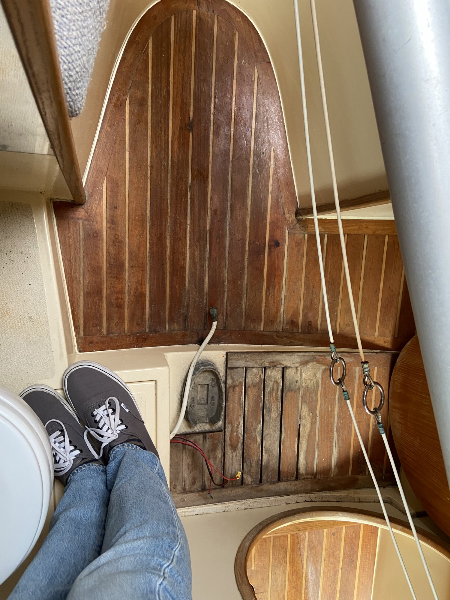

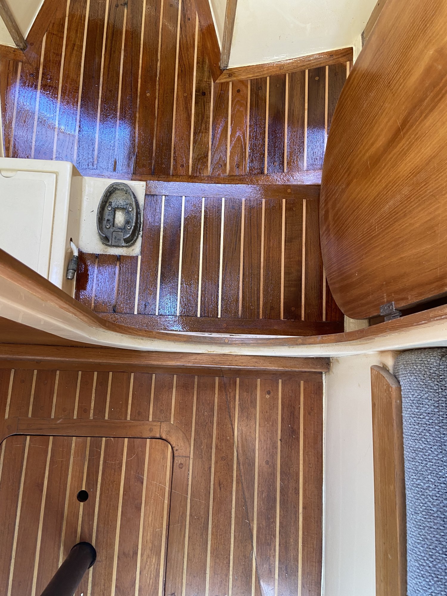

I recently repaired, sanded down, and varnished the sole in my forward cabin. It came out significantly darker than the original. I'm probably going to live with it, but why is it darker than the original?
I've put on 3 coats of 1015 Captain's Varnish. I plan on doing a few more rounds of sanding/varnish and then will assess how slippery it is and if I want to add some kind of traction to the last layer.
Is this a result of the varnish I used?
Or does old teak end up darker once refinished?
Could I have done something to get a better match to the original?
In the photo below the top half is the refinished sole, the bottom half in the original (nearly 40 years old).

It looks really good, now you just need to refinish the rest of the boat to match :)

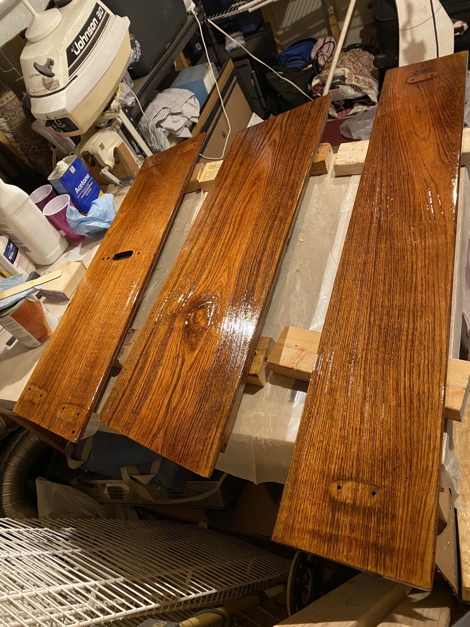

Maybe it's as simple as that, just a different varnish was originally used that wasn't as amber. But the real difference seems to be that even after the first coat my finish looked like wet wood and the original doesn't. Maybe it was polyurethane. The photo above is after the first coat of varnish, and future coats look about the same.
Regardless I agree it looks pretty good. A bit more sanding and another coat and it will be really nice. Just have to refinish the rest of the boat to make it match!
Here's what I started with!
...which now that I look at this photo, maybe it was just darker wood to begin with. Who knows.
