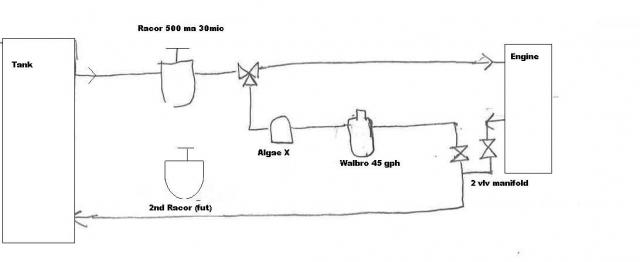

I installed this polisher this spring..I run it whenever the engine is shutdown. After reading the posts I'm a little concerned. Is there anything wrong with this setup? (Algae x, I know, but it sounded like a good idea at the time when I bought it a couple years ago).
RichH
Feb 14, 2005
4,773
If you run the Walbro while the engine is operating the engine will 'starve' from lack of fuel, the Walbro will 'pull fuel' away from the engines fuel supply.
Attached is a 'little bit different... and BOTH filter systems can be operated 'simultaneously'.
Also note that the "racor" is a 10µM to protect the engine flow ... the most 'damaging' particle for a diesel is ~20µM. The engine 'guard' is a teeny/small filter applied ON the engine and is there only if the Racor, etc. breaks a pleat etc. and 'unloads' its debris to the engine.
A 30µM fuel filter can theoretically easily pass 100µM particles
A 10µM fuel filter ... only captures 95-97%(wt) of particles at 10µM .... has an 'absolute' rating approaching 30+µM ... meaning there is a very small possibility that you will pass even 30µM particles with a 10µM typical fuel filter.

Thanks Rich. I was concerned that a 10 micron could possibly starve the engine but it would make sense that the fuel passes through the 10 Micron on the engine so there shouldn't be anymore restriction from the Racor 10 Micron.
