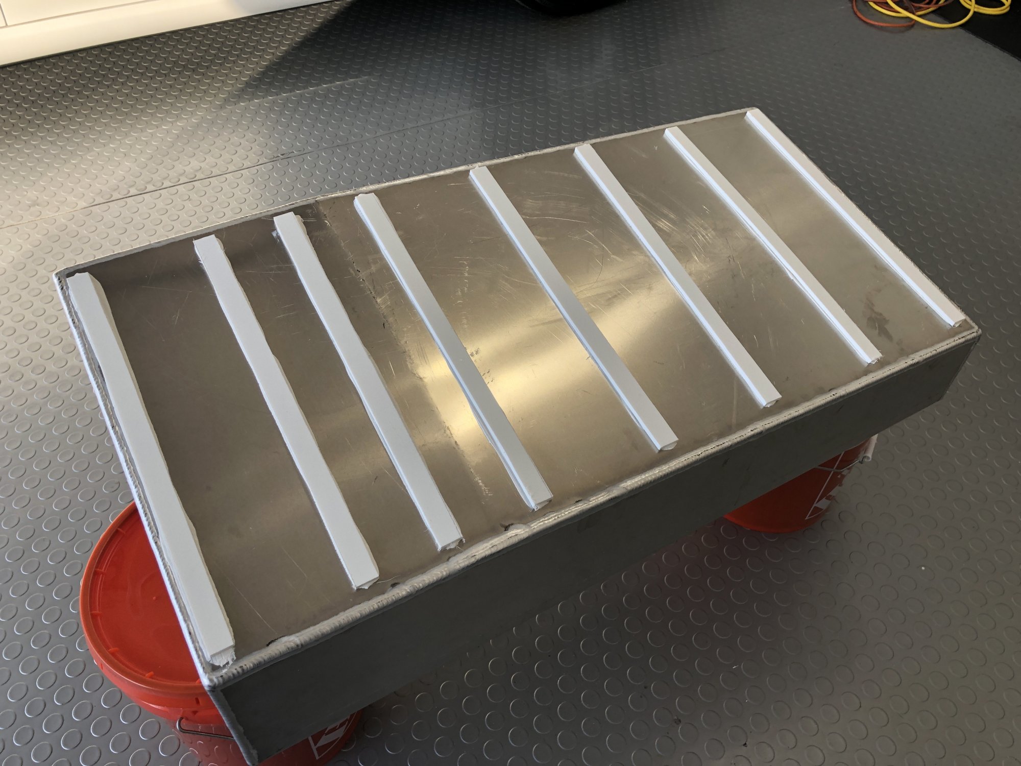

I did the same thing with our tank.. cut strips of starboard 1/4" tall.

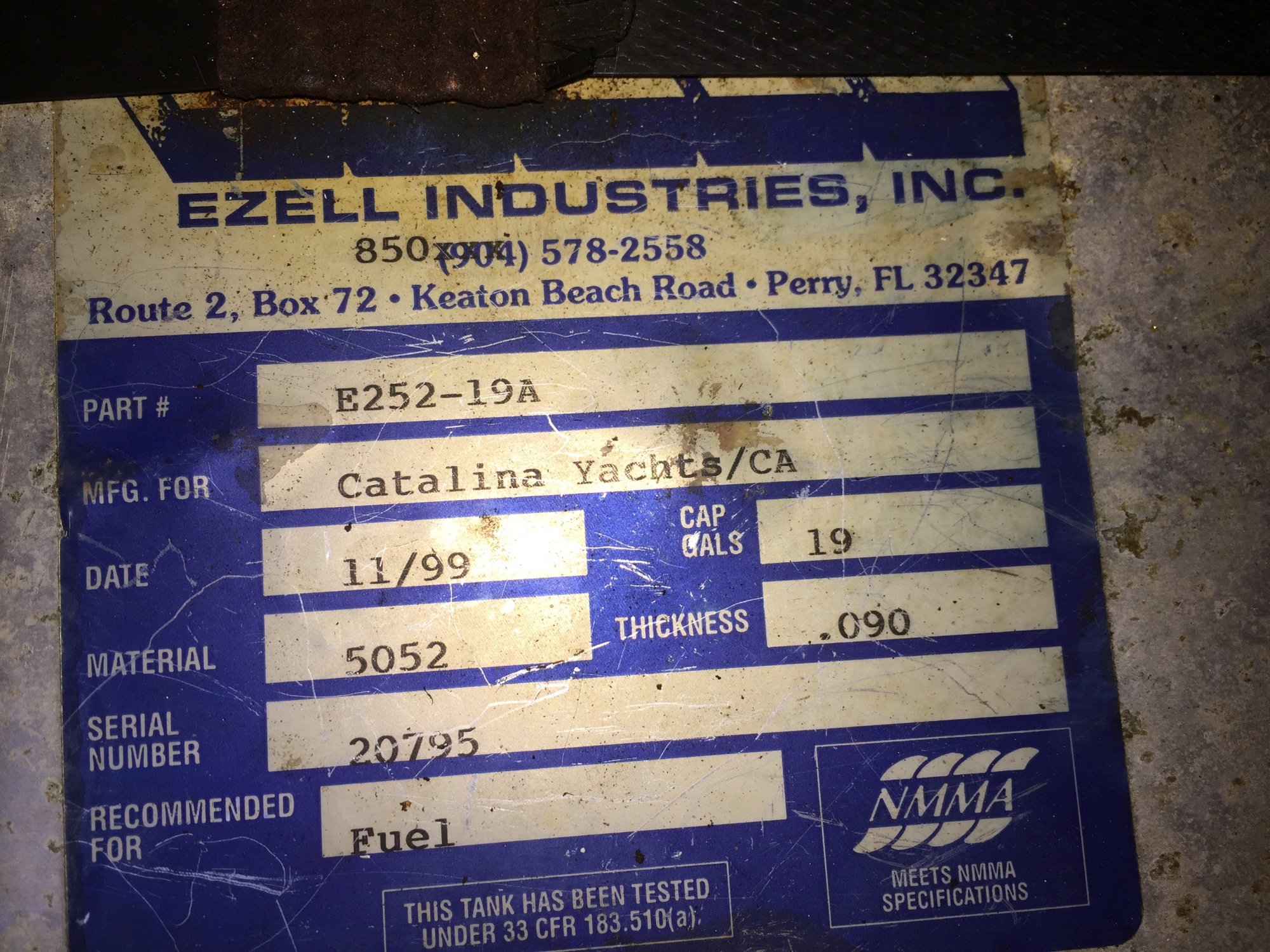

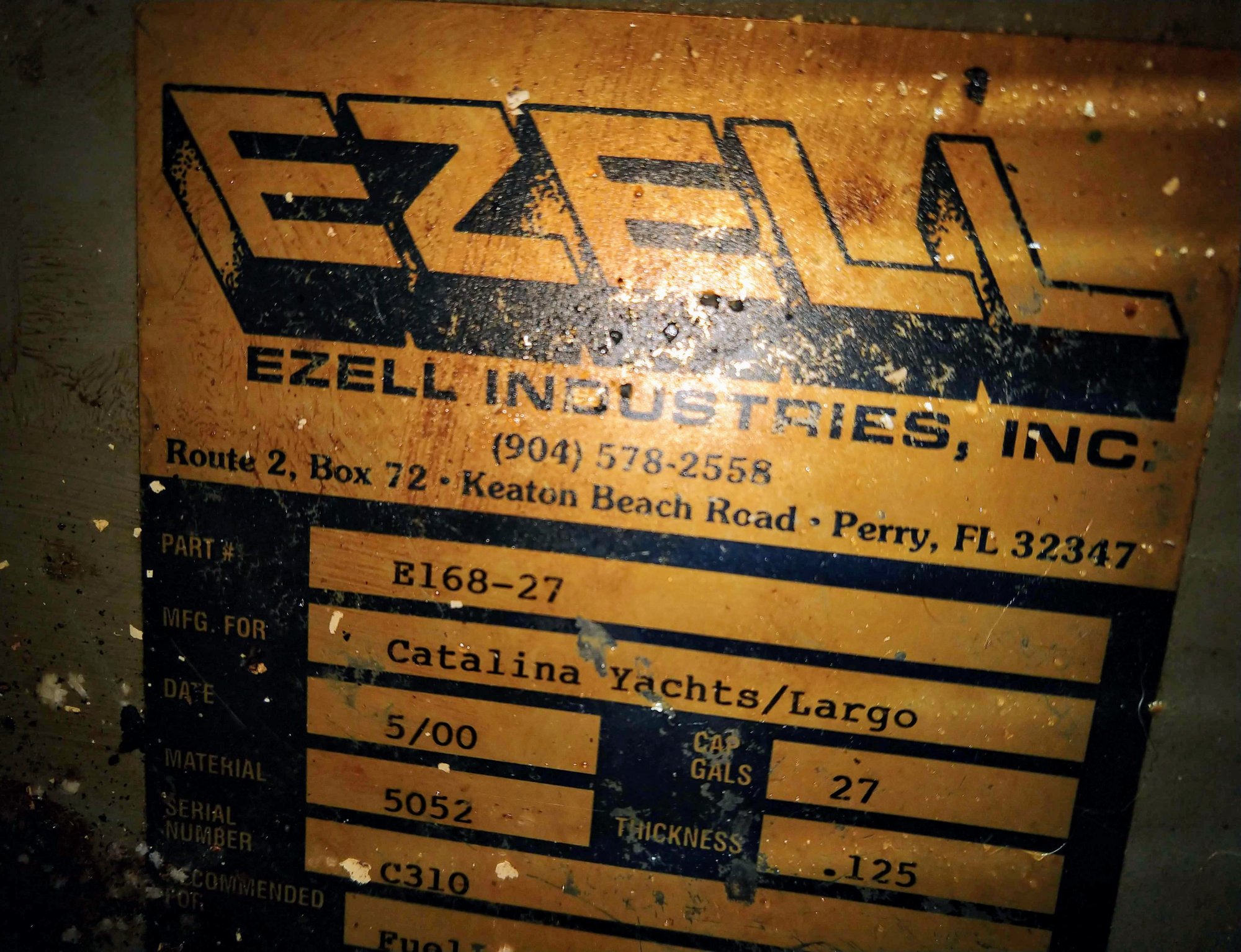

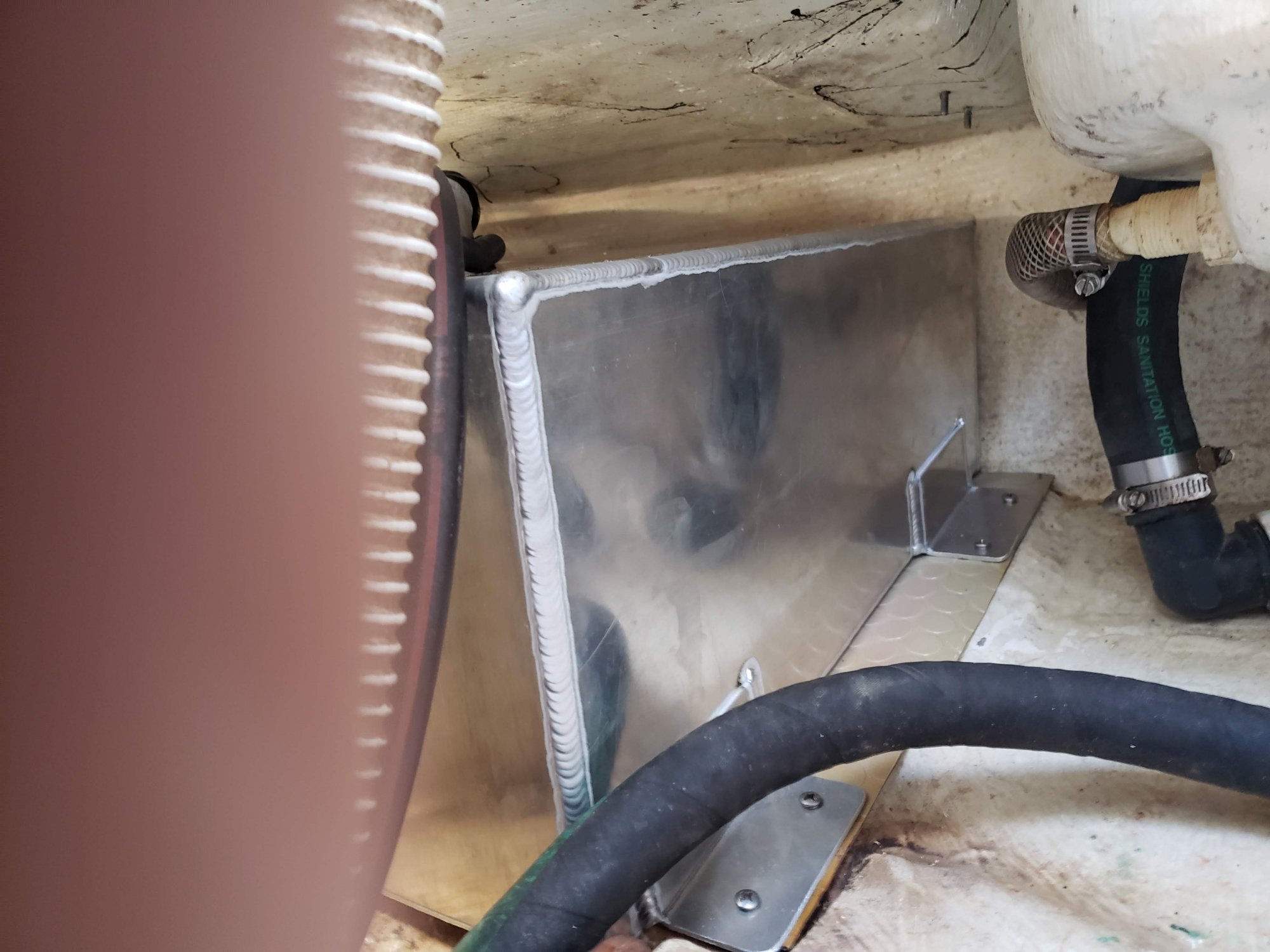

Exciting day today removing the fuel tank and water heater. Water heater was not a big problem but the fuel tank was a little tricky. I knew from this forum that it would be necessary to remove the propane locker but my locker was impossible to remove. Factory must have used an entire tube of silicone to seat it because removing it would just break it. So the guys I hired and was working with de ccx ided to cut the bottom off and will reattach it and fiberglass it back into place. Pictures attached. Also learned that the fuel tank was made by Skyline Industries in Nov 1989 and was only 17 gallons! So much for boat specifications! Hope to get 20 gals from the new tank when it is fabricated.View attachment 178322View attachment 178323View attachment 178324
bob
19 gallon tank in hull #31. 27 gallons in Jessie's 310. Lots of changes during the production run, that's for sure!
To tell you the truth, as little motoring as we do 19 gallons is more than plenty.

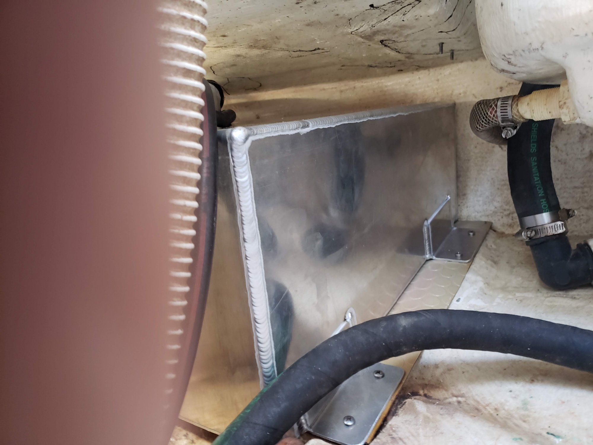

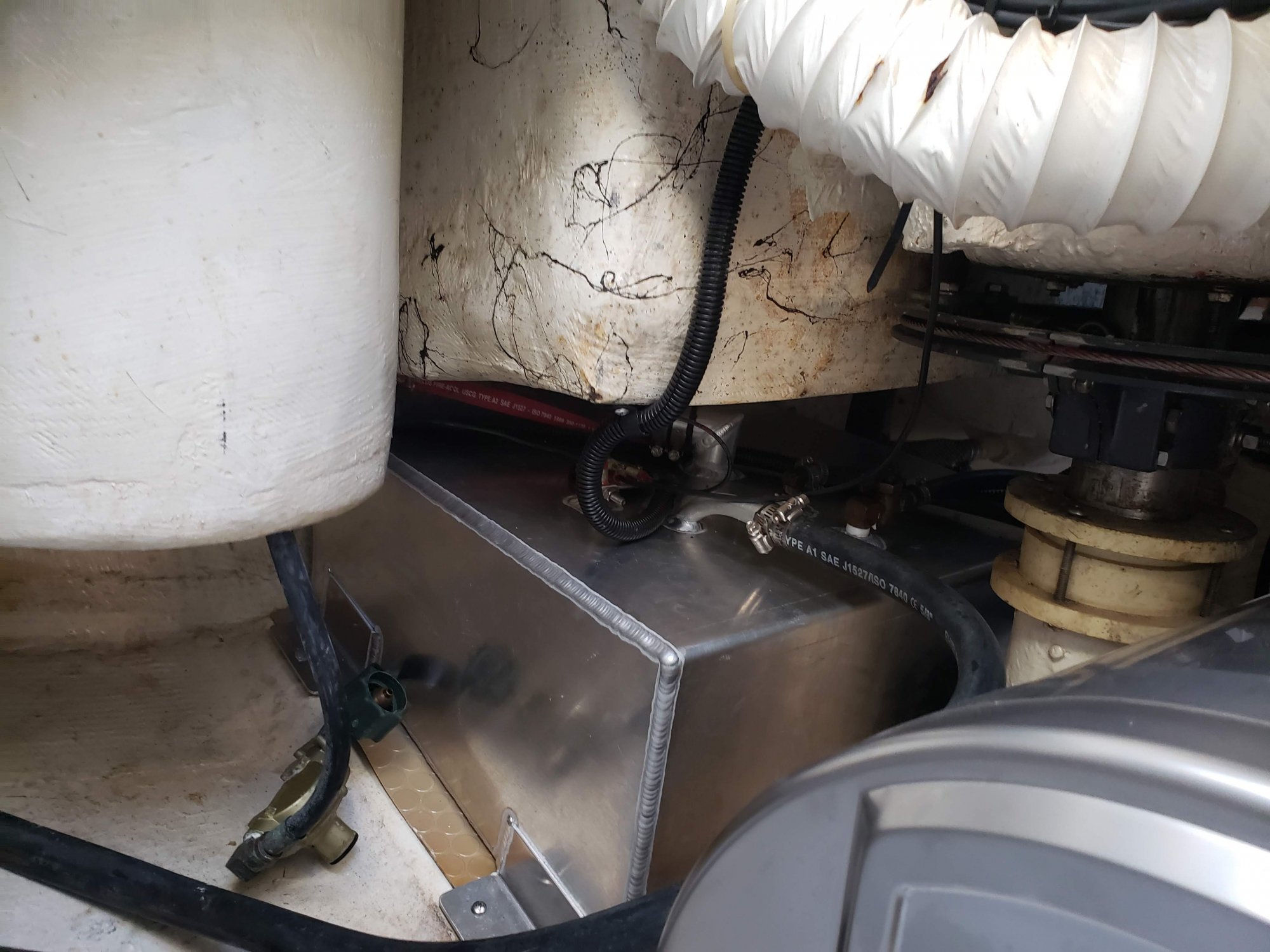

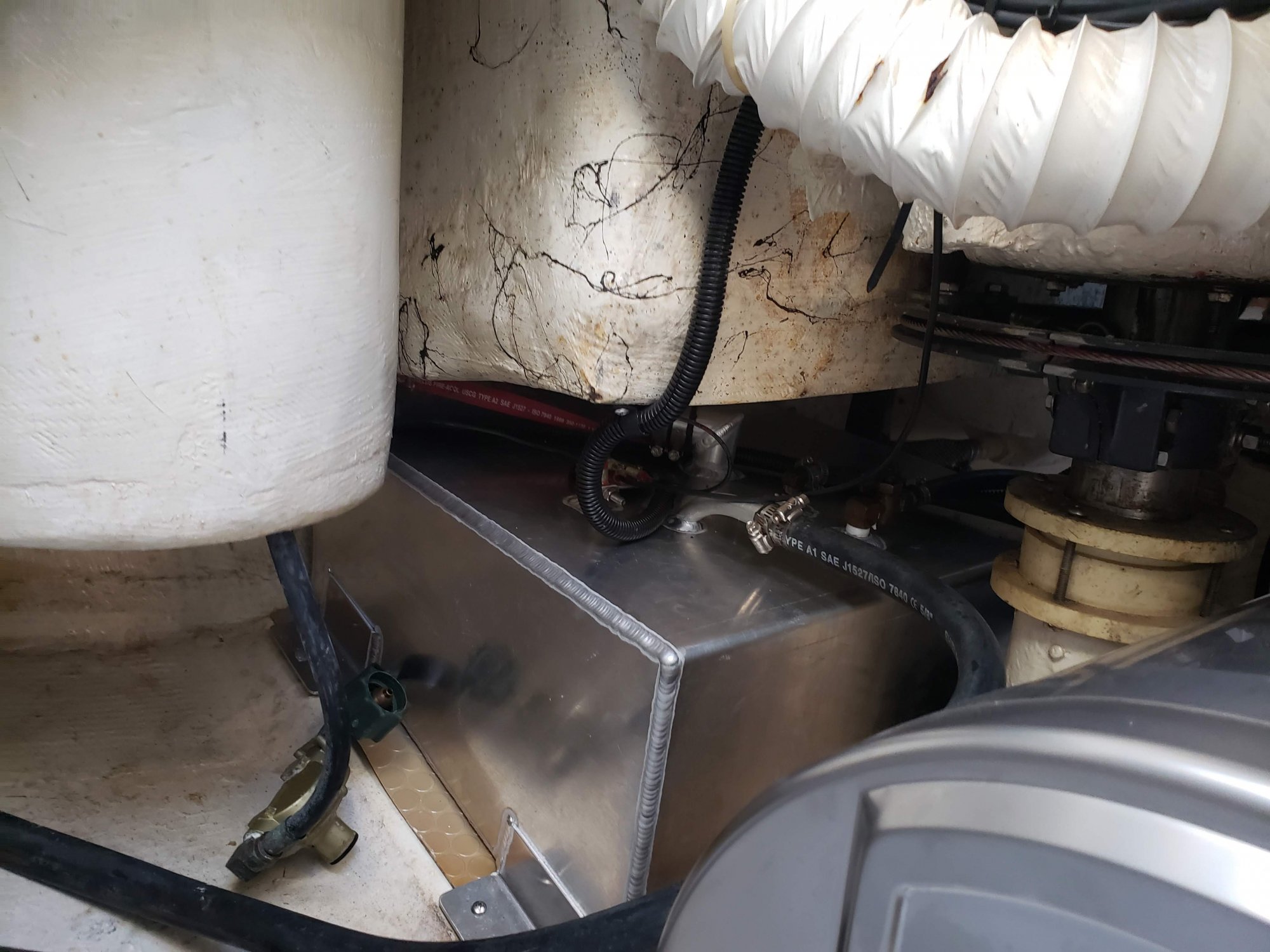

New fuel tank and water heater project now complete. Here's my shiny new fuel tank. Appears to be about the same size as the original @ 16-17 gallons. 20200617_083029.jpg20200617_082959.jpg

Doesnt it feel good to be done with that? i know i was walking with a little more of a skip in my step after that..
