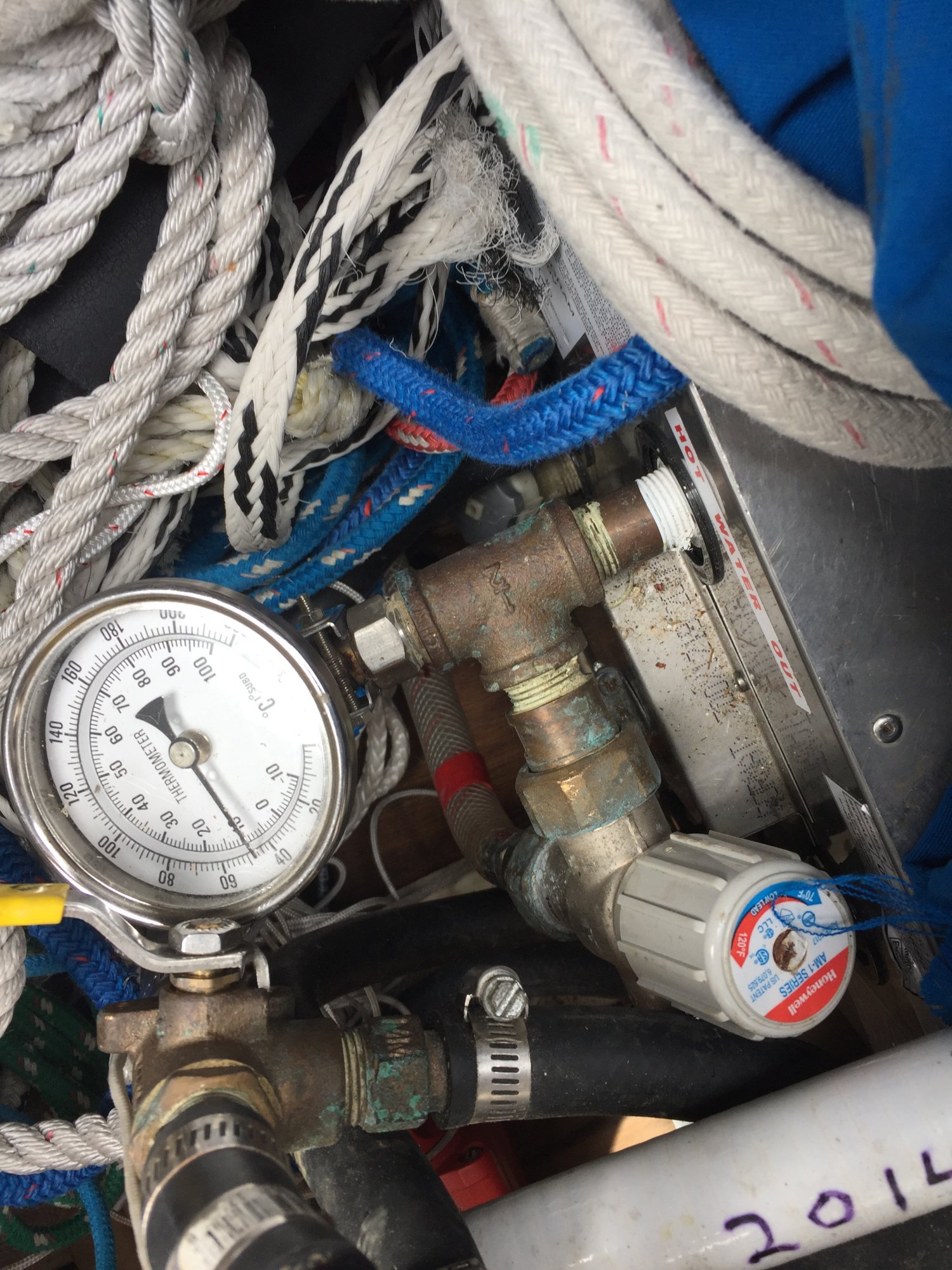

Be sure to put a mixing valve on your water heater. Two people can shower out of a six gallon water heater with a mixing valve 12 hours after motoring. Another nice feature is to purchase a stainless deep probe thermometer from a brewers supply and install it on a T fitting on your tank. You can tell at a glance if the water is hot enough for showering.

Here is a photo of the thermometer for your water heater. Deep probe passes through T into hot water.

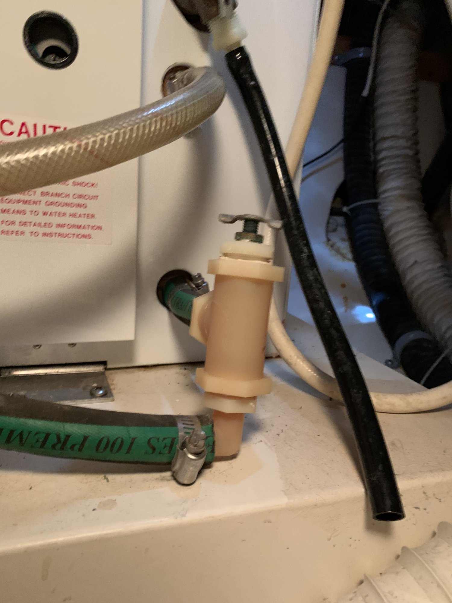

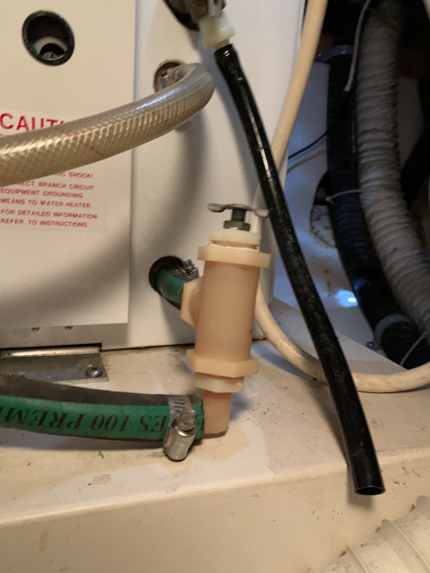

Wanted to build on this thread for an issue I’m having with our water heater, notably the residual smell of marine anti freeze. I do a 2-3x flush of the system when I launch in the spring, but it the smell coloring seems to linger. In looking at the system the only thing of concern is this connector and the discoloring. My system is a Seaward F-1100-W. Any thoughts would be appreciated.
Nov 18, 2010
2,441
Catalina 310 Hingham, MA
Wanted to build on this thread for an issue I’m having with our water heater, notably the residual smell of marine anti freeze. I do a 2-3x flush of the system when I launch in the spring, but it the smell coloring seems to linger. In looking at the system the only thing of concern is this connector and the discoloring. My system is a Seaward F-1100-W. Any thoughts would be appreciated. View attachment 178186
Don't put antifreeze in the water heater or tanks. Drain them and put antifreeze in the hoses. Buy the bypass kit and the pump winterization kit. Makes your life easier.
Otherwise keep flushing.

Or drain everything and do not add antifreeze anywhere. I simply drain, discard filters, and remove the mixing valve from the water heater. I have not put antifreeze in my fresh water system for decades. In the spring I install the mixing vlave, shock treat overnight with 1-1/2 cups of bleach, flush everything and install filters. Works for me.

We put a bypass on the water heater, plus we use very cheap rum to winterize instead of the pink stuff. Usually two 1.75liter bottles do the trick. The water system gets pickled all winter long.

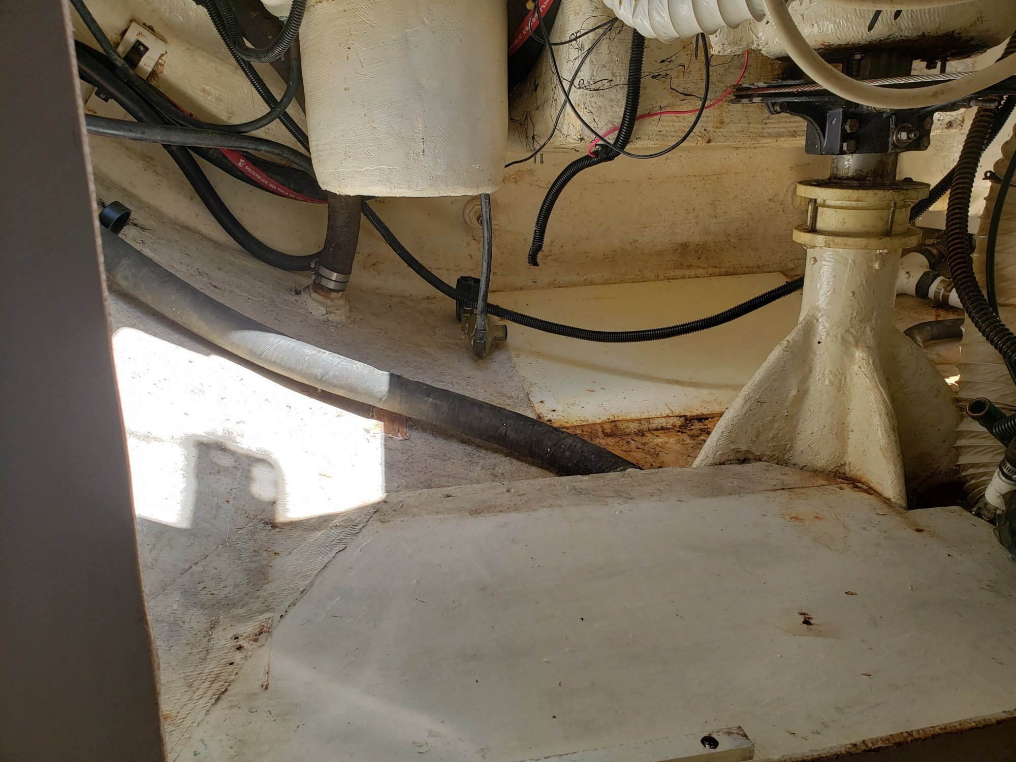

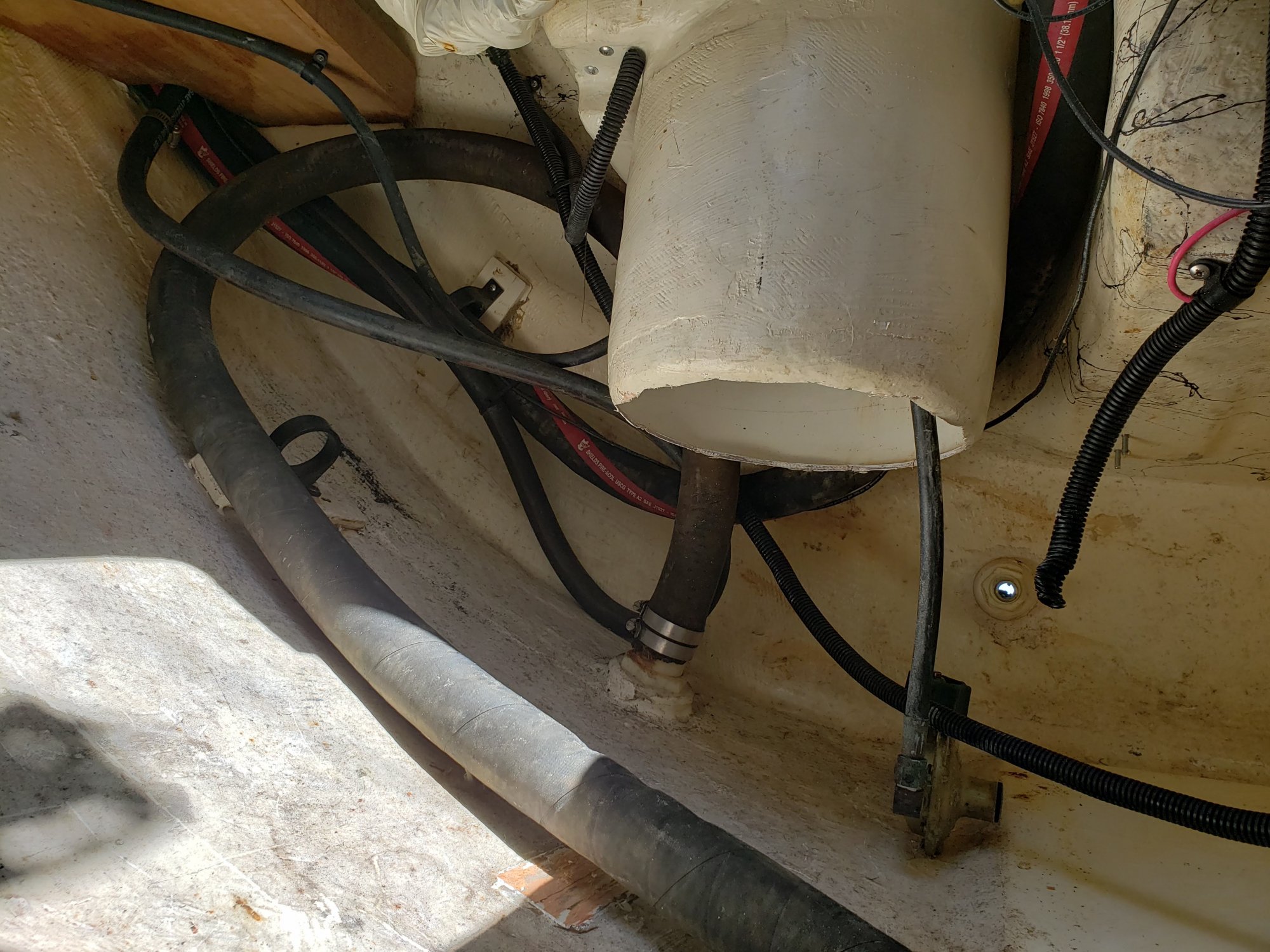

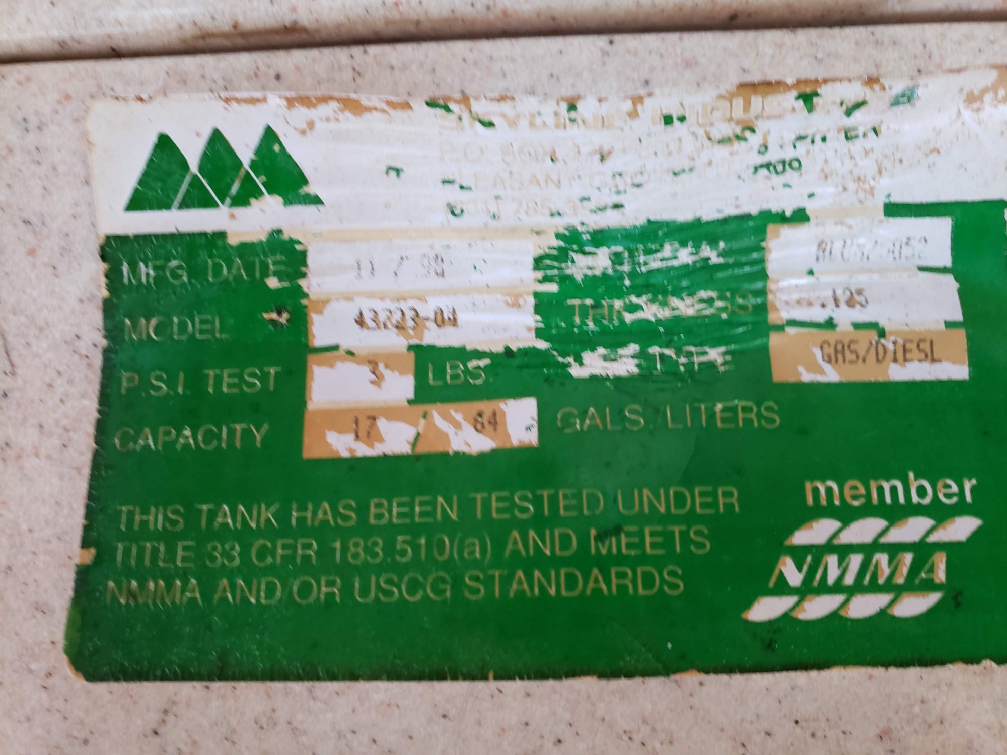

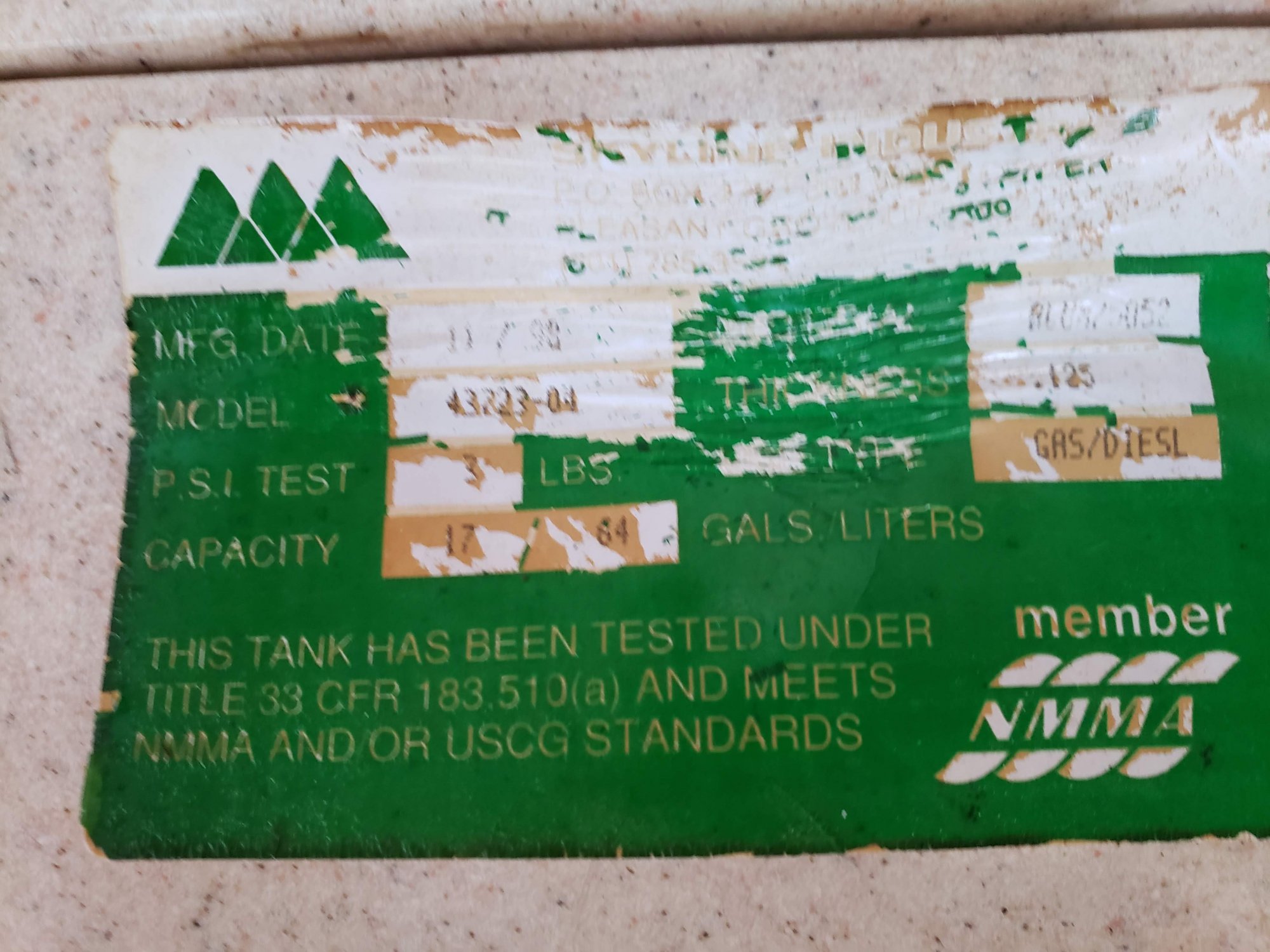

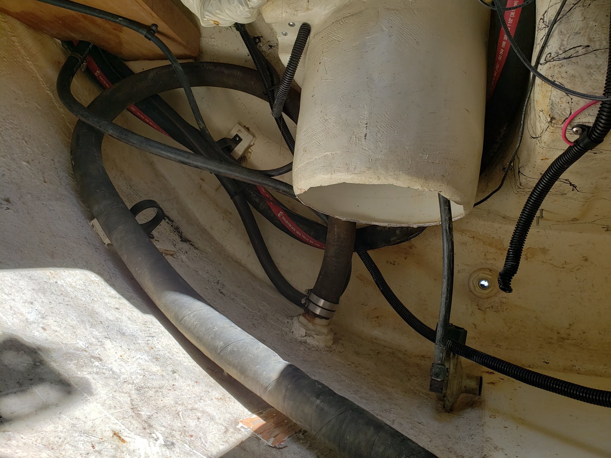

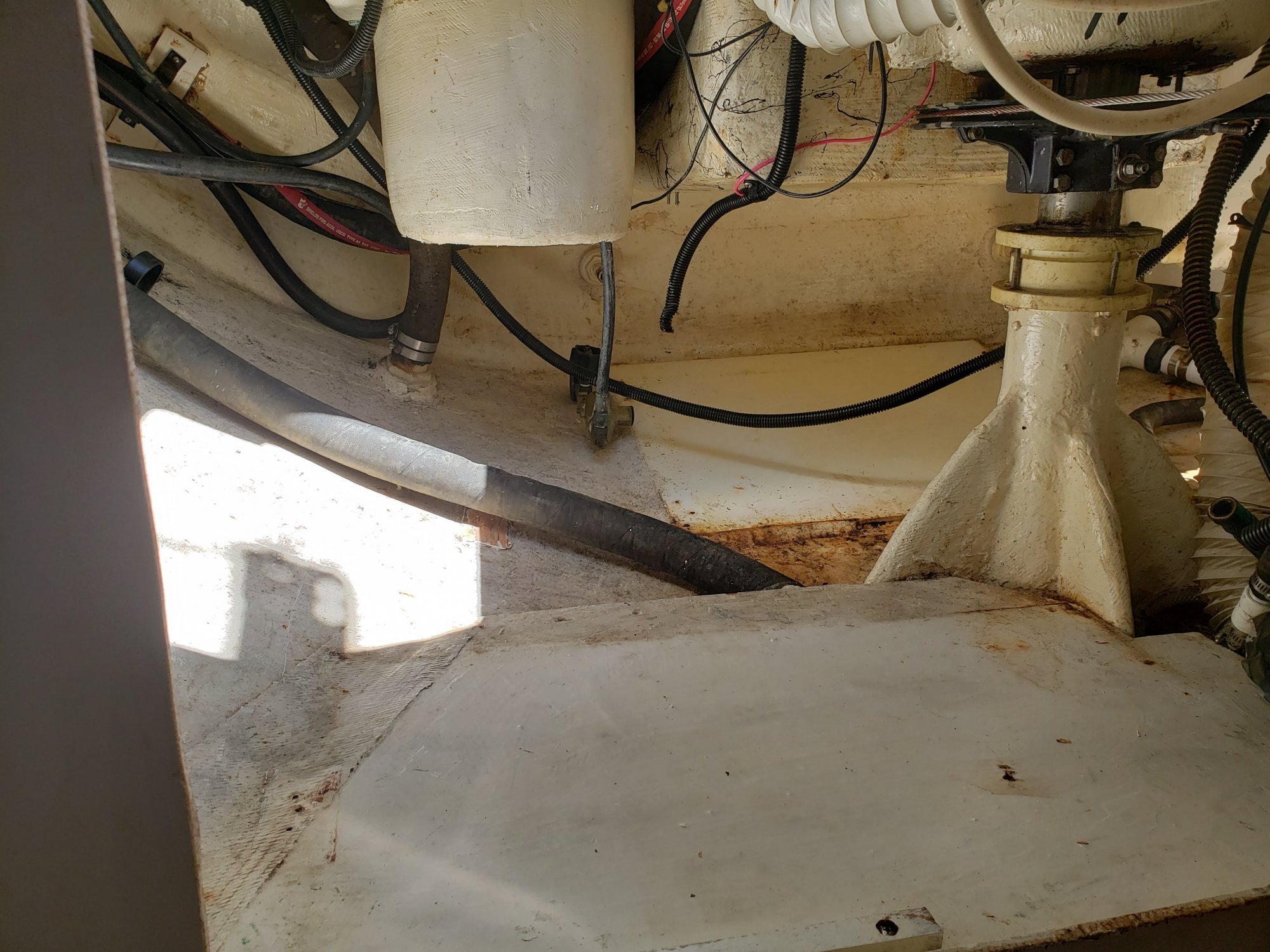

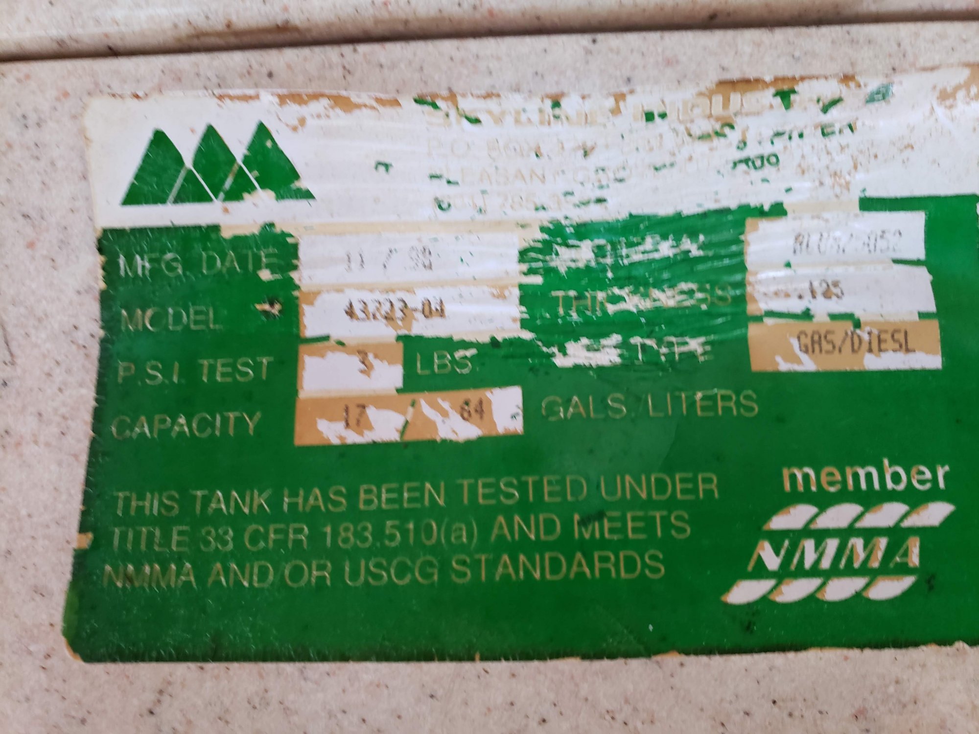

Exciting day today removing the fuel tank and water heater. Water heater was not a big problem but the fuel tank was a little tricky. I knew from this forum that it would be necessary to remove the propane locker but my locker was impossible to remove. Factory must have used an entire tube of silicone to seat it because removing it would just break it. So the guys I hired and was working with de ccx ided to cut the bottom off and will reattach it and fiberglass it back into place. Pictures attached. Also learned that the fuel tank was made by Skyline Industries in Nov 1989 and was only 17 gallons! So much for boat specifications! Hope to get 20 gals from the new tank when it is fabricated.20200429_135038.jpg20200429_135047.jpg20200429_114213.jpg

Exciting day today removing the fuel tank and water heater. Water heater was not a big problem but the fuel tank was a little tricky. I knew from this forum that it would be necessary to remove the propane locker but my locker was impossible to remove. Factory must have used an entire tube of silicone to seat it because removing it would just break it. So the guys I hired and was working with de ccx ided to cut the bottom off and will reattach it and fiberglass it back into place. Pictures attached. Also learned that the fuel tank was made by Skyline Industries in Nov 1989 and was only 17 gallons! So much for boat specifications! Hope to get 20 gals from the new tank when it is fabricated.View attachment 178322View attachment 178323View attachment 178324
bob

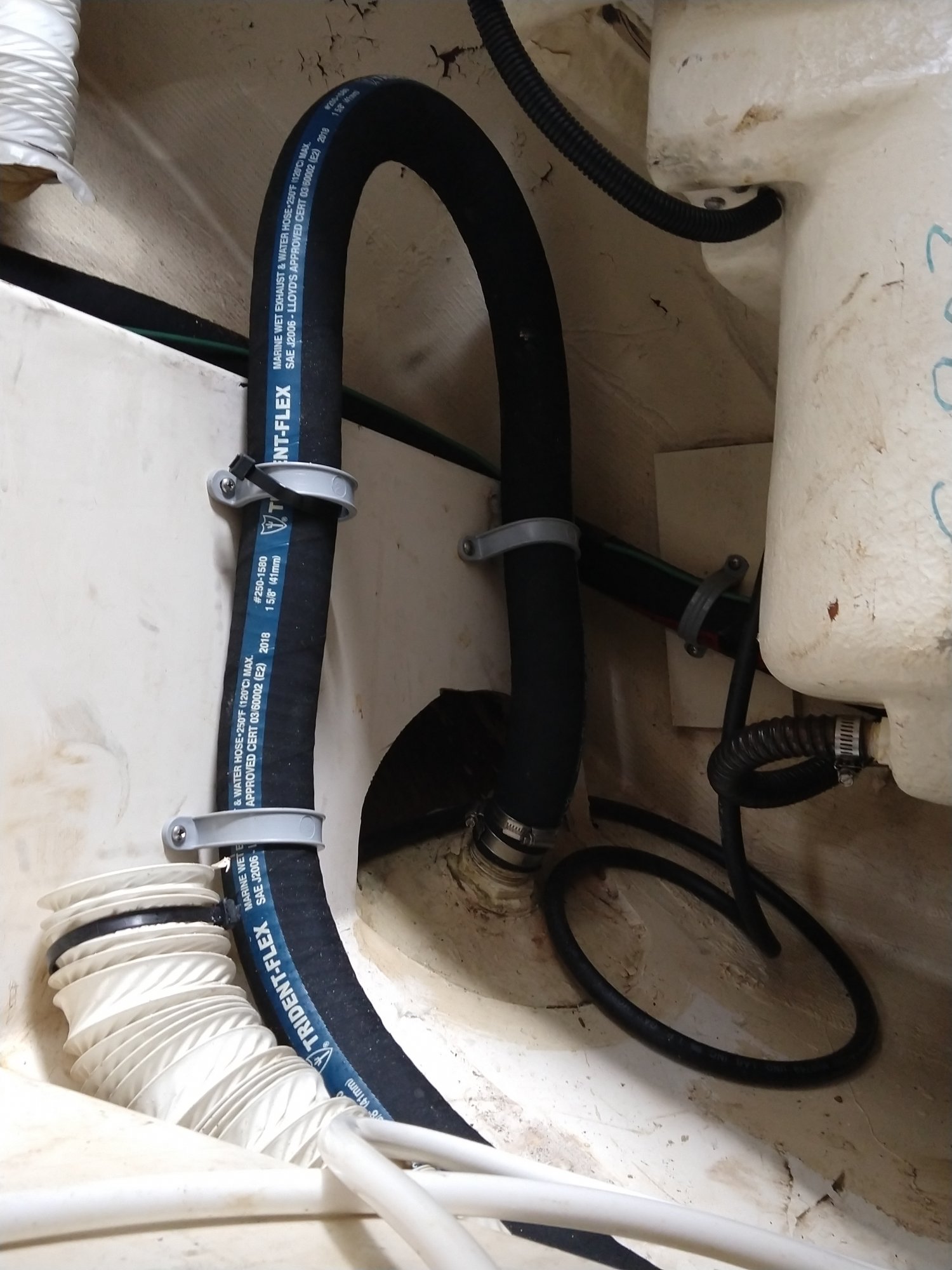

Replace that exhaust hose while you can and secure it better with a higher hump.
