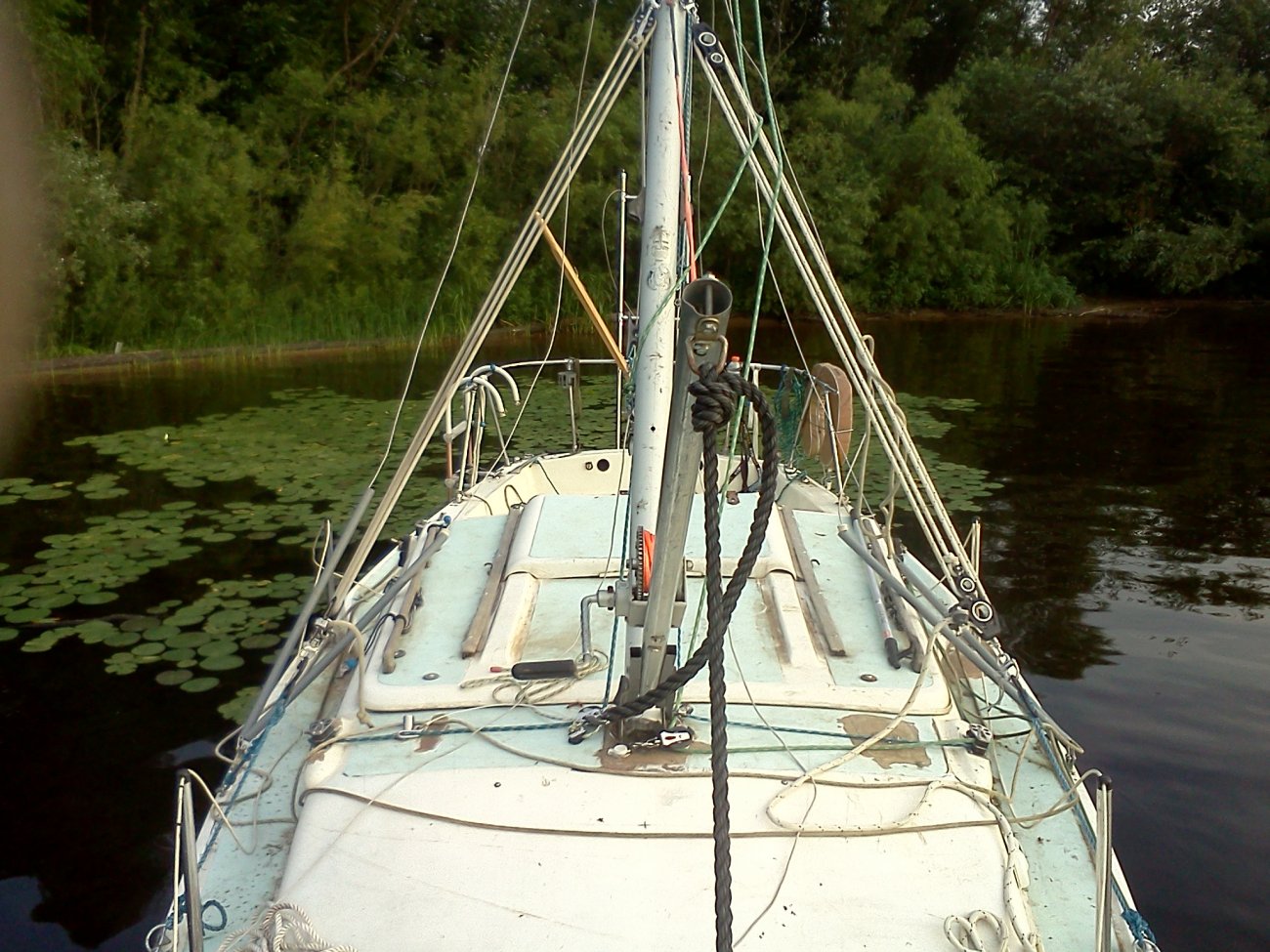

The main sheet and back stay tackle make excellent adjustable baby stays. Here it is half up. Just sayin...
23,807
Topcat. You are addressing the issue I suggest as needed. You have a couple of significant blocks and tackle to maintain balance. Should one of those blocks blow out it will become a challenge...

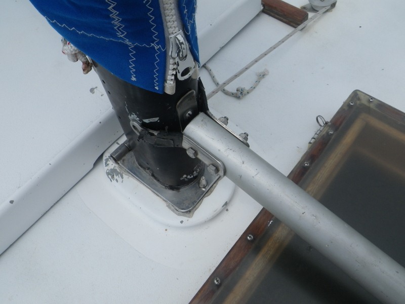

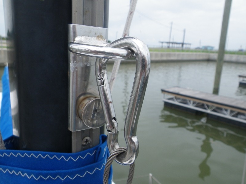

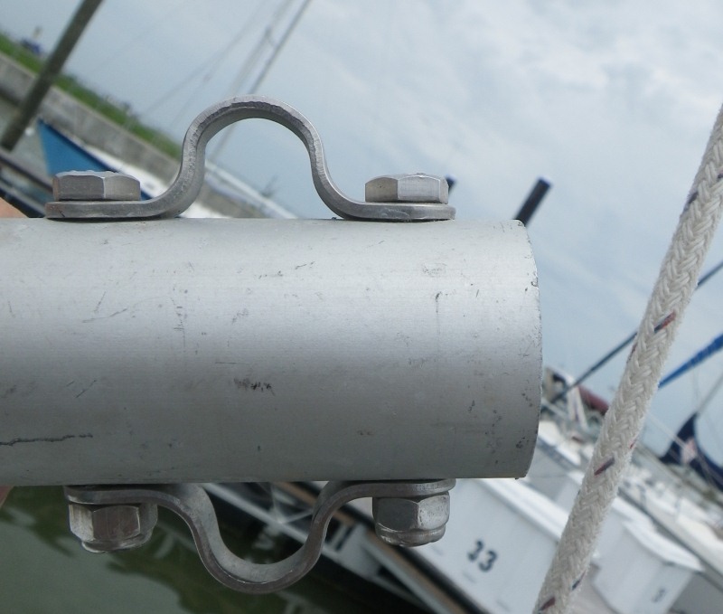

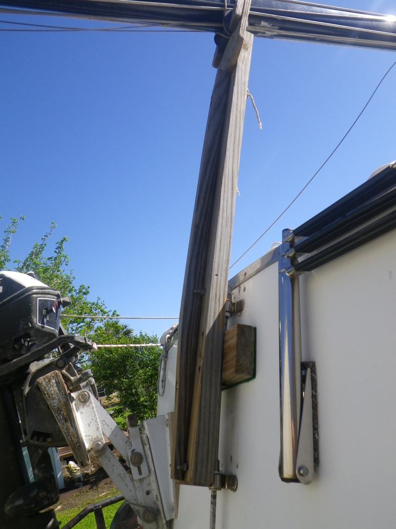

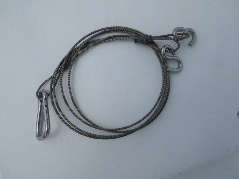

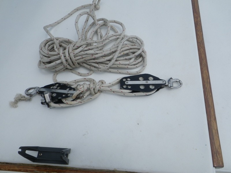

First- Hi Tim- welcome back home. Here's pictures of the rig I use
The gin pole
Mast end- fork that straddles mast and has a bolt thru it
The outer end- Jib halyard hooks to upper fitting, 4 part tackle to lower
Baby stays
Mast attachment
deck attachment
And the hoisting tackle- this attaches to fore deck cleat, and the fall can be led back to the cockpit. It has a cam cleat
so can be stopped at any point
and the mast crutch it lands in. It has a roller so the mast can be easily rolled into place
This iis all on the 21 footer. The 25 is much more difficult, and takes at least three to do it safely
