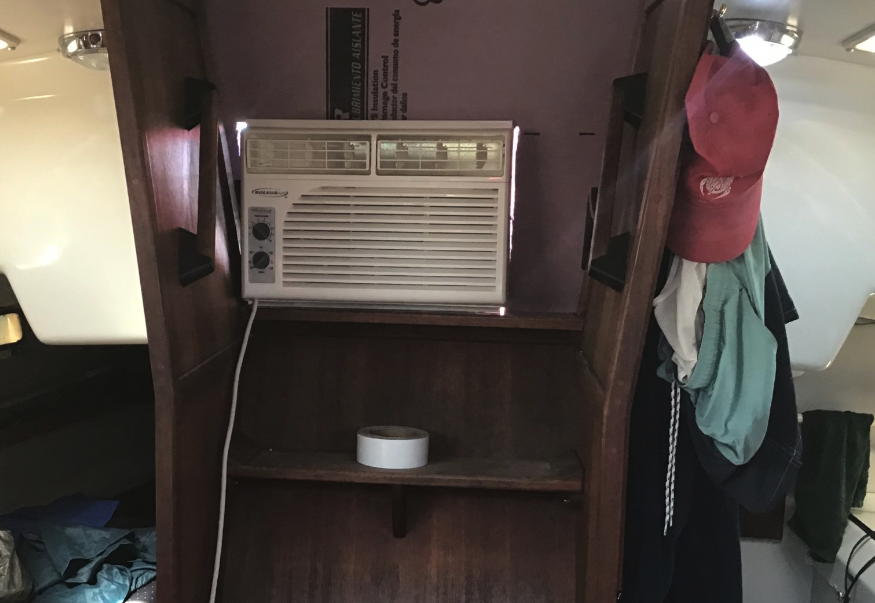

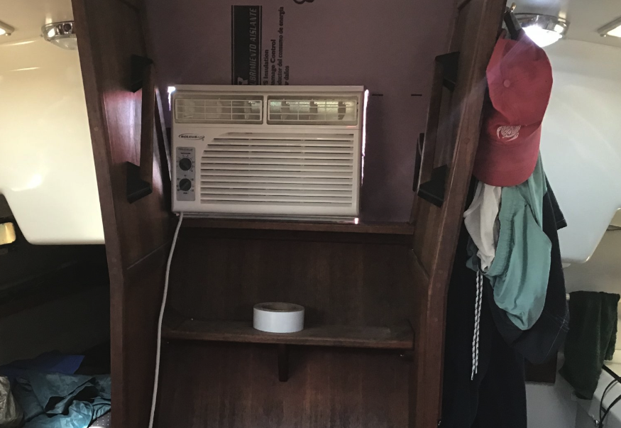

I believe my earlier initial response showed a photo of the unit installed..
Yes you did... sorry mate. I was making a reference to the series of installation photos that you had eluded to. It was supposed to be a cleaver way of saying that I'd love to see them. But it got lost in translation... (my crazy brain to english).
