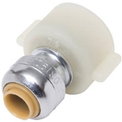

Got lots of PEX to run. I'm so enamored with the way the Sharkbite faucet connectors work, I'm going to put then on the head's faucet, too, and run fresh PEX between that and the galley. I'm swapping out the fresh water pump for a Flojet that I'm hoping will be quieter and less tempermental than the two Shurflos I've had, but I'm probably dreaming there. So, still tons to do before the cabin's back together enough to actually go sailing.

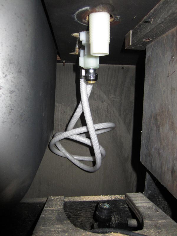

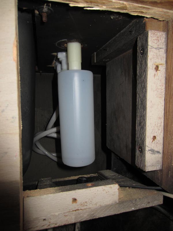

Got the hole cut for the faucet. I'll upload a few pics of it - not yet connected or fastened down - and the area behind the sink with the faucet hose and soap bottle. I need to work on that hose so it will dispense easily.
I like the Whale faucet mainly because it's attached from above, so it's easy (if you leave yourself enough tubing length) to pull it up and get at connections without having to turn turtle under the sink. I've got the same one in the head, so any spares I might decide to keep on hand will work with either.
