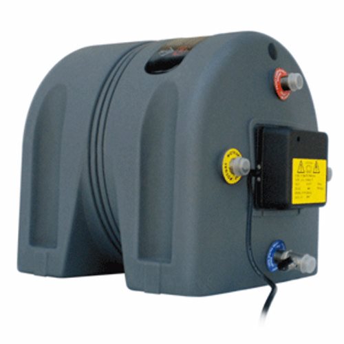

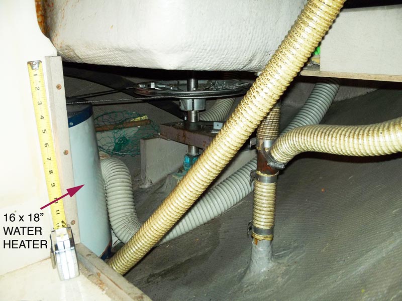

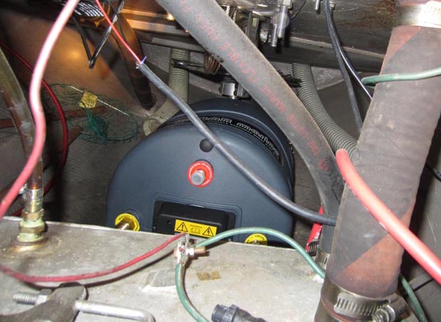

I ran a bunch more fresh water through the block to thoroughly flush it before putting in the new Havoline ELC. I do need to turn the thermostat on that new water heater down. I nearly scalded myself!
