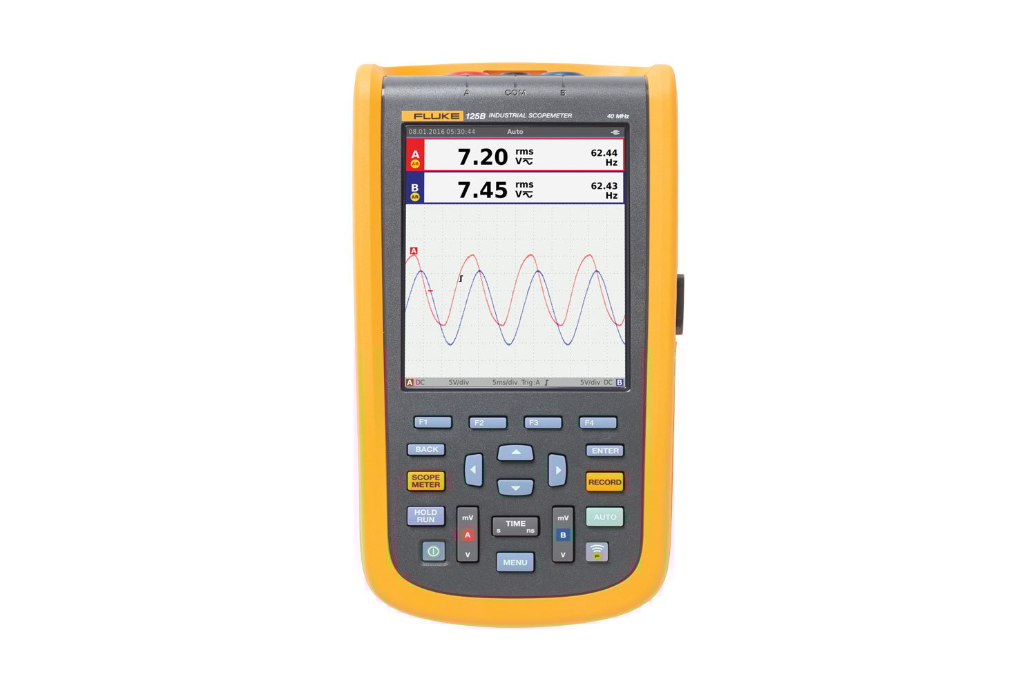

I've been wishing to have the $'s to buy a fluke 120B handheld oscilloscope... Talk about perfect for having on a boat... At least seems to me... I don't know anything about the Rigol you mention but I do see it runs on house current. The Fluke runs on batteries. Makes for a nice portable unit...
But chump change it is not...
dj
it is made by fluke. :biggrin:
For simple diagnostic work some Chinese ones work well. A tech I know has a 3 channel unit for automotive diag.
