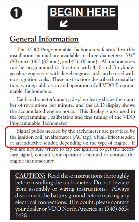

Made me wonder.. are there any diesels that use an oem hall effect sensor for a tach ?
Obviously you can buy one aftermarket.
The VDO Vision Series 333-163 ( which I used as a replacement for the original Yanmar tach) can use anything and everything including your pacemaker and TV remote to generate a signal to their tach :
14,278
If you are directing this question to me, no, not a Yanmar, but a Westerbeke based on a Mitsubishi diesel. It's the Westerbeke 38B-FOUR.
Yes it was to you. You can ignore my comment as it is relevant to Yanmar diesels not Westerbeasts.
