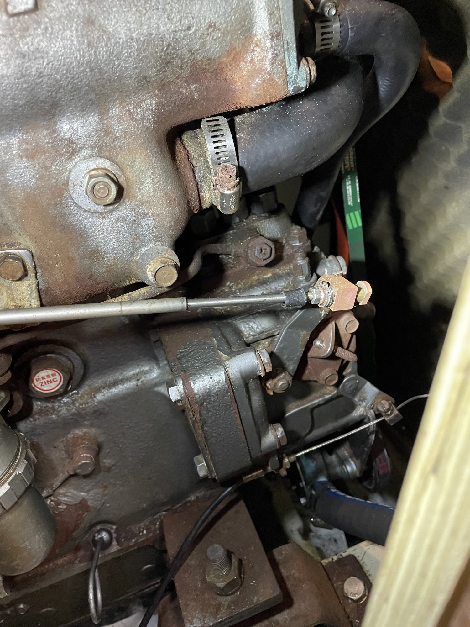

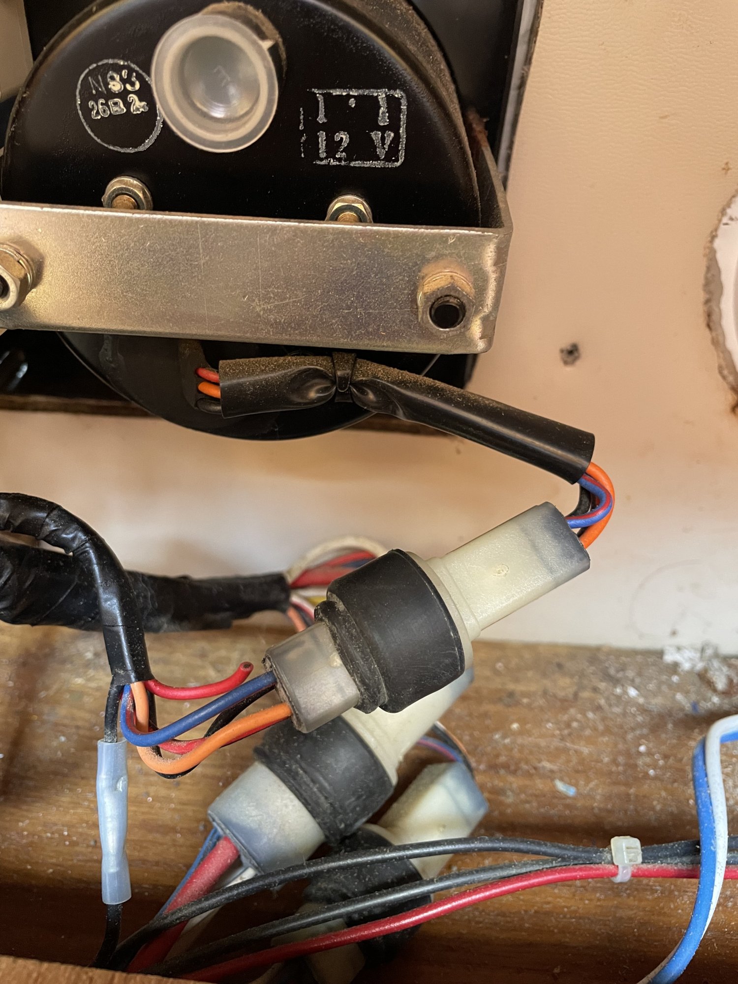

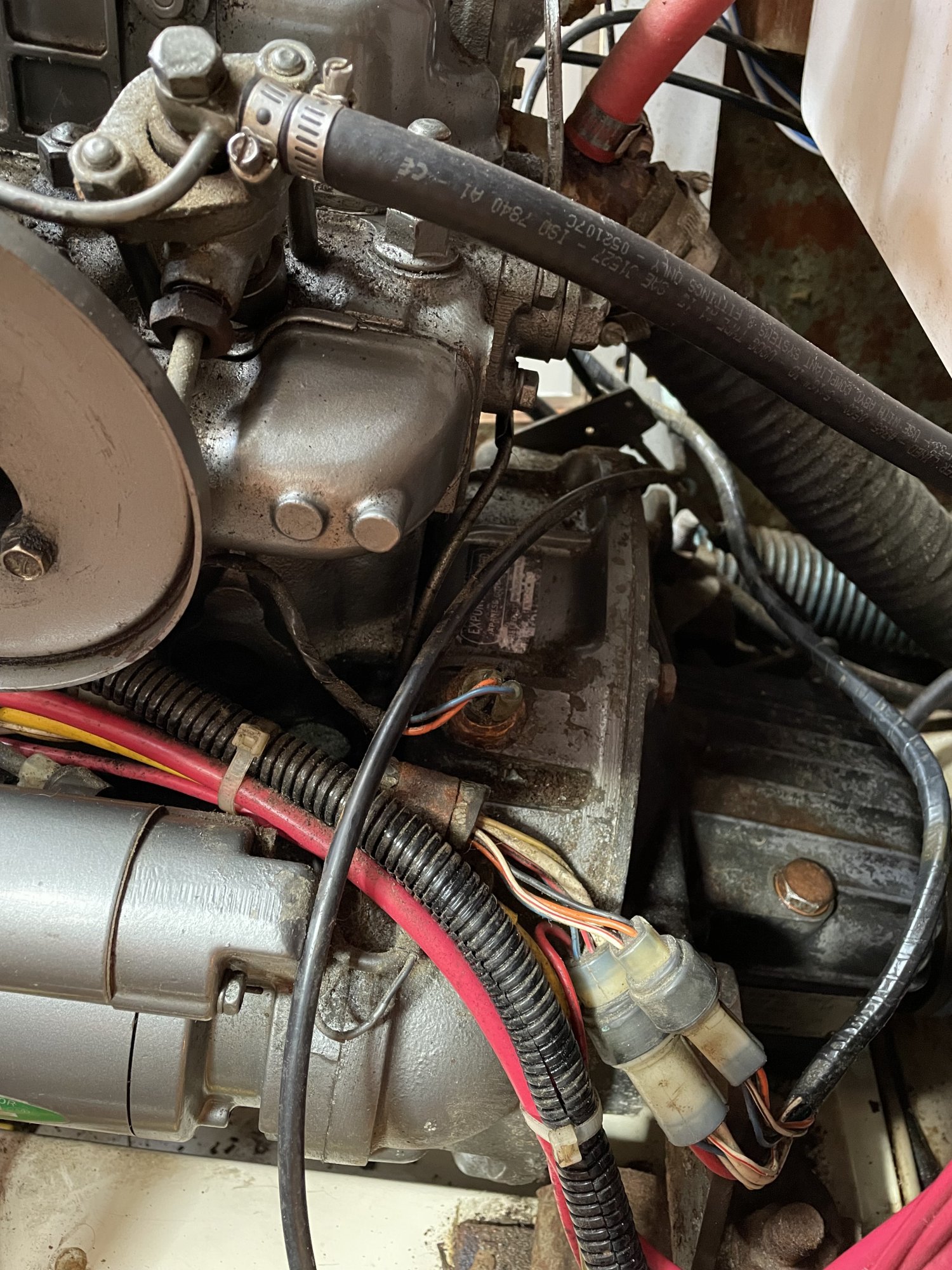

Any tips or advice would be great. 3 photos attached:
1) The sensor at flywheel
2) Back of the tachometer
3) Throttle and stop (Governor?) when the engine is not running.

The pin and socket quick connectors are the usual suspects. The one you have pictured with the wires from the flywheel pickup is prime, but there is usually another one behind the Yanmar instrument panel . The soc,it's can be cleaned with a very small wire bottle brush or a small rolled up piece of fine (180_220 grit) sandpaper.
14,278
The wiring is the prime suspect. However, the sensors do fail. The service manual should have the testing procedure, which involves measuring the resistance across the sensor terminals.

Where does the Red Wire go in your photo? Could that be a possible solution?
Having a hard time tracing that red wire. Seems the previous owner enjoyed snipping wires as there are several dead ends.
I cleaned the Sensor connections and fired her up: Absolutely no readings. Took off the sensor attachments and reattached again and ...Success for a few minutes, she read the RPMs at what I assume was correct. Shut her down, adjusted the idle, and when restarted she read at 800rpms (great) and then it dropped to nothing and never moved again. I will try to test the sensor and then buy a new tach most likely.
