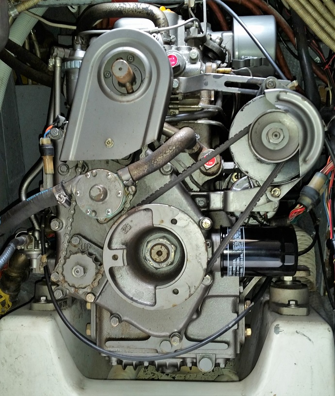

"tach proximity sensor"...are these accurate?....how to install?
they are as good as it gets ...but looking at your pic i don't see a plug in your bell housing ...its the same thing that yanmar sells for there tach equipped engines what engine do you have

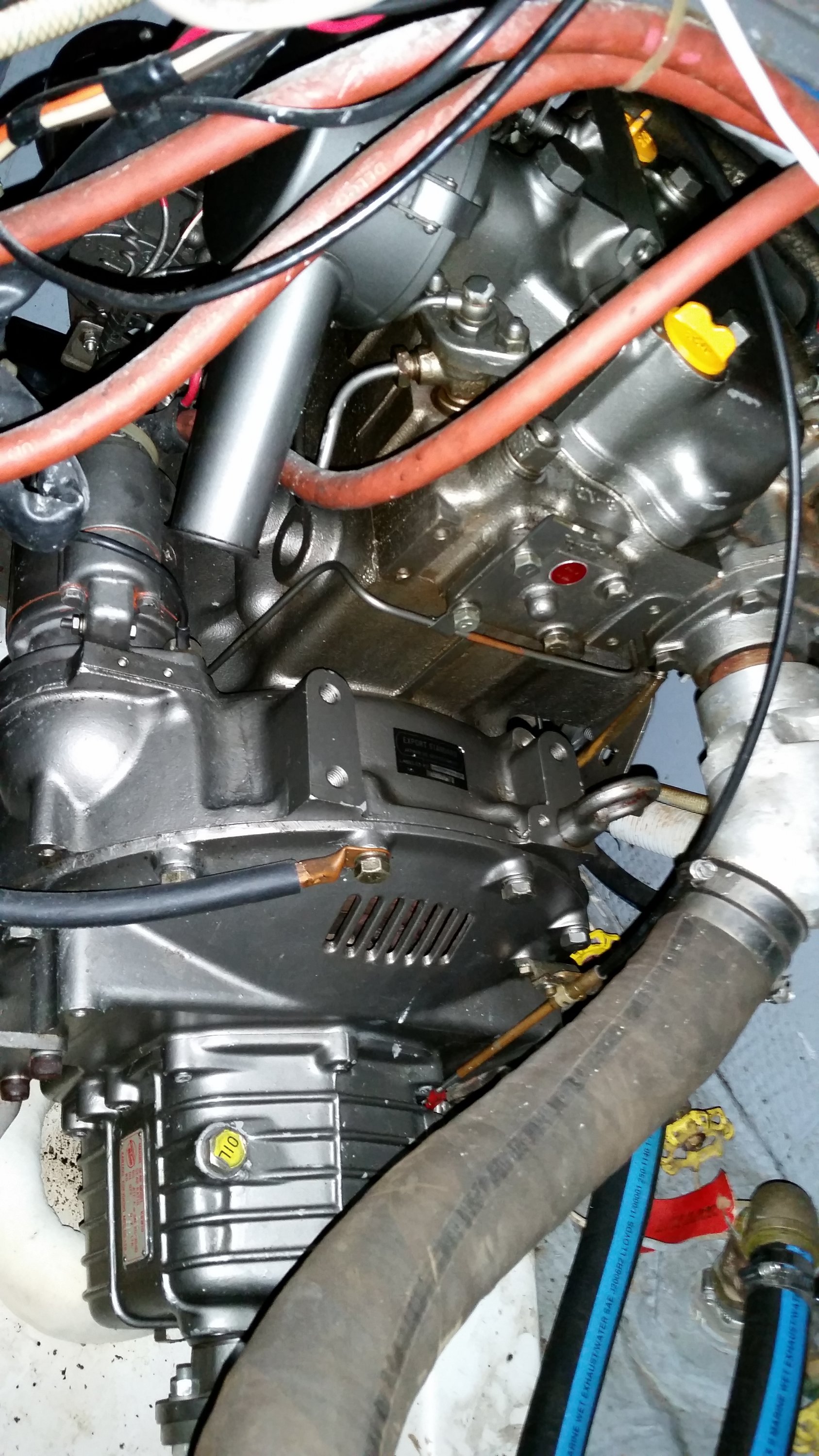

also from looking at your gearbox the shifter is on the opposite side from mine and all others i have seen ...what kind of gear box do you have...

It's located on the flywheel on the left top side of the engine as you are looking at the engine facing toward the front of the boat where the other guys are describing it. I have the 2 cylinder Yanmar and the picture above is a little different than my engine(and a lot cleaner).You can disconnect the cable at the plug and wire brush it and soak it's connector also if it is corroded. I'd probably do that first and then if it doesn't work, take the sensing plug out. It is a large MM plug and I had to use a socket and then a long(18') arm on the end of my socket wrench to break the seal loose. Once it moved, I could screw it out with my fingers.
