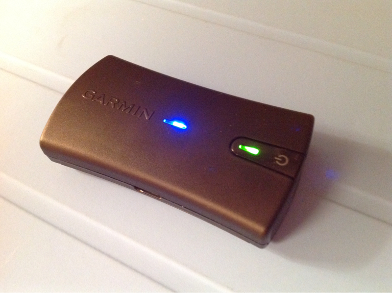

Here it is, an IPad , Garmin Blue Chart *Mobile* app, and a Garmin GLO (trademark) GLONASS GPS, and you're cook'n!
For the IPad Garmin Blue Chart *Mobile* app...~$45, the Garmin GLO GPS receiver ...$100. This is my answer to my Nav station setup below. The GLO GPS receiver was introduced last summer. Forget data use, the GLO works via Bluetooth and is very accurate. FYI, It does work off other map apps (Google, Navionics etc.). It is also a very small device.

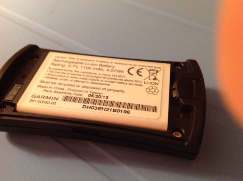

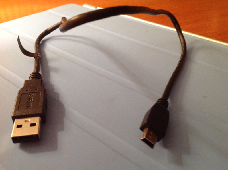

The unit's power supply is a lithium battery. There are two ways to charge it. 1) using the supplied USB to device connector employing either a computer or a 12 volt lighter USB adapter or radio as your power source...you choose! 2) using the supplied 12 volt plug in adapter with the USB connector. I'm so aware of cellular and getting a fix through triangulation, but, I'm also aware of *out of this world data charges*. I personally rely on the satellite signals that transmit to the millions of chart plotters worldwide. I like the fact, that this unit is stand alone, talks via Bluetooth, and is able to pick up WAAS and GLONASS...not bad! I have tested it using Garmin Blue Chart Mobile on a Gen 2 IPad which seems to be the best combo out there if you read reviews. In the reviews you will read of the "hair trigger" on/off switch...which it does have. In my case (sailing) I will mount it high at my nav station below deck where it gets plenty of signal and leave it. I have a 12 volt plug in and a JVC radio that has a USB connector on the front that outputs 1 amp...which is plenty of juice to charge "on the fly" and all at the cabin's nav station which is what I want this set up for...on deck at the cockpit I employ a Garmin chart plotter. Hopefully, this explains *MY* take on this device which I wanted to share. I'm not going to get into manufacturer bashing...it just does what I want...without hassle and extra costs! I have attached some pics. I hope they can be viewed.

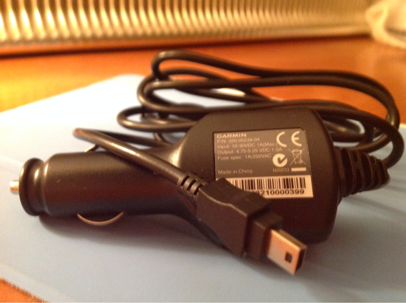

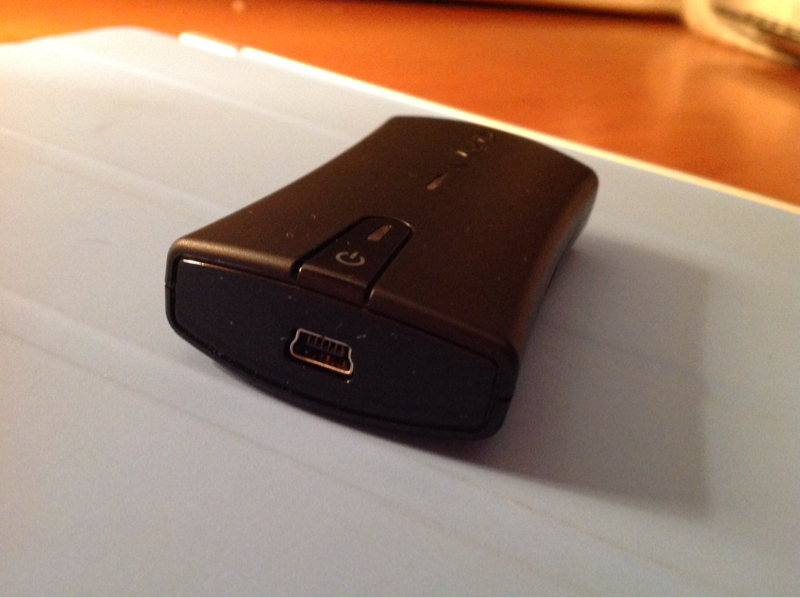

Your information on charging iPads is good to know. I too have a similar 12 volt adapter with the 'lightning' connector especially for the iPad. I hope I didn't confuse the topic in my last blurb. I like the 1amp USB output on my JVC, It wasn't something I was specifically looking for in a radio but it does charge iPhones, iPods and my new Garmin GLO nicely, even though for the Garmin GLO I prefer the 12 volt plug in supplied by Garmin...it has a much much longer cord as you can see in my pics.
