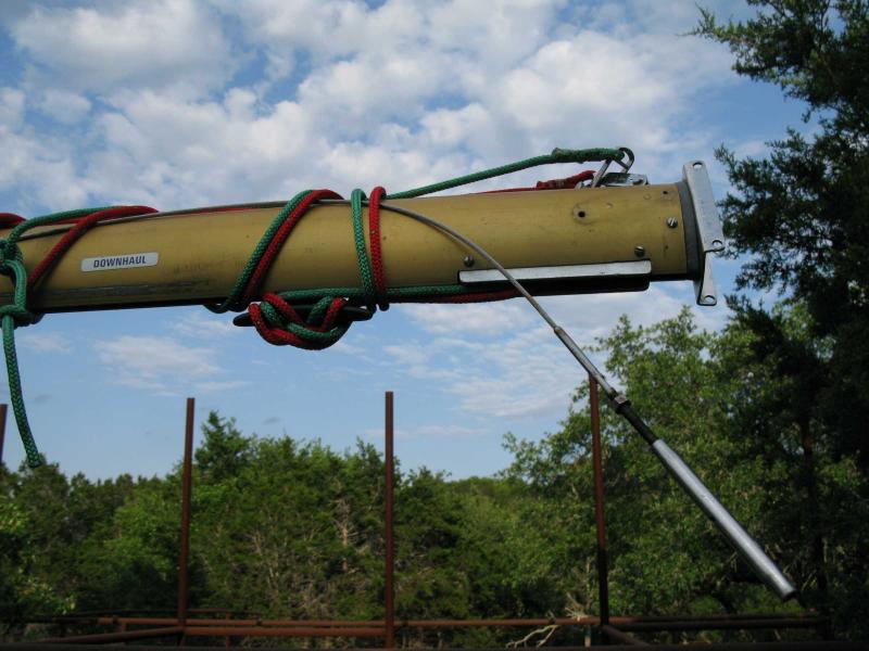

Oday Daysailer II, Rhodes 19, Mariner 2+2 Dripping Springs
I have a Rhodes 19 with the hinged tabernacle mast. Attached is a picture of my mast base and a PDF of dimensions I measured off my mast for another R19 owner.
