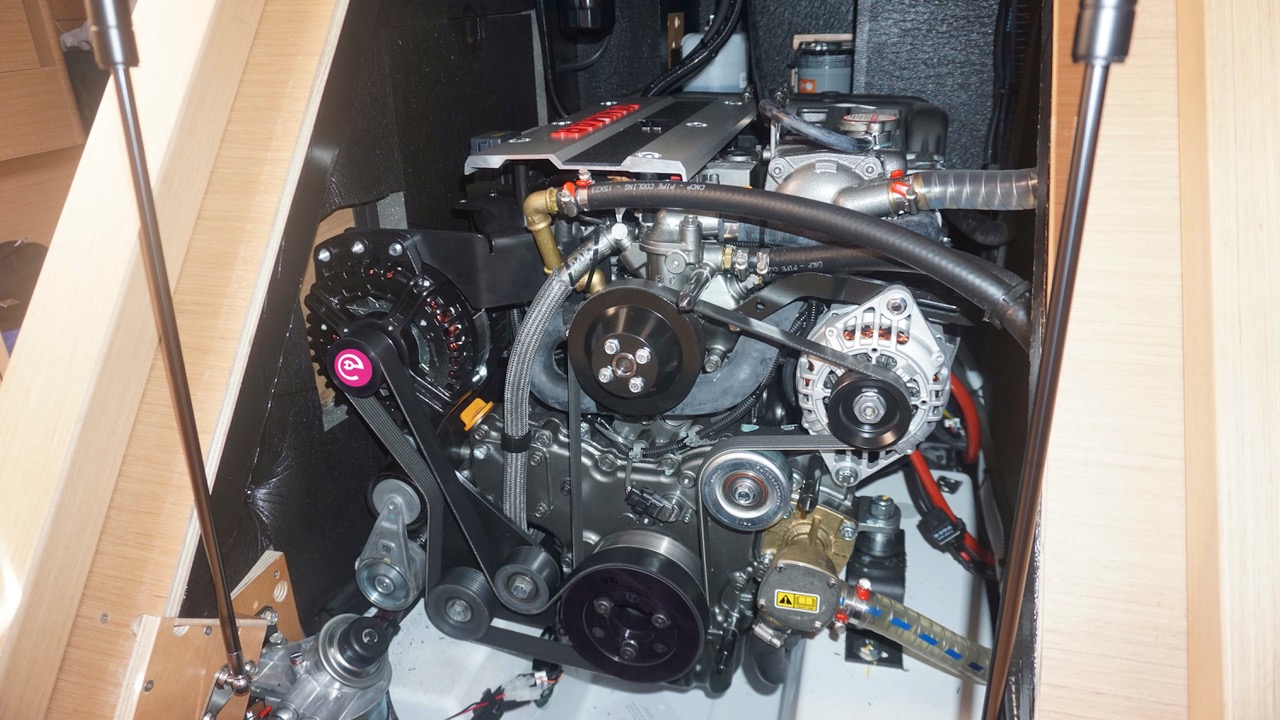

I don't think that is the issue. The big concern for electric is energy density. Pound for pound, diesel is the most energy dense fuel we have.
A Group 31 Battery weighs in at about 75 lbs and has about 1200 watt hours of energy , of which only 600 to 1000 watt hours are usable (depending on battery chemistry). By contrast 75 lbs of diesel is about 9 gallons, all of which is usable. On my boat at 6 knots that diesel will allow me to motor for about 12-13 hours or ~75 miles. There is no way for an electric motor to push my boat for that distance on just 600-900 watt-hours.

Perhaps the issue we are really talking about is efficient use of the energy we have. Running a 30hp diesel at a fast idle to charge the batteries is not particularly efficient.
One interesting solution is Integral Solutions. The alternator and charge management devices optimize charging while the diesel is running, reducing charge times and engine running.
Balmar and others approach the issue a little differently building their alternators to have a high initial output so batteries that can accept high charge rates can reach the absorption phase (Constant Voltage) quicker.
The small case automotive style alternators that many of us have are not very efficient at charging batteries and as our boat's electrical demands increase we need to up the game with more efficient charging sources and batteries that can take advantage of the more efficient charging sources.

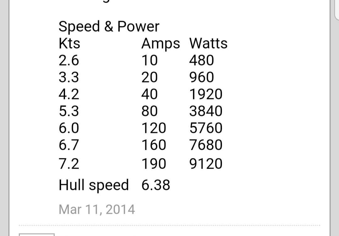

They creep along in some instances agonizingly slow. I think one of their greatest attributes is resiliency! I have to say that I am really impressed with their story lines, but they aren't convincing me that electric auxiliary is the way to go. And that's not to say that they are trying to convince anybody. They are very open about the challenges and difficulties.
You're absolutely correct about the agonizingly slow part. As many of us already know the faster you go the more energy one uses. That is one of reasons why most with auxiliary EP propulsion systems aren't moving along at hull speed for hours on end.
Attached is the speed vs power consumption for my boat based upon a 48 volt system. It's pretty accurate.
I have "motored" over 24 NM using a honda generator to extend my range.
Edit: Using a generator allows one to not only extend range but more importantly arrive at their destination with a battery bank that isn't depleted.
IMHO one has to really like sailing & be willing to "float time" to play tides, currents, wind direction to get to their destination if they plan on going down this road. That's why I've always said, it's not for everyone.

The graph of power consumption is interesting. A 10 hour motor cruise in wind less weather to reach a different location (half of the time against tidal currents) would mean I consumed all of my current battery power in 2 hours at 6 knots.
