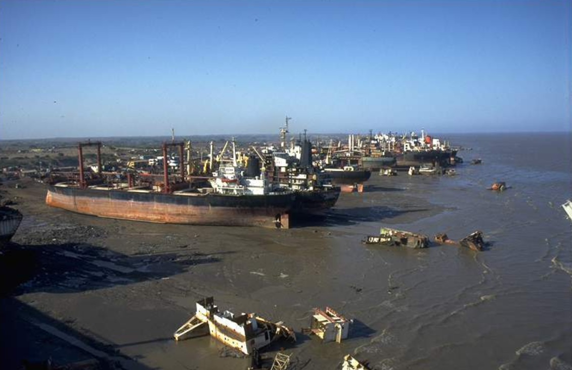

Weighing the balance of being of being clean and green
Please explain these terms. Are we talking only after you get the system installed and before you have to dump the system?
As I learn from reading about the manufacture of Solar panels, LiFePO batteries, and other parts of an electrical system, the discussion revolves around:
  • raping the forests and land of 3rd world countries to extract the raw rare earth minerals.
  • large amounts of energy to refine these minerals
  • a manufacturing process in 3rd world countries that have little regard for human life
  • Waste from these processes.
And that is just getting the system to you.
You enjoy the "FREE ENERGY" and great feeling of "BEING GREEN".
Then when the system needs to be replaced, the storage system and panels have little or no recycling value so they are dumped. There half life is something like 5K years in a disposal site. The site of course if like the Bangladesh dumps for used up ocean vessels...
GREEN SAIL BOAT ADVENTURES>

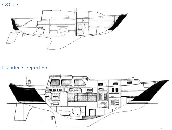

More to do with the angle of the prop to the water surface. Most sailboats prop are not perpendicular to the waterline cause p factor due to blade incidence of down going blade vs up moving blade. Like a prop driven airplane in a climb. Plus due to no angle with a sail drive the water flow does not work it's way up, as readily, to one side of the hull helping to causing a turn in reverse. I've loved the sail drives I've had in the past. Have you ever noted a properly trimmed (prop perpendicular to water), outboard doesn't have prop walk?
in my experience, the angle of the prop shaft doesn't have much (if anything) to do with prop walk. My old boat, a C&C 27, had a fairly "normal" angle on the prop shaft and very little prop walk. My current boat, an Islander Freeport 36 has an almost horizontal prop shaft and, when I first launched the boat, had a LOT of prop walk. After switching from an over-propped 3 blade to a proper sized 2 blade propeller the prop walk reduced but is still more than the C&C27.
Years ago I heard a theory that prop walk was due to reduced flow at the top of the prop compared to the bottom due to the proximity of the hull. That would explain why an outboard has little (or no) prop walk compared to an inboard.

let me explain "clean and green". It is a fairy tale, fallacy, a freaking big lie and nightmare.
wind turbines you will never harvest green energy that is equal to or exceeds the amount of carbon energy that it takes build them, install them and remove and dispose of them at the end of their life cycle.
solar panels and batteries the earth destruction for rare elements and the current inability to recycle puts them high on the earth unfriendly scale than nuclear.
Sailboats wind and a little diesel to get in and out. That's the real deal
View attachment 201366 View attachment 201367
I don't really follow this argument. We should continue to do what we have always done? And continue to to create shipyard gavesites?
