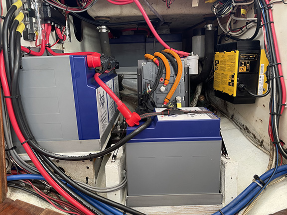

I recently had the original Volvo MD7A removed from my 1981 Morris Annie and replaced with an ElectricYachts Quiet Torque 10 Electric Motor. The new motor is powered by 12 Battle Born 12V, 100 Ahr batteries wired in series / parallel to result in a 48V, 300 Ahr system. Battery charging is done via 120V shore power, motor regeneration while under sail, and soon to be added solar panels.

Here are some photos:

New engine compartment
Bus bars and 3 batteries.
Cabin sole battery bank. These sit where the old fuel tank used to sit. The 3rd battery bank is on a shelf behind the motor & below the cockpit sole. The shelf was already there and the previous owner had installed ~150 lbs of lead ballast for some reason. Chuck Paine has no knowledge of why that was done.
