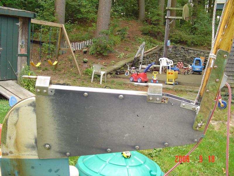

Joe, the rudder on the O'DAY 19 should be similar to the one on your 222, not exactly that same design perhaps.....but, closer to your rudder than hte one on my 1979 DS II. I've attached a few pics of the 19 rudder. I am resonably familiar with the 19 (from photos?) but it seems that the rudder kicks up like the one on the 222.
I would say that it's very similar to mine Rod.

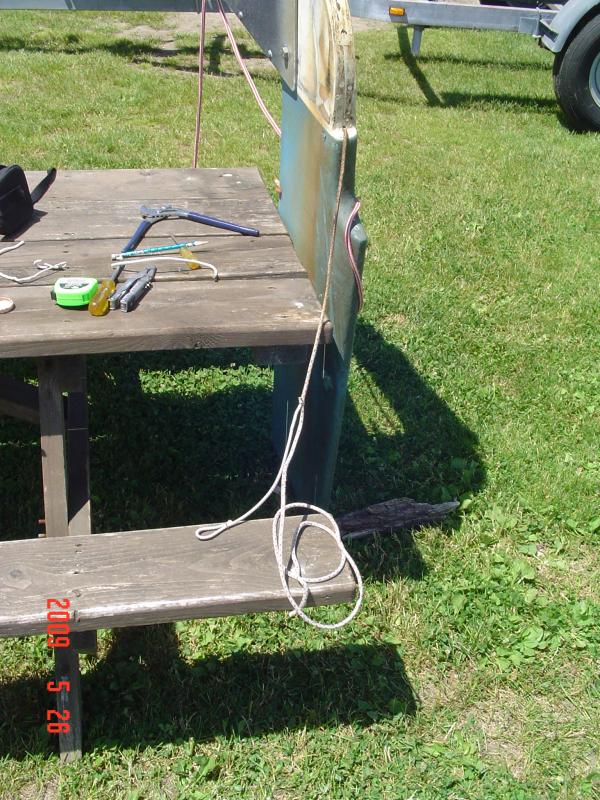

I have the hold-down line that you describe but the way its threaded up thru the top metal part of the rudder behind the pins, then runs into cockpit above the transom I have too much friction and no pulling power. Thats why I thought maybe you pulled from lower on the rudder thru the transom. It appeared that hole in back of your transom was for that but as I look more closely I guess thats an electrical cable of some kind. I still don't see an easy way to fully lower rudder especially if you need to do it under sail.

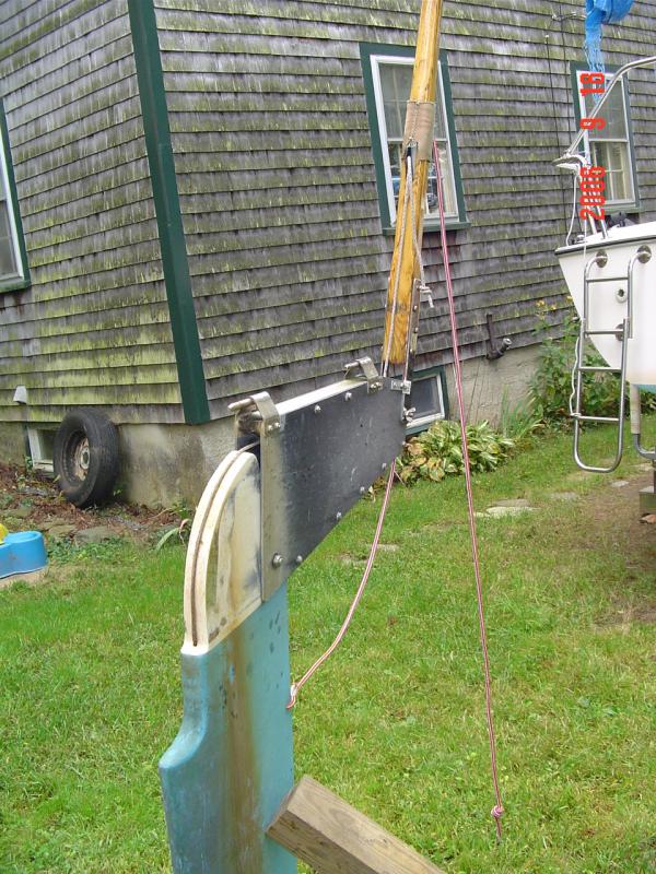

The under side of your tiller should be resting on top of a rudder head bolt and the pendant line on your rudder should be riding over the bolt just under that one. Also, the pendant line should be located inside the rudder head behind the Teak block on the pintle side.
The pendant line exits the rudder head over a bolt and goes under the tiller to clam cleat located under the tiller.

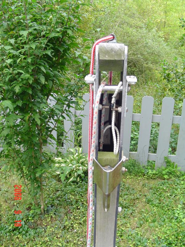

If there is too much friction for the blade to go all the way down, you are going to have to remove one of the rudder head plates and try to add shims. In other words, you need to widen the inside of the rudder head a little.
My problem with my rudder head was, it was a little too wide and my pendant line was getting caught in between the blade and the inside of the rudder head. Consequently, I needed to shave the Teak blocks down a little to get the rudder head a little narrower inside. It took some time, but I finally got it the way I needed it to be. Now, the line never gets caught. The bungee cord keeps the line tight when the blade comes up.

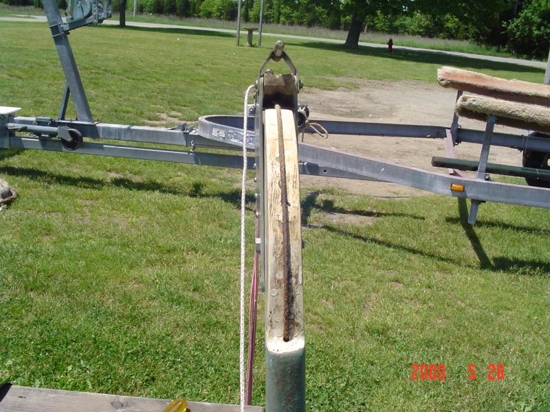

That pendant line needs to run up inside the back of the rudder head, behind the Teak block and ride over the second bolt as it goes to the clam cleat under the tiller.
What I would do is take the rudder off the boat and lay it on a picnic table with the tiller and pendant line attached and do some experimenting. Pull on the line and study it very carefully. Even though that line is riding over a bolt, it should still work as easy as mine. Do you need any additional pics of it? I brought my rudder home yesterday after I took my mast down and folded my sails. I'm planning on bringing my boat home this morning at the High tide.

The line just come up behind the Teak block behind the pintles and exits over the next bolt under the bolt that the tiller rests on.
On my rudder, the line exits over the last bolt because my tiller has two stainless steel plates that fit over the rudder head. The stops for these plates which hold the tiller up, are mounted on my rudder head.
