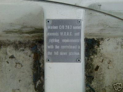

The reason for the hold-down pin on the MARINER (when/if fitted) was to keep the CB down when racing in deep water. This was to keep the CB down if the boat was laid on her side in a gust, supposedly... the MARINER would meet M.O.R.C. self-righting requirements with the CB locked down.
The pin was not intended to be used in shallow water, and my feeling is that under normal sailing conditions, the 165# weight of the CB should hold it down OK. The 200# of lead in the bilge combined with the weight of the CB, should keep the boat upright under normal conditions, especially if the boat is sailed like the centerboard boat she is. Actually, even without a pin locking the CB down....... with a 165# cast-iron CB, I think the boat will still come to a pretty fast stop if a rock pops up less than 4'11" below the surface.........but hopefully with little damage over than a bit of lost paint on the edge of the CB.
I may be wrong about there ever being a pin to hold the CB down...... but I still think I heard about one somewhere, however....... I really can't see the need for it and just found the following picture.......which tends to show that the CB should stay down in a "knockdown" even without a pin.
