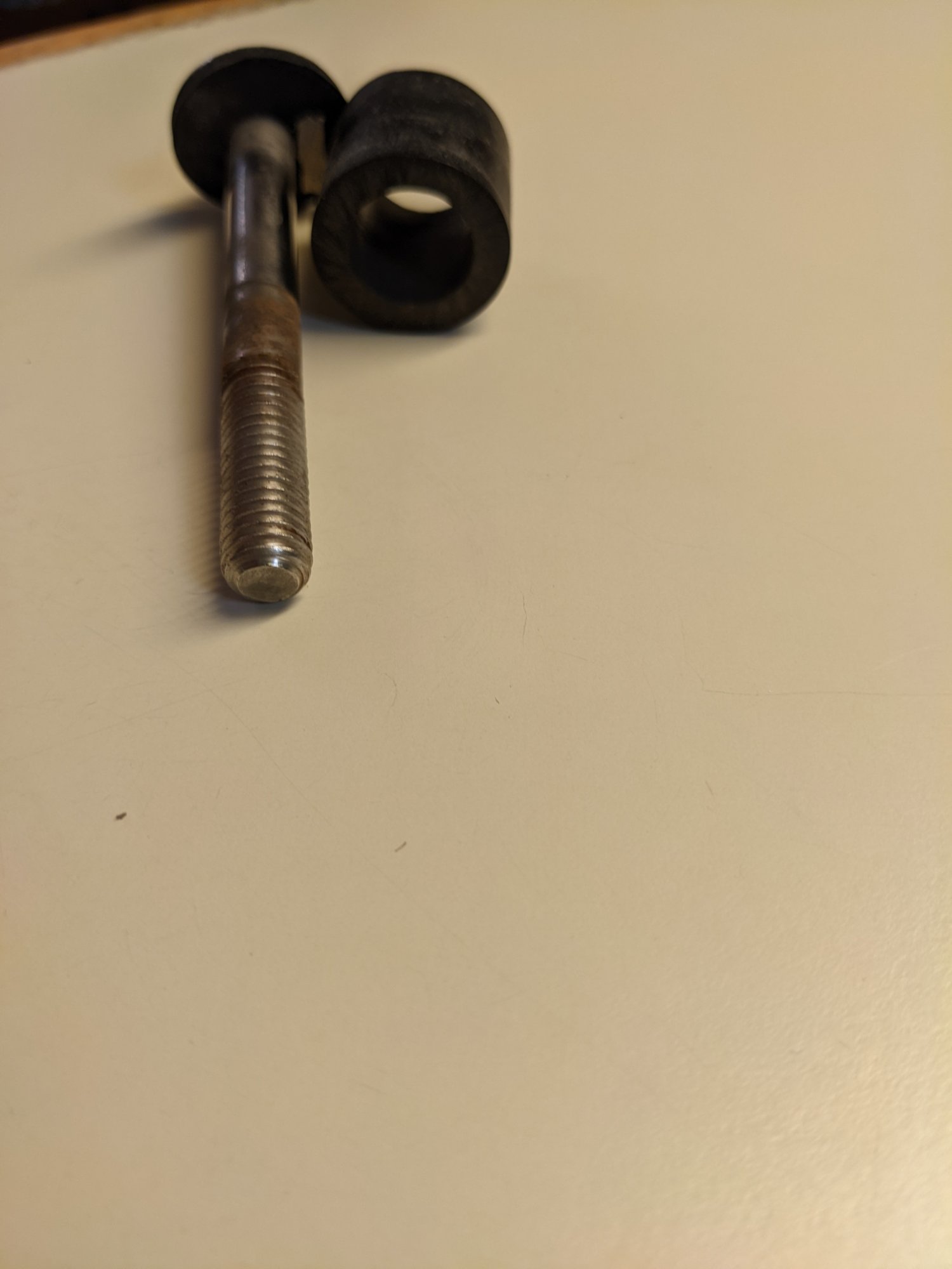

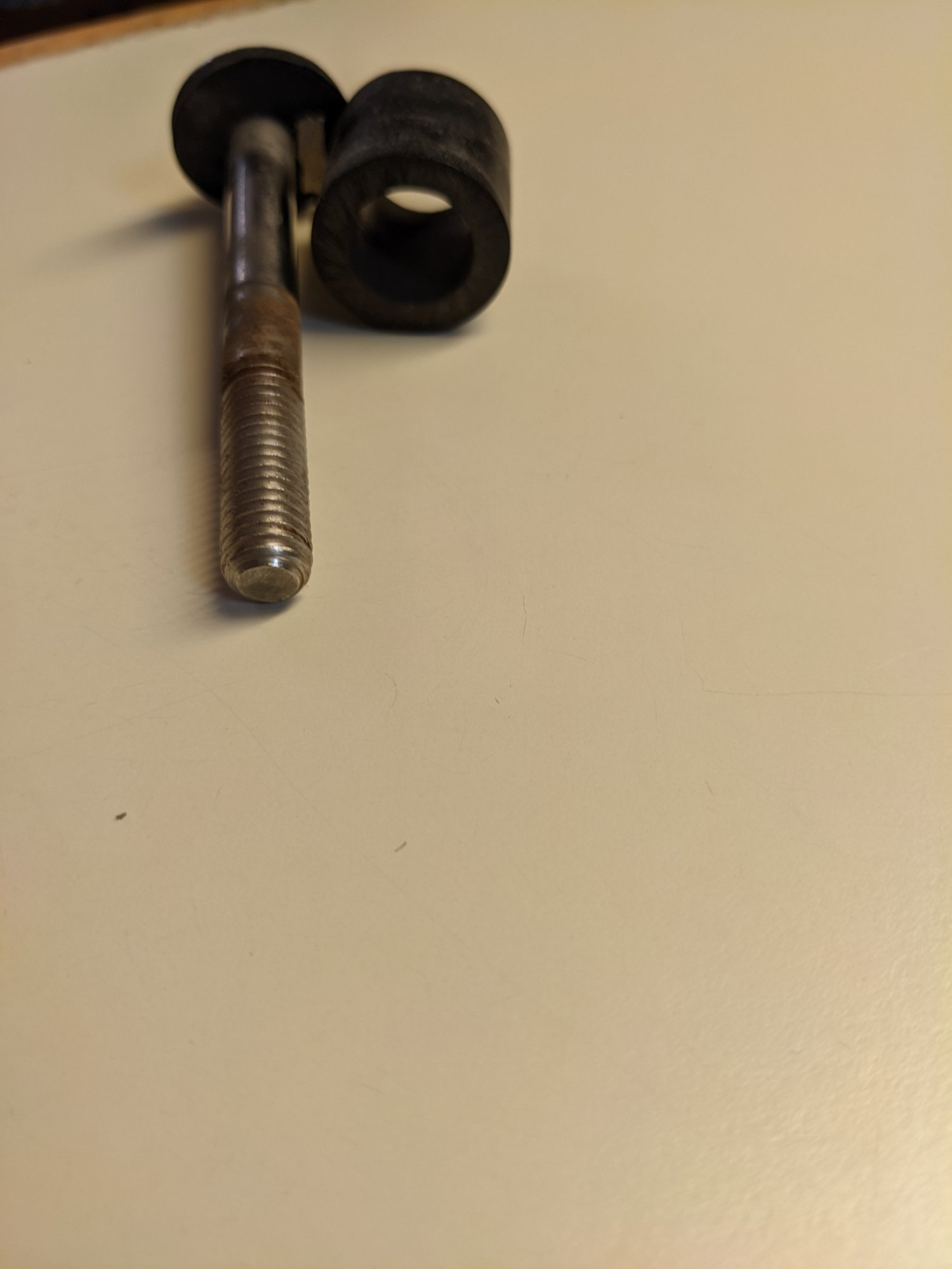

I added a picture below. This is what I found when I dropped the swing keel centerboard. The black spacer fits in the centerboard hole. The long 3/8 bolt pivots in the black spacer. Its unclear if that spacer, which appearently was acting as a bearing, was fixed in the centerboard hole or if it was lose in the hole. Over the years the black plastic roller wore and also elongated the hole in the centerboard. The plan is to repair the elongated hole with epoxy and fiberglass cloth and then drill in a new plastic spacer bearing, which the 3/8 bolt will travel through.
