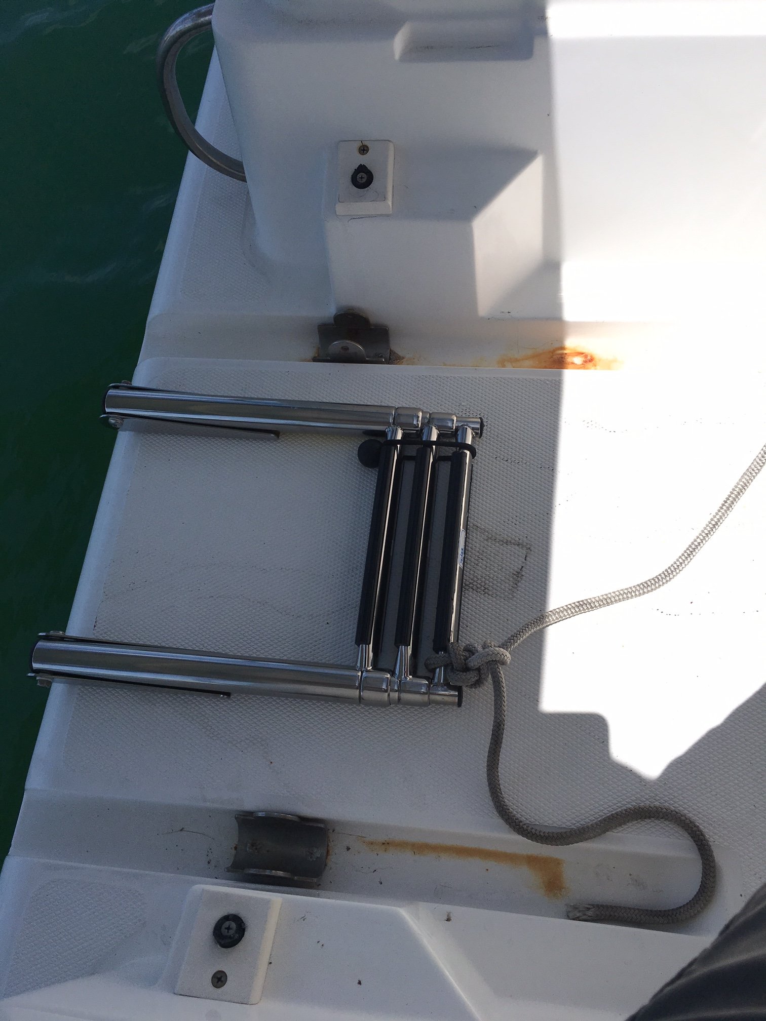

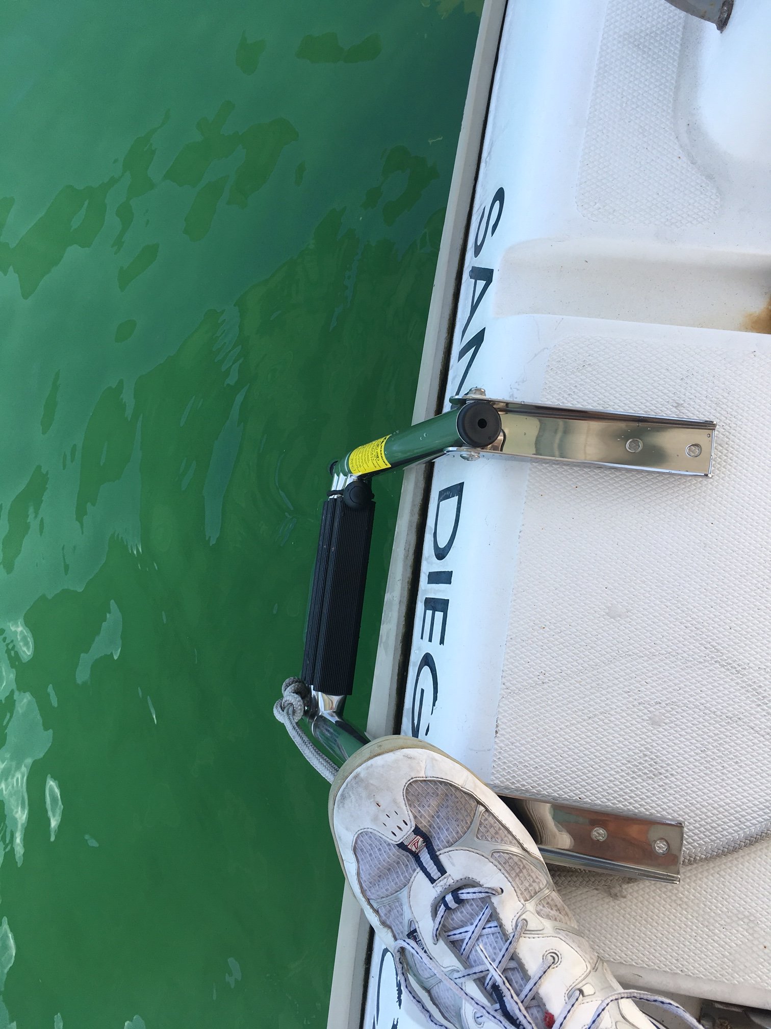

Boat 1.JPG Boat 2.JPG Attached are Ladder Pics. I have not installed yet. The ladder is about 12-14" wide. Is it OK to use 2 separate mounting backers, one under each mounting arm. The glass in that area appears to be about 1/4-3/8" thick. I can get under it to mount a backing plate. I was considering 1/2" or 3/4" Marine Plywood. And of course 4200 on both sides to seal and help secure.

This is the same ladder as on my boat. It's ok except when climbing out of the water one's toes are squished against the hull. OK so long as you move quickly step to step. The stand off is a bit small.

If it were me, and it can fit, I'd use a single piece of ply across both attach points - the more surface bearing against the hull, the better (it seems to me). My 23 has the motor mounts and swim platform/ladder backed with simple 2X4's (it came that way when I bought it used). Has not been a problem. If you use ply, I'd at minimum seal the edges so water does not wick in, and if you want, the surfaces. I think I'd use epoxy, like West System, which is what I did for a chain plate support bulkhead I just replaced. But I'd seal the wood, not glue it to the hull.
