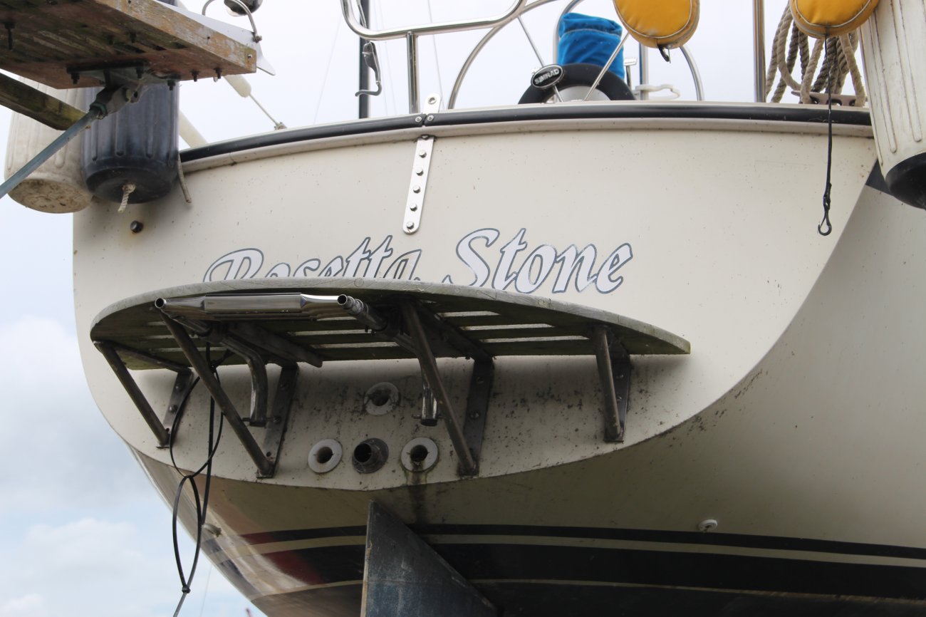

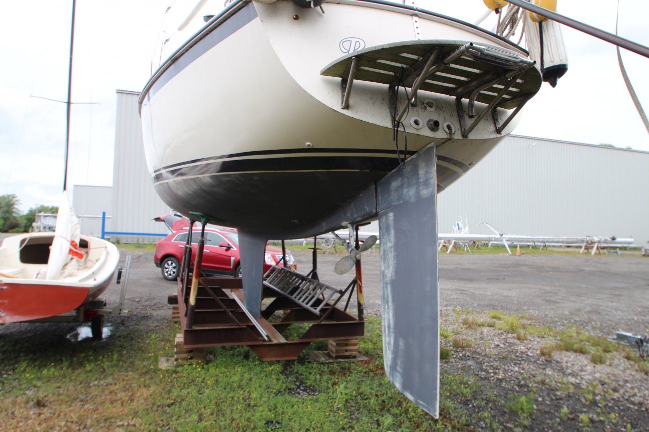

Here is a link on this site for a Teak platform built by the previous owners. https://oday.sailboatowners.com/mods.php?task=article&mid=139&aid=6547&mn=34 We own the boat now, LOVE the swim platform. We scuba of the back of the boat works great, The young grandkids love jumping in the water @ anchor. very easy to board and unload the dink. I'll look for updated photos that show the swim ladder. It retracts and stores below the platform. I have current photos with everything cleaned up. Let me know if you need to see close-ups. BTW it will be expensive to buy the teak if you can find it in 8/4. Also the brackets were custom made stainless bolted through the transom. I added SS plates vs the flat washers that were orginal inside the transom and bed them with Main sails calk

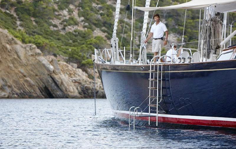

What a variety! The top ladder looks rather simple and efficient. Any idea what it's called, the manufacturer, etc? Barnett
