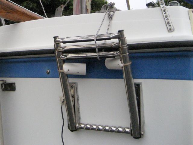

This one I can reach the rope that is looped and hooked on the fairlead from the water. If I couldn't reach it I would use a highway mans knot that could be pulled loose from the water. This telescoping ladder was $25 on ebay.
