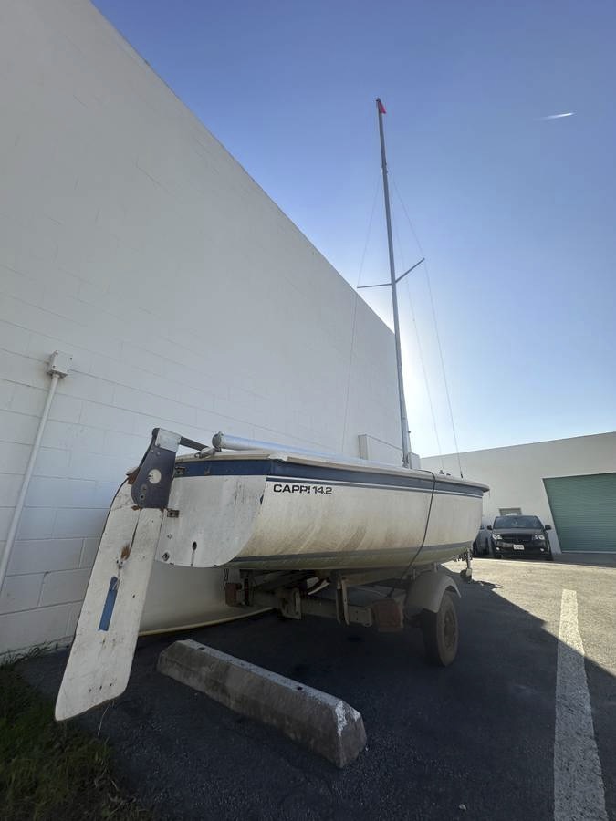

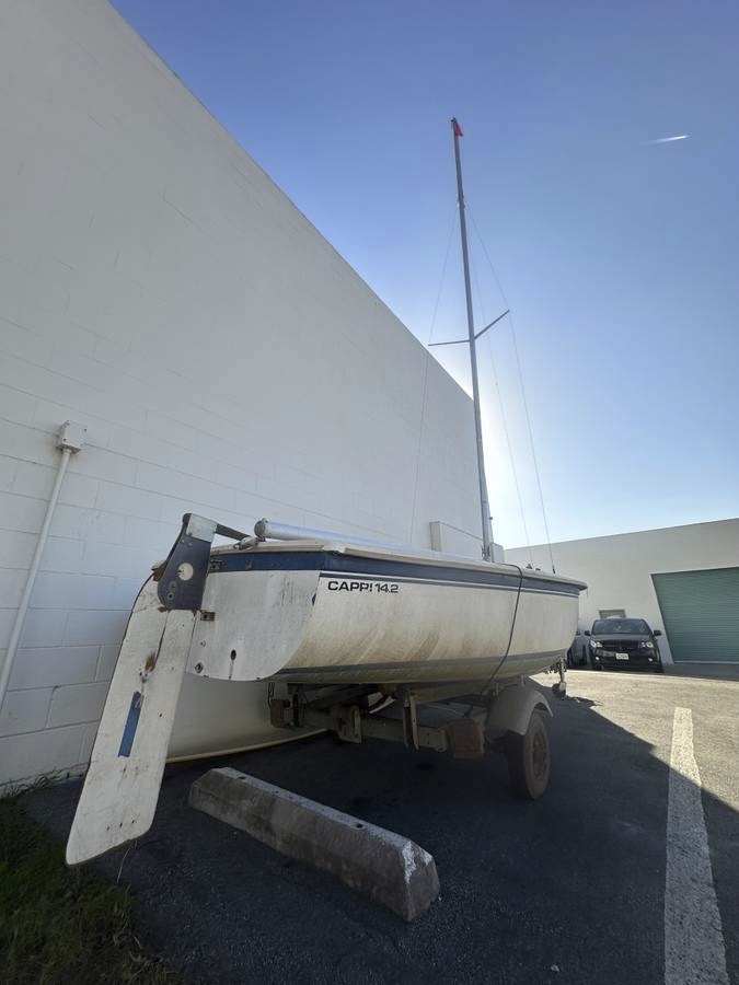

A few months ago, I looked at a 14.2 on the central california coast. Probably too far away for you. The hull was a disaster and needed to go to the landfill. Sitting on a trailer asking $300.
  • Wow
24,531
What a find!
The Capri 14.2 was built (5200 of them) in Woodland Hills, CA.
What a road trip opportunity that would be, going home to find a mast.
Jun 2, 2004
3,648
A few months ago, I looked at a 14.2 on the central california coast. Probably too far away for you. The hull was a disaster and needed to go to the landfill. Sitting on a trailer asking $300.View attachment 238083
Road Trip, Baby!
That's exactly what I was talking about.
The trailer would be worth two or three times what is being asked.
Probably could have bought it with two Franklins or five Grants
