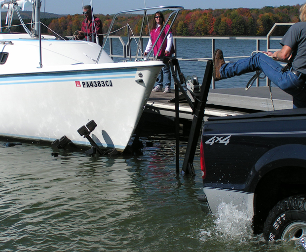

3 Build a whole new extension similar to “dscribner’s” pictured above, the most expensive

My Hunter 260 was supplied on a Magic tilt trailer with a 7 ft telescopic tongue extension. The brake line for the surge brake is a rubber coated s/s braided hose that is passed down the inside of the tongue. The hose is long enough nothing needs to disconnected to extend the tongue.
