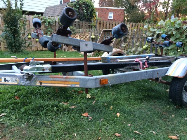

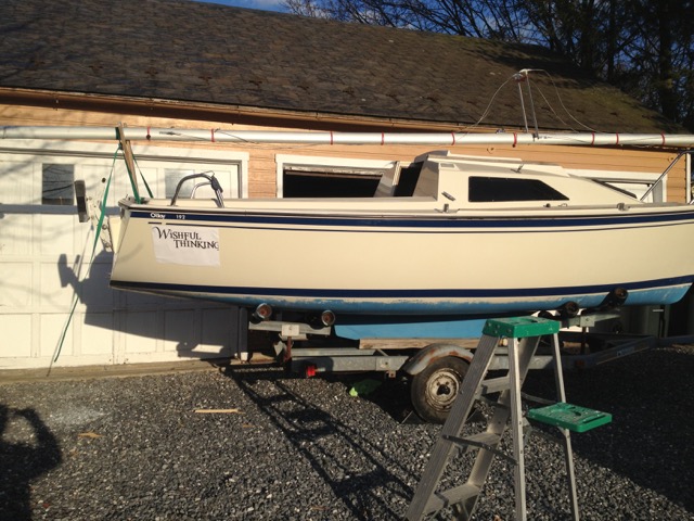

I have lowered the tongue of my trailer as low as possible, then built a tower framework under the stern using 18" long 4x4s. Then I jack up the tongue, suspending the boat between the stern and bow supports on the trailer. It's enough for me to get spots where the trailer rollers support the boat. I don't leave her like that for long. I'm sure the trailer doesn't care for it much.
I've seen folks with bunk style trailers put supports under the rub rail down to the ground, like when you see carpenters support the roof of a porch while they replace the columns. Then they lower the bunk, paint, and raise the bunk back up. The boat should be resting weight on the keel rollers, with the bunks just there to provide lateral support so she doesn't tip to the side.

In the scenario I suggest, dropping bunks, I can't see needing more than 2 supports to ground roughly on thirds of the boat. All you are doing is preventing it accidentally falling towards the side you drop the bunk for the day while you paint 2 coats on there...
I have 4 roller pods, each pod has 4 rollers. 2 stern, 2 towards the bow that really don't quite contact the hull. Problem is, the clamps and bolts are rusted to a non-adjustable degree. That's why I use Granddad's trailer jack trick to hold the stern up and effectively lift the bow. I suppose if I really wanted to, I could use a torch and sufficient amount of cussin' to replace the bolts on these roller pods. Nawwww...
