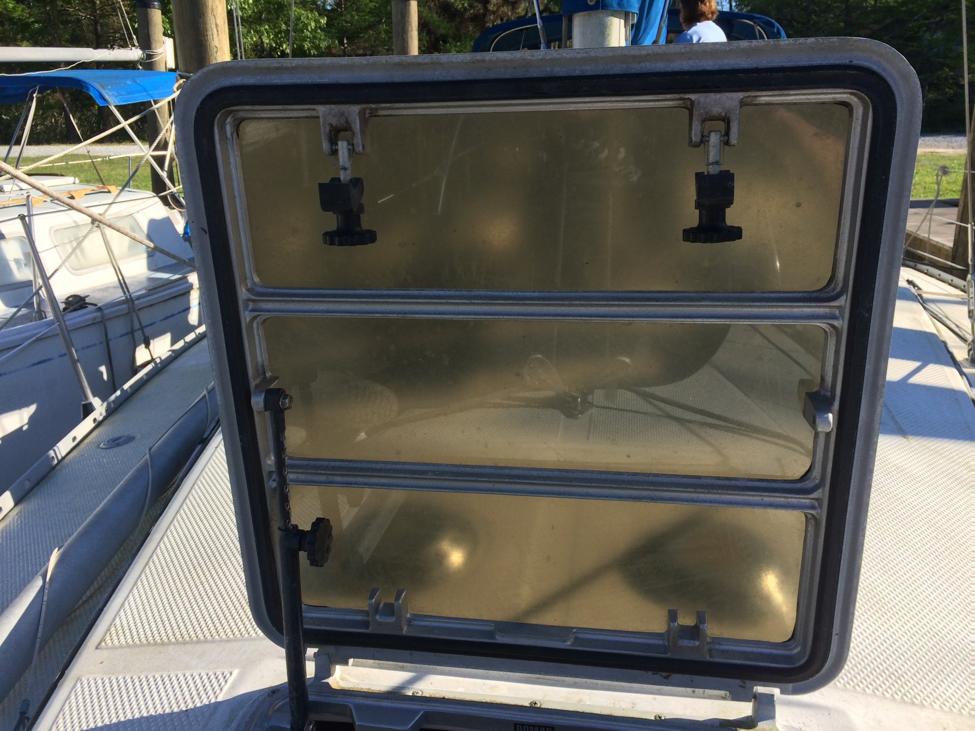

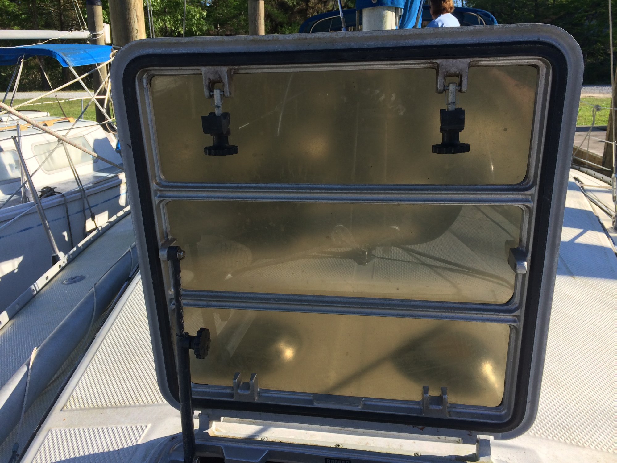

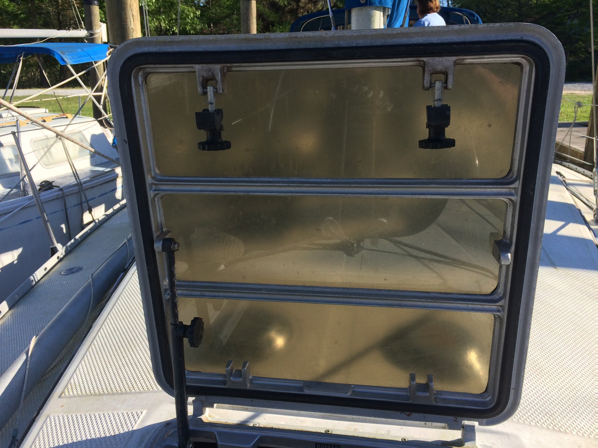

Here is a pic of the only one on the hatch but looks like it should have two?

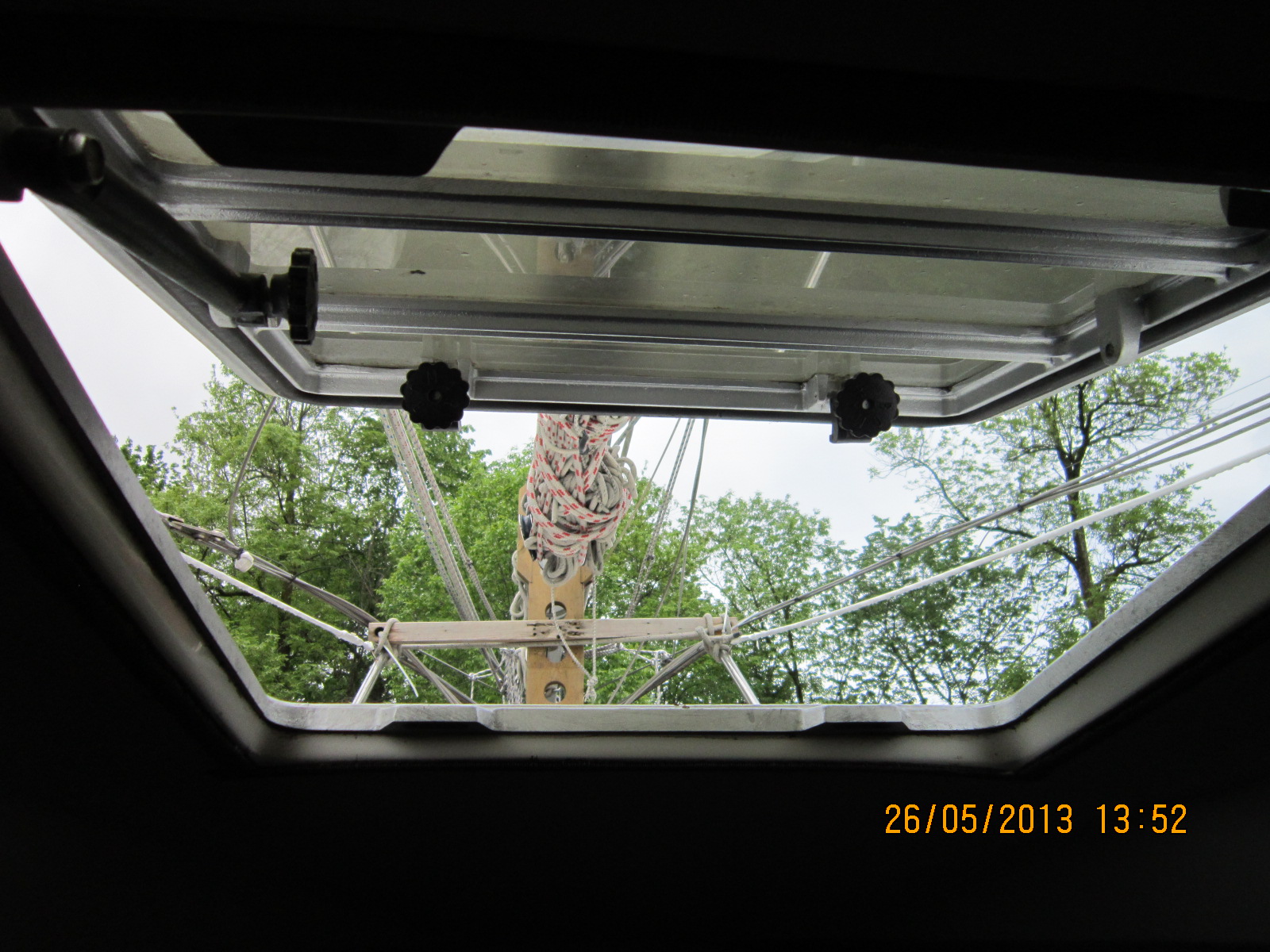

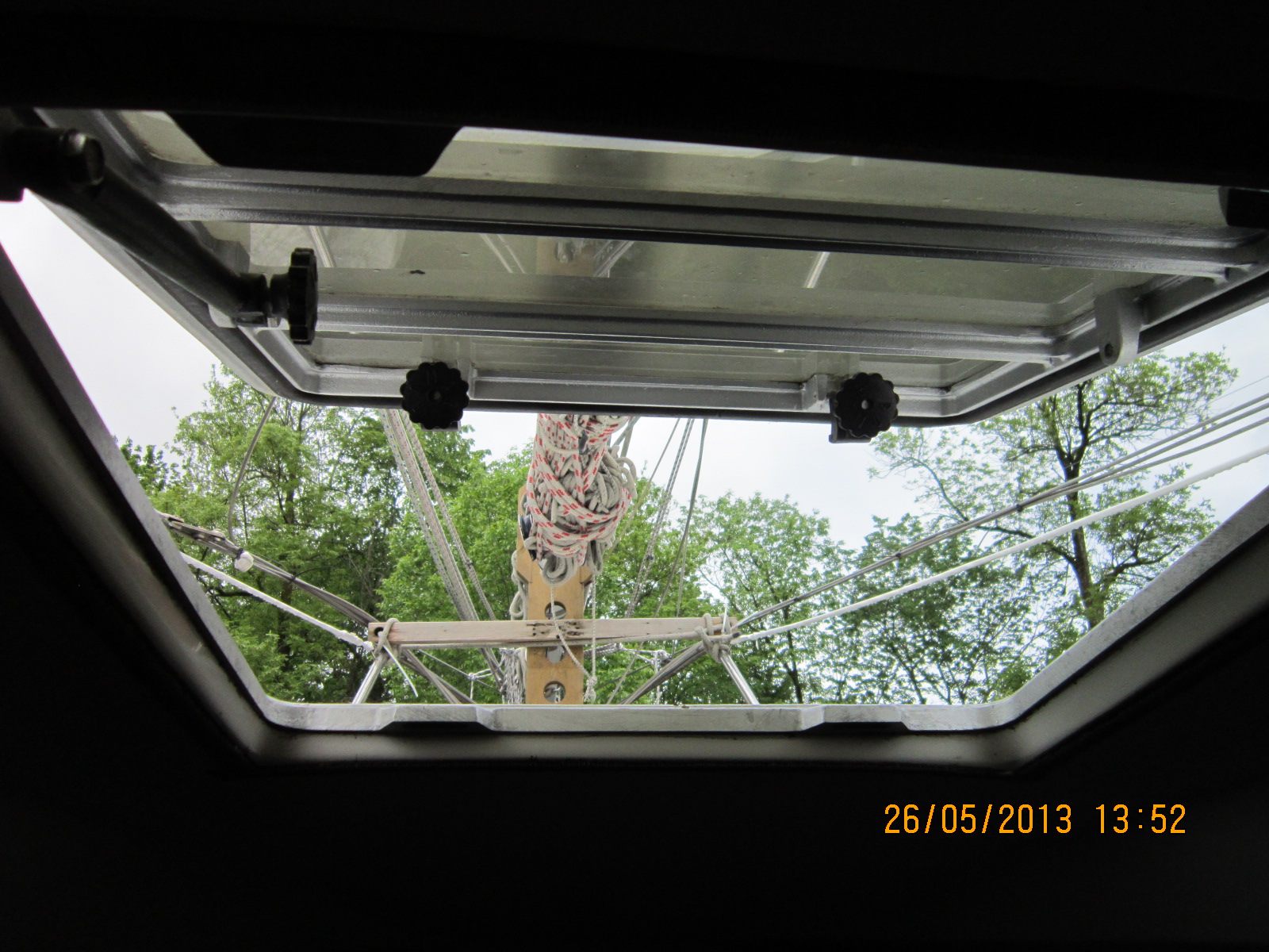

The early Bowmar hatches had only one support.. Picture is of my original on the '85 H-34 I think the same hatch was used on the 31.

Yeah, only one. The other mounting spot is in case the builder wanted it on the other side, like when the hatch opens in reverse.

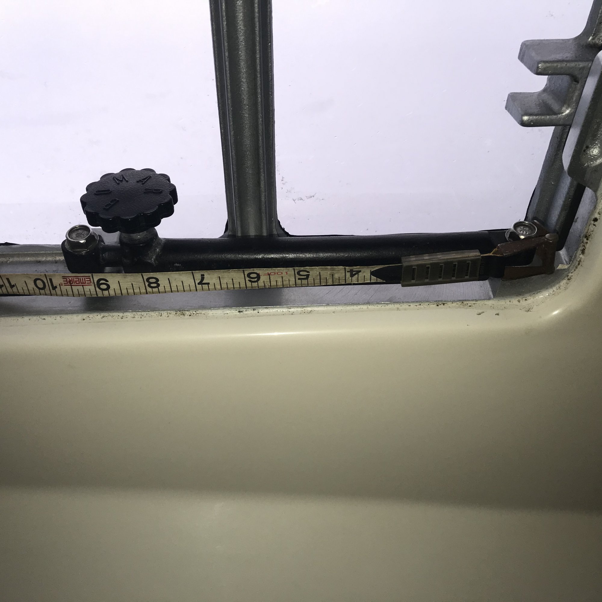

Mine were missing also. Looking them up, they were very pricey to replace. I installed ball sockets and gas struts. They work great and alot cheaper.
