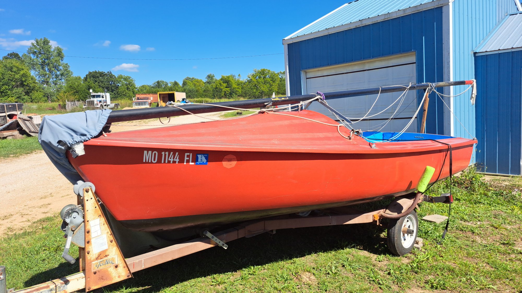

Hello everyone. Im new to sailing and I bought a 16" Sunbird fall of last year. I'm looking to mount a battery box to the floor board so that I don't lose my battery if I capsize. I've seen pictures of other boats that have done this but im not sure about what size screws they used of if they used anchors. I really don't want to drill into my boat unless I know that it will work. Has anyone done this? Is it a good idea? I would really appreciate some advice.

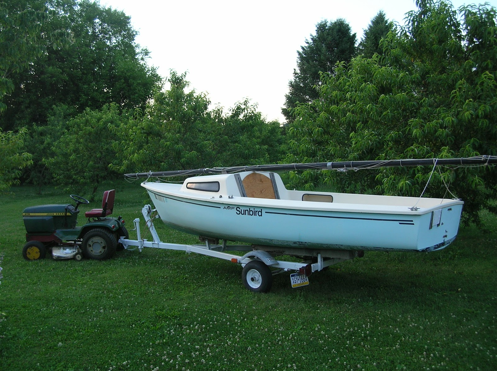

What are you powering with this battery? if using it for a motor, how far do you travel per outing? I use a 12v 10A gelcell for my dinghy. Orientation doesnt matter and it weighs less then 10lbs. If using something this small you have a lot of options for mounting (straps, velcro, VHB tape, utilizing existing fasteners, etc). Does your boat look like the one below?

There's quite a few bolts in this area that can be utilized to attach a battery box. You can even secure it with wood screws to the plywood if it not splitting like I think it is.
In your case, I'd probably put the battery box on the lower bolt, resting or nearly resting on the seat. It won't take up anymore room than the motor already is. In otherwords, your not losing usable space in your cockpit. My second thought was to utilize the bolts for the upper gudgeon (rudder mount). If it was my boat, I'd probably try to mount it in the cubby hole in the cockpit if there's access to route cabling in the hull
