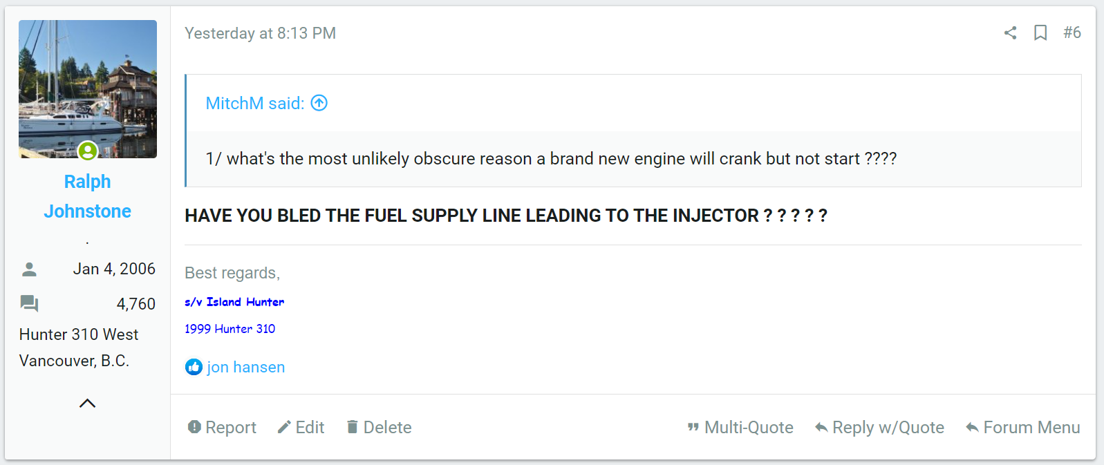

1/ what's the most unlikely obscure reason a brand new engine will crank but not start ????

You didn't mention bleeding at the injector. Crack open the line fitting at the injector and crank the engine (use the decompression lever so it cranks easy with your hand crank). You should get a spurt spurt spurt of fuel at that connection. If so, your bleeding is done and it should start.
