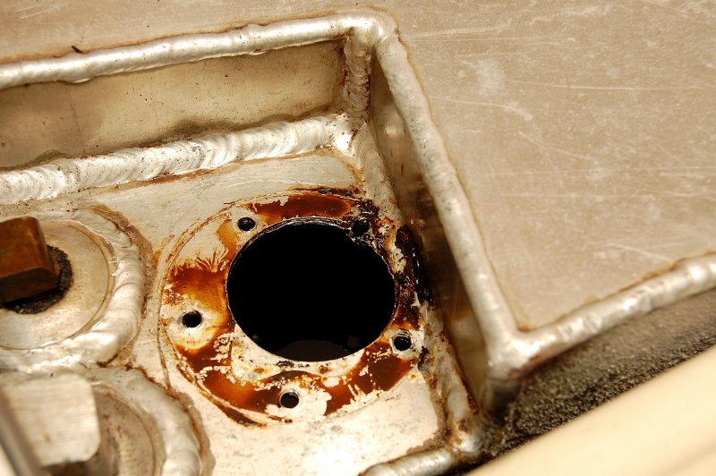

Doh':doh:....... It is absolutely horrifying that this boat left the factory like this.... Enough said....:eek:
The entire tank now needs to come out and be fixed properly or the owner will continue to leak diesel... !!!:cussing:

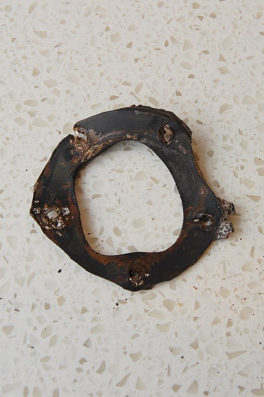

This is how the fuel gauge sender was installed from the factory. Oh and they cut an edge off the sender to make it fit better...? You not going to seal a tank sender on a lumpy weld with no surface area....

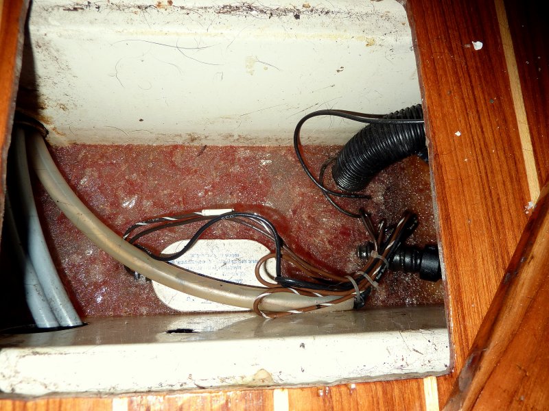

I had a water tank vent behind a cabinet for years. Couldn't figure out why I have water in the bilge under sunny sky for weeks. Only to notice every time I fill up the water tank, the bilge is full. That was a design problem.
Stupid builder.

It strikes me that there are several code violations, so that even if it is out-of-warranty, there should be recourse. There are minimum spacing requirements from fittings and holes to welds.
You can't even plate it without welding. Bugger.

I see another fairly obvious problem that the top of the tank is higher than these fitting. Is the vent line also at the lower level?
10,253
Cute trick ! Would have been fine if the hole had been cut about a half inch to the left.. Looks like a pre-fab top plate that was not trimmed quite correctly..

My guess is that it was not Endevor... the thing is, most of the production builders buy their tanks from outside vendors. My guess is that the tank had to fit as tightly as possible under a berth or settee, and the only way to maximise the volumn was to put the gauge at a lower level than the actual tank top. Seen this before, on more than one make of boat, power and sail.
As long as the gasket holds up, no problem... as the decades go by, not a good way to design it.
I figure that fuel capacity was the overall goal because the labor to put in the recess in the top was quite a bit more than just using the flat top of the tank, which would have required more free headroom above that tank top.
The vent line is not quite at that level but with everything working as it should, it would be fine.. When heeled the vent location becomes a non-issue anyway so everything else needs to be perfect.....
We should also keep in mind that some builders had complete tanks shipped to them ready to install so they may not have even done the "drilling" but they still failed to properly inspect the tank before shipping the boat..

I guess what irks me the most is the fact that someone knew damn well this was a PROBLEM, from the start. Instead of taking the time to make it RIGHT they Mickey Moused it by "customizing" the sending unit AND gasket to try and "make do"....
This was NOT a haphazard "mistake" it was a purposeful and deceitful RIP OFF to the purchaser of this vessel.

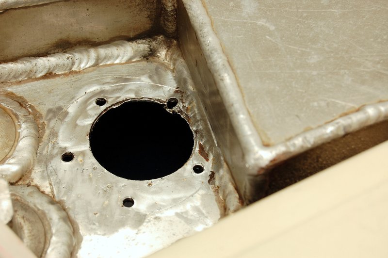

This is what I had to deal with before I could even begin working on the boat.....

This was when the company was doing quite well and going strong, not towards the tail end....... There was no need to scrap the tank just needed to scarf in a new plate and do it right... I have a locak welder who will fix this by scarfing in a new plate and doing it correctly... Will probably require new weld taps for supply & return (about $10.00 each from McMaster) but other than that it won't be a huge expense. The labor is what kills the customer and this will be about 4+ hours. I need to drain the tank into 5 gal jerry cans and haul it away, remove the tank and then reinstall it when it is fixed. If the tank bottom looks sketchy or pitted then it will require a new tank and will get even more expensive...

Many tanks are made with a stepped design to allow space for expansion. With that style, the vent is often placed on the lower step to prevent filling the air space.
Those pics do show a very poor layout choice

Everyone seems to be blaming the mfgr, but from looking at the quality of the fitting welds, I suspect that the sender was an aftermarket dealer or PO install, not done on the mfgring floor. MHO.

That hole position, and the kludge of cutting the sender flange a bit... definitely amateur hour. Did they make any attempt at grinding down the weld under the sender flange?
As a professional and you see this on a customer's boat , you have to call it out and fix it right. No other option would be acceptable.
I will confess though, that if it was my boat and the tank was otherwise perfectly OK, I would give a moment's consideration to some sort of custom enhanced gasket plus the right sort of sealant, to remount the sender, as an alternative to a $600+ charge. In that regard, the one stripped hole would the biggest block to that solution, because that would reduce the possibility of a solid 5-pt attachment.
