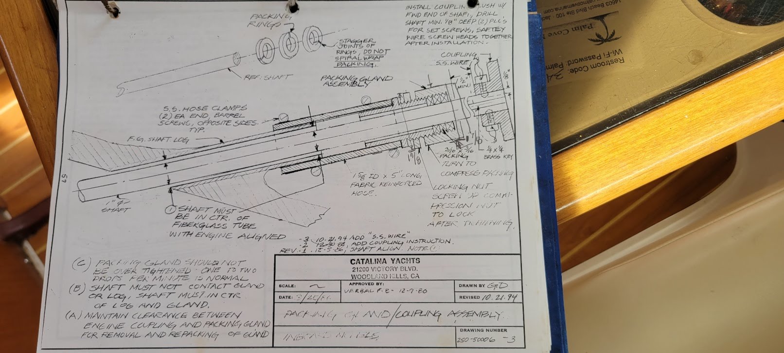

Was able to check the original owners manual from 1999 and on page 57 it states that the packing should be 3/16" (for some reason it states 3/16" x 3/16"). The page is attached. Once again this proves "if all else fails, read the directions!"

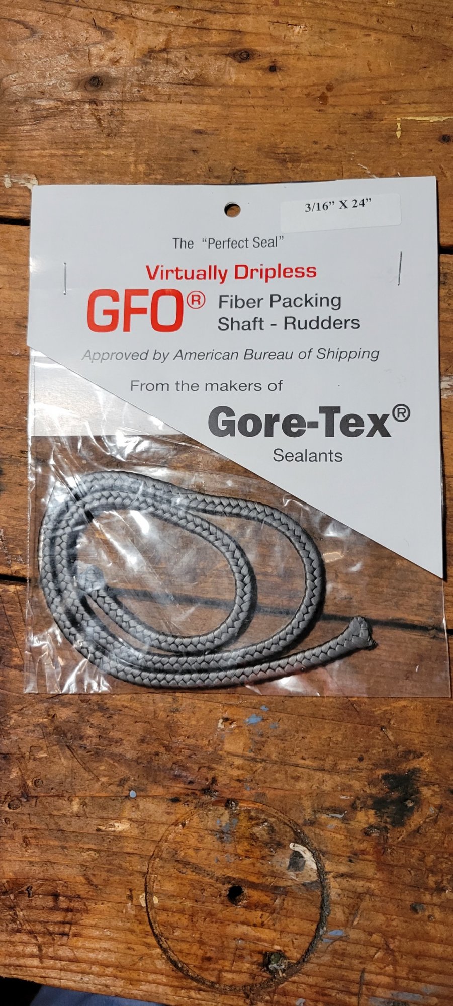

Got this from Emarine for $10 plus $3 shipping. West Marine wanted $30...20220917_124509.jpg
