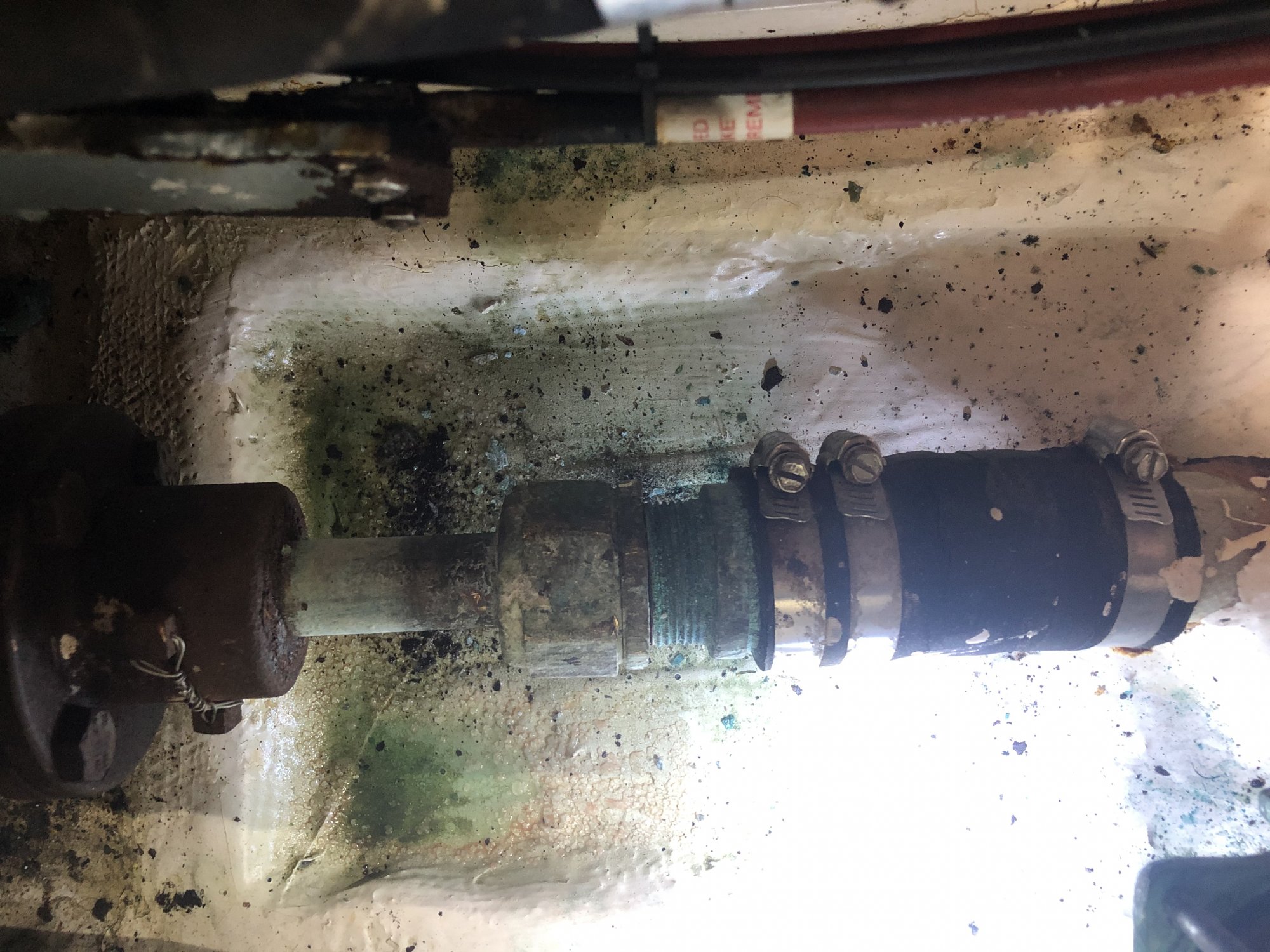

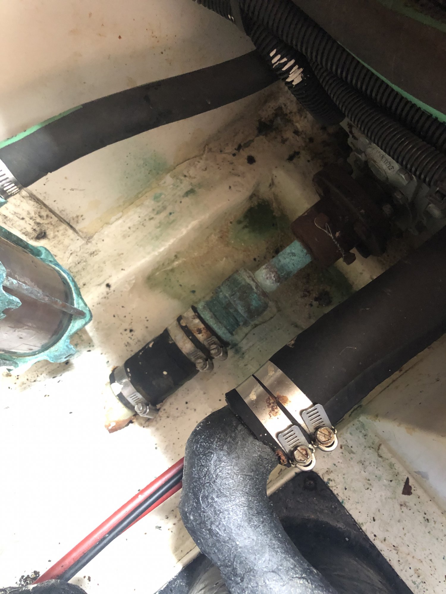

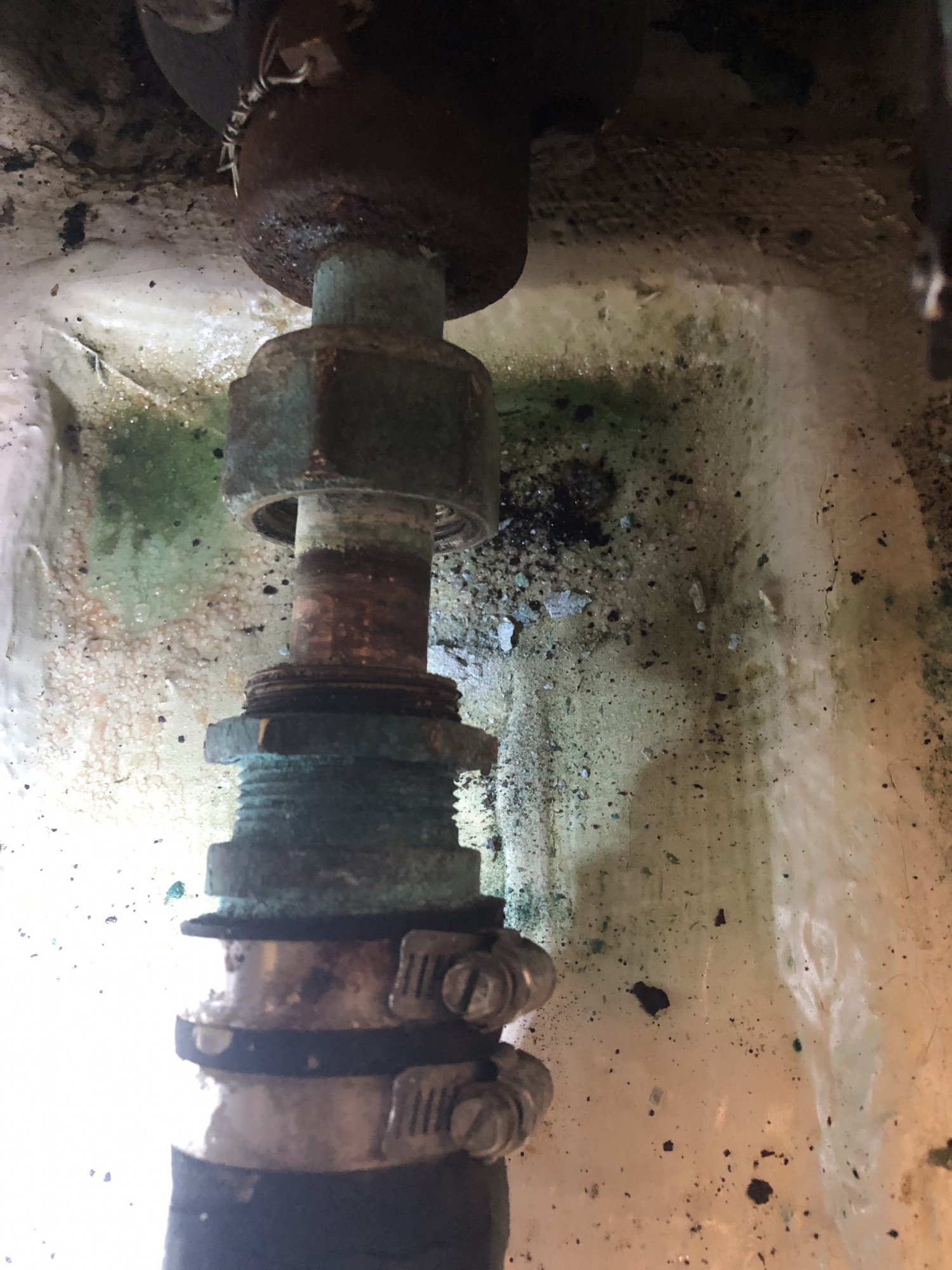

The first step was to open up the nuts. As you can see, I've got that pale green outer layer (I believe called a patina) everywhere. I believe the patina protects the copper below the surface from further corrosion, but I am am incorrect or there is a problem in this area on my boat I am sure that folks here will let me know. ;-)

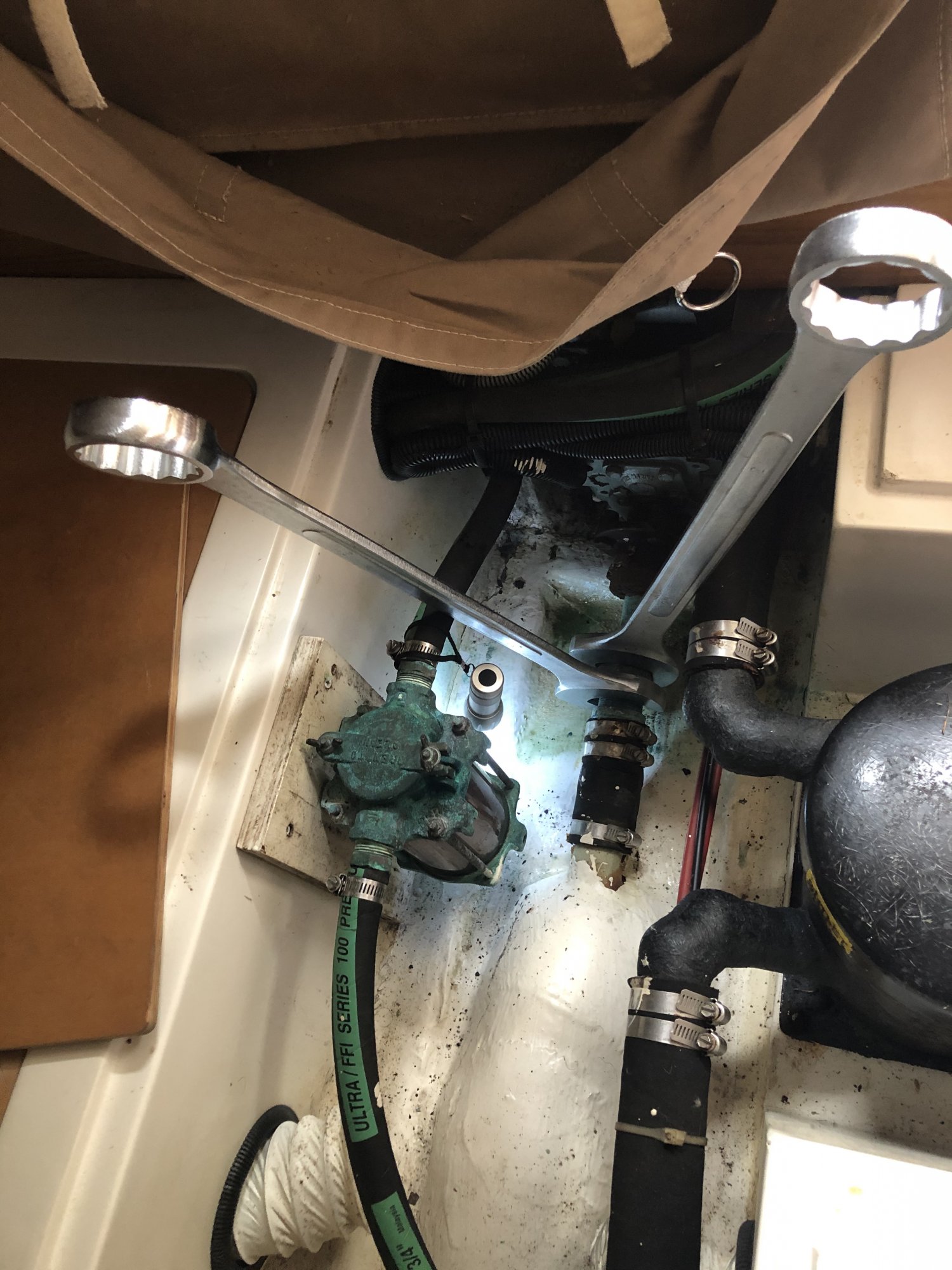

I have 2 giant wrenches that I am sure I overpaid for (again, from Amazon) but these things work, even if I have to do everything in a quarter-turn and then reposition the wrenches (just like with the impeller, except with much, much smaller wrenches).
It did take a little work, but I got the large nut slid up the shaft.

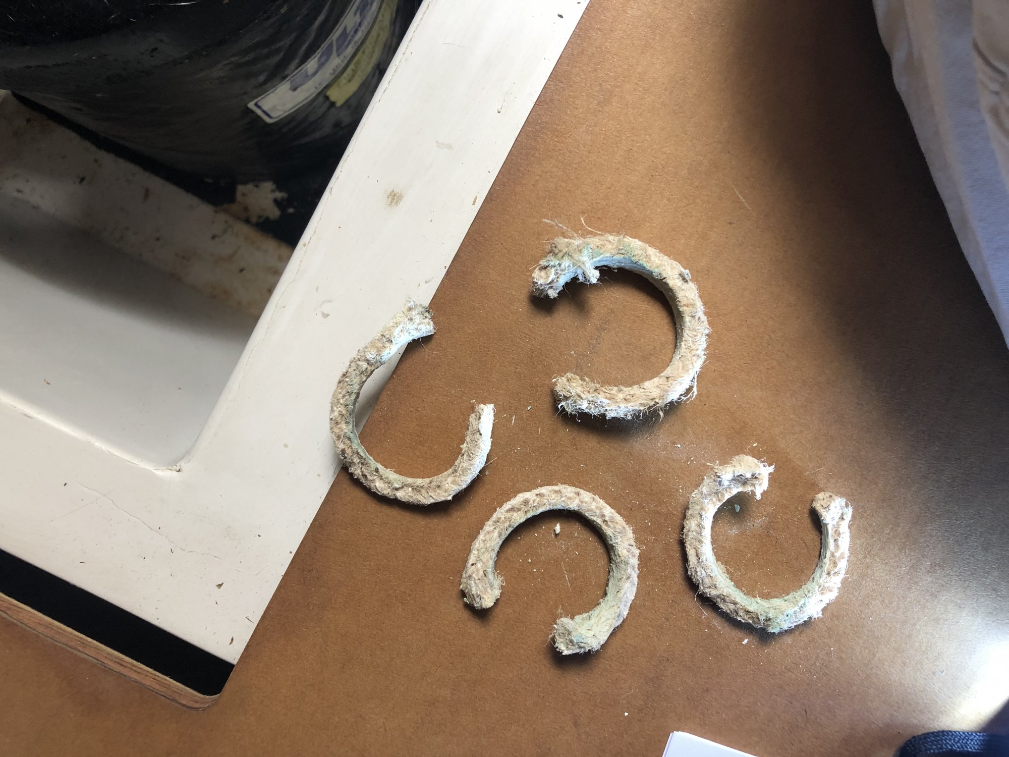

And using my tools purchased from Amazon had the old packing material out in less than 10 minutes. Note that there were 4 rings of material in there, which is the maximum the article recommends. Apparently 3 is optimal.

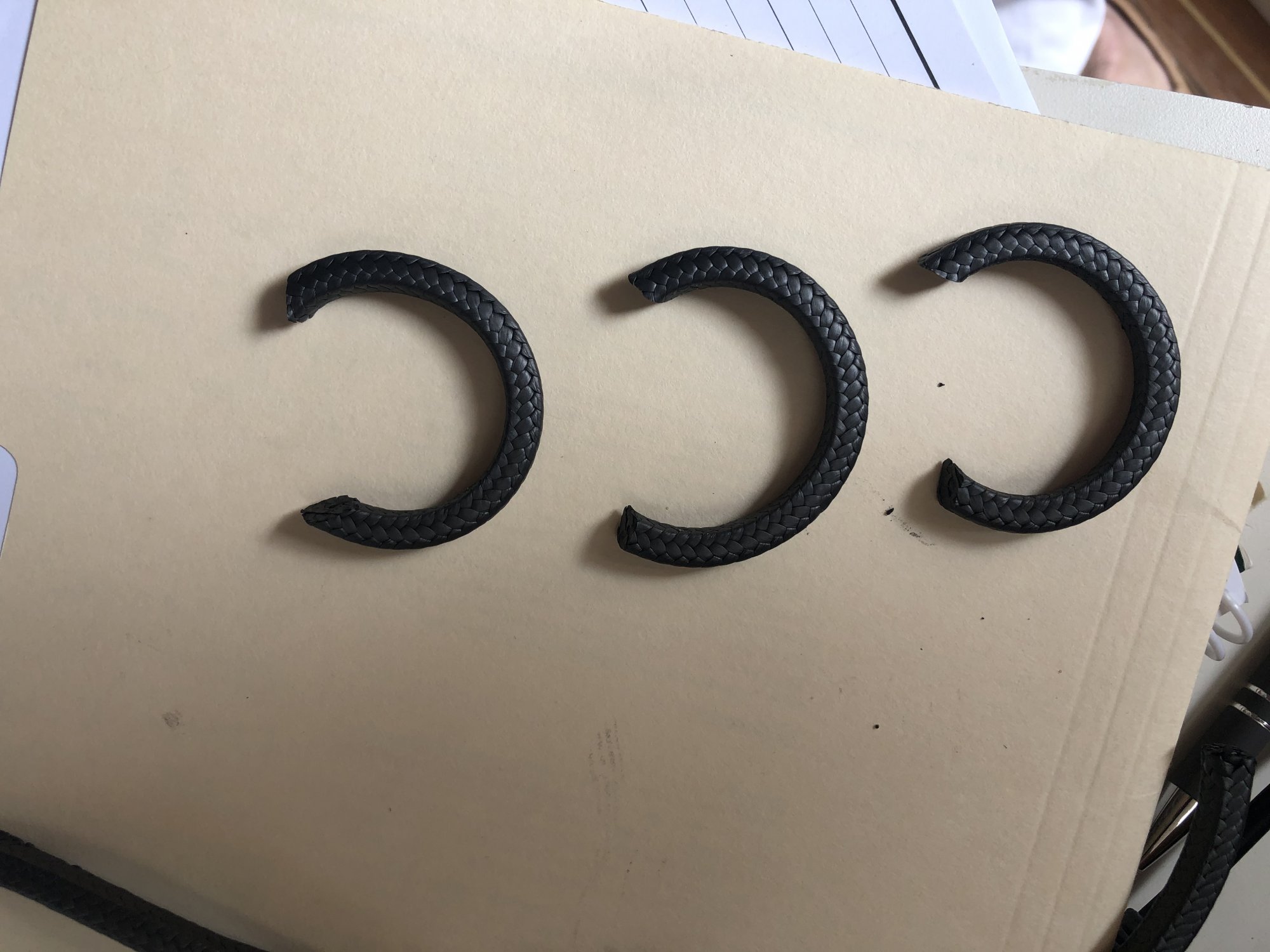

So following the instructions from the article, I went below the boat and used the shaft between the hull and the strut to measure and cut the new material (at the recommended 45 degree angle, with a brand new razor blade). I replaced the 4 rings with 3, as the article said you 'could' use 4 but 3 was optimal.
I then carefully inserted the material and used a flat head screwdriver to (carefully!) press the rings (one at a time) into the nut. I also used a sharpie to label where the cut was on each ring and staggered the cuts in the nut (again, a recommendation from the article). Then I re-screwed the nut back into place.
The job was not nearly as time-consuming or as difficult as I expected. It was less than an hour, start to finish. I was on the hard for this project, which made it easier as I didn't have to watch water flooding into the boat while feeling pressure to complete it as quickly as possible. But again, I won't really know how well I did until the boat goes back into the water on May 31.

Looks like you have a bronze shaft. From the pictures it seems a bit rough where the packing would contact.
It may still drip more than you would want as a result. If you tighten too much it could over heat.
One other note on the bronze shafts, the contact area with the cutlass bearing is also subject to copper depletion due to the sulfur used to vulcanize the nitrile rubber. May want to check that out.

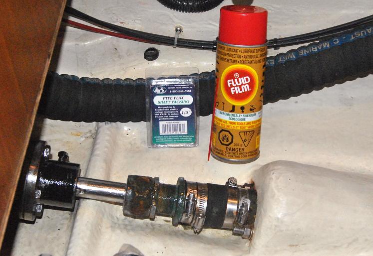

I know that bronze shafts can really get rough where they are exposed but if you re-pack with this shaft, be sure to clean the shaft as best you can before contaminating the new packing as it goes in. Speaking of packing, you didn't mention what type you used. If you do go for an SS shaft in the future, you may want to avoid any packing containing graphite, if only because it is controversial for the possibility of galvanic corrosion on the SS.
When finished packing, try covering down the whole packing assembly with Fluid Film or a water proof grease to hold off on corrosion and salt adhesion. Avoid the hose.

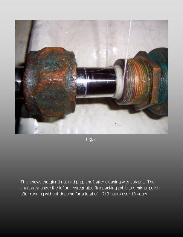

Don't rely on that old wife's tale too much (just love to get the old purists here ranting and raving:laugh:).
A few drops of water a minute isn't going to cool anything, nada, nothing, not one bit. It's the high conductivity, cold metal shaft that sucks the heat away into the water, and fast. As far as water lubrication goes, it looks like you used some sort of graphite bearing packing which has a coefficient of friction far smaller than water on solid packing.
The only purpose of the dripping is an indication of how tightly the packing has been cinched down. If the packing is leaking, you know it's not too tight. But then again, maybe not tight enough. If it's NOT leaking, it could be just tight enough or maybe way too tight. You just don't know if it's not leaking.
THE BEST INDICATOR OF GLAND HEALTH IS TEMPERATURE. Tighten the gland in increments of one half a flat until the surface of the packing nut is just wet, for safety's sake. Then when you get really wild and out of control like myself, you run the packing so it doesn't drip at all and several thousand hours later, it's has a mirror like finish.
The above applies ONLY to a correctly packed gland with modern packing. Improperly packed, all bets are off.
