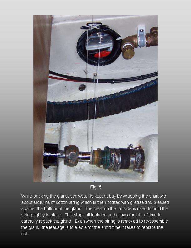

As far as giving you a breather to study what you're doing, try stopping all leakage using this method:
This shot is taken on our Hunter but I remember packing a Cat 27 way back and although it is a bit more crowded, using this method gives you all day to do the job.

Thanks! I saw this picture in another thread you posted in. I'll definitely try this out.

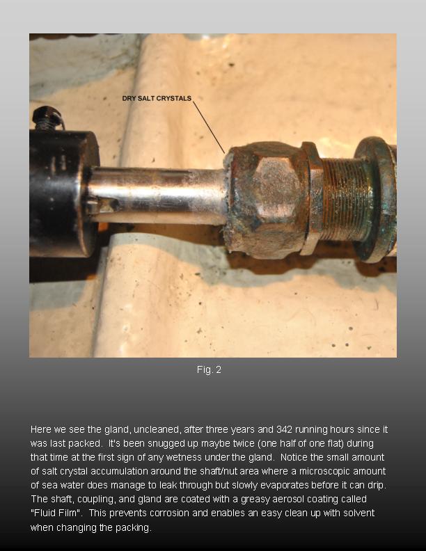

What type of flax is best?
Probably Gore, but it does contain graphite which "could" cause some problems depending on the composition of your shaft.
I've always used teflon impregnated flax and run it BONE DRY with no dripping whatsoever while running. This really irks the purists who say your your shaft will score, the packing will burn, the honey on the boat next over will stop wearing short shorts, and my brother-in-law will come to live with us. The real truth is, the leakage is so microscopic, it evaporates before it can drip. The area under the gland is always dry. And the gland and shaft are cool to the touch.
