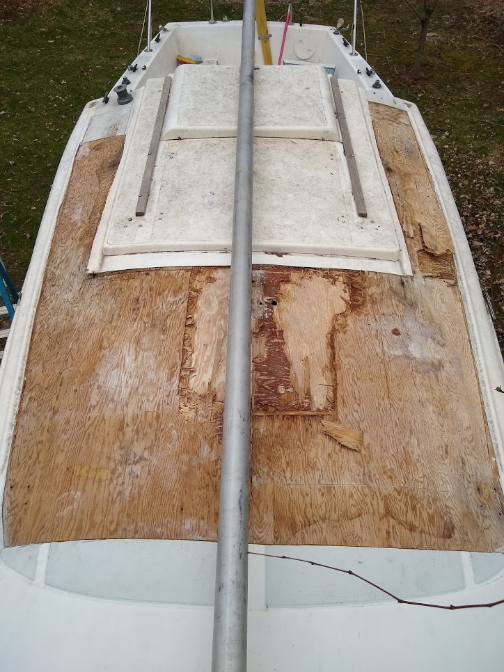

My Boats an '84. I don't know about the cockpit i think that's pure fiberglass, besides that everything you stand on is cored with 1/4 inch ply including the hatches and sliding part over the pop top. The top deck is 2 flat pieces like you would buy at Home Depot. There is a seam right down the middle where moisture just followed right down on mine. One of the mast step bolts goes right through it. So make sure its sealed.

I bought this boat as an experiment and to get experience on costs and to learn how to do repairs and learn how things work. I didnt know anything about sailboats or boat building or repair going into this so my cuts and repairs are newbie repairs. top deck seems solid like new now though.

I had another look at your reply to my questions and also looked at the attached pic. It appears that you got to the coring from the deck side. Why did you not approach it from inside the boat? From what I've read that is the more common method. How and what did you use to re-core and recover the deck?

It seemed like it was easier to bend the flat sheets of plywood from the top and I didn't want to crouch a lot. My plan was just to do a hack job on the deck then put textured kiwi grip or something to hide any imperfections there was a TON of spider cracks I had to grind down all over in the texture (basketball sized round areas) so it would never look good.
