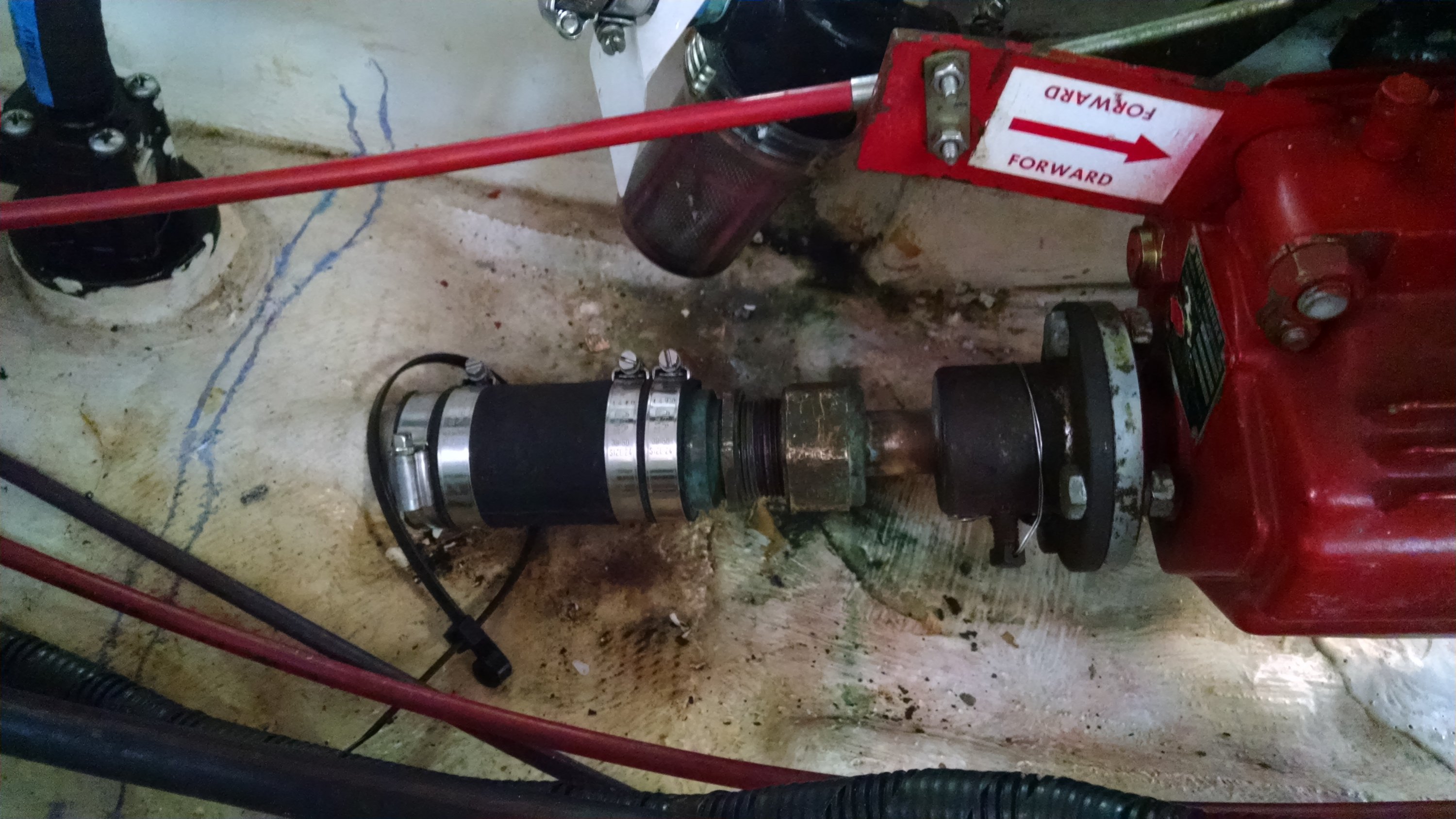

OK. So I decide to replace the packing material in my stuffing box as it has not been done yet since I bought Mystic in 2013. I read all the posts and studied the process to death. I bought the 3/16 flax and today I dove in to get it done. I am having an unexpected problem as I am having a seriously difficult time getting the big nut loose that holds everything in the packing box. All of the threaded surfaces are moving fine. The friction appears to be between the packing nut and the prop shaft. I polished the shaft as much as I dared to reduce friction but I have to really use muscle to move the nut. The threads are fine and nothing is stripped as I moved the nut back up the shaft just to check. I would like to ask the group for wisdom or to see if there is something I need to look out for. I don't want to force this and cause a nasty expensive repair by doing something stupid. As always all wisdom welcome.

There is a very thin locking nut on the tranny side. In your picture it looks green.
John. There is a locking nut but that is already loose and is on the left hand side (aft) of the packing nut. I think the green you are referring to is the front of the packing nut toward the transmission. But I could be wrong.

Sorry, you are correct. many people have taken a hard whack with a hammer to loosen.

No hammer yet - please. The packing nut - furthest to the photo right - contains the packing material. Once unthreaded that nut should slide right up the shaft all the way to the shaft/transmission coupler. Are you saying it will not slide toward the transmission?
If it will not move forward perhaps the shaft has worn and the old packing was set into the worn area. You need to slide the nut forward to pick out the old packing and inspect the shaft surface.
In short, there is nothing in the way once the nut is loose from the threads.
Charles.

That is what I am thinking. I am going to try it again today. I can't believe there is so little clearance between the shaft and the nut. I will report back on my progress.

Yup. I have the same ones you have. I got them from Harbor Freight and the are HUGE. My marina is in an urban waterfront and I got some serious looks as I was walking to the gate with them. I already have everything loose. The problem I am having is that it is taking a lot of effort to continue to unscrew the packing nut. I want to make sure I am not doing something wrong that would strip any threads or damage the shaft. Is this normal? Maybe this is just paranoia but better safe than sorry.

I would separate the coupling before continuing. From the photo it looks as if the shaft log assembly is deflected downward. This could result in significant friction against the packing nut when it reaches the end of the shaft threads. The coupling is easy enough to separate.
As Roy says to ensure everything is as free as possible.
If that doesn't get things moving, I would still have to suspect that the friction is between the nut threads and the log is the culprit. Try rapidly applying a quick blast of heat to the nut with a torch and then try moving while the nut is still hot. Probably a two man job. Use extreme caution so as to not overheat the hose.

This is common with boats in salt Water, Again... hit it on flat part of nut with a hammer. This is from a post on Monday for a Catalina 30, after numerous folks told him to hit it with a hammer. "Saturday I got to the boat in howling wind and rain went below and go to work. A couple of shots of BP Blaster and a few taps with a hammer and the lock nut began to turn. I worked it until it would turn easily over enough threads to adjust. I worked the next 3 hours trying to get the correct drip ratio. but finally got 6 drips per minute, locked it down and ran the engine in both forward and reverse. everything seems to be good but I can see this is an item that needs to be checked often. Again thanks for all the great advise...Brad"

Put a monkey wrench on it and wack it gently a couple of times with a METAL hammer. A couple of good CLANGS will cause it to loosen.
As a final note, once you've finished re-packing the gland, lube up the internal threads with waterproof grease (Syntef, SuperLube, etc.) which might make it a little easier next time you take it apart.

Can you clarify whether the packing nut (the big one on the right that has the packing inside) is turning freely on the threads. If not it should be remembered that any torque you put on it has to be counter acted by the rubber tubing.

Update. I was at the boat all day. I greased the prop shaft with silicone grease and hit the threads with some more PB blaster. The nut finally became loose and I was able to slide it toward the engine. I spent most of the remaining part of the day digging out the old packed in flax. It took 3 solid hours and I went through 4 dental picks. I cut the new flax and started to install it. I now have a new problem. Catalina specifies 3/16" flax in its shaft diagram. When I installed it there is daylight between the flax and the shaft. It looks like the flax should be 1/4" instead of 3/16". This would qualify as a dumb question except the Catalina doc says 3/16". Lowell from Catalina is on Vacation. Shouldn't the flax fill 100% of the void between the inside of the nut and the shaft? All wisdom greatly appreciated.
