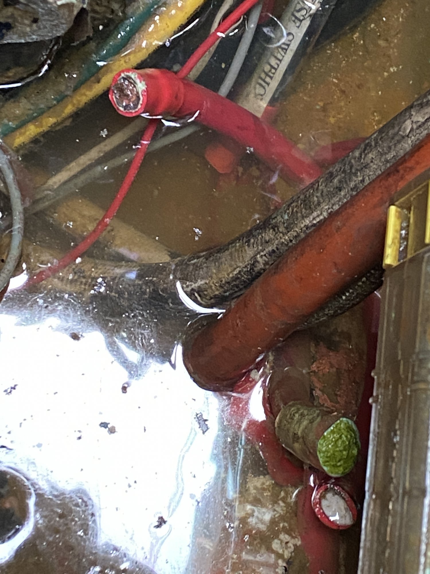

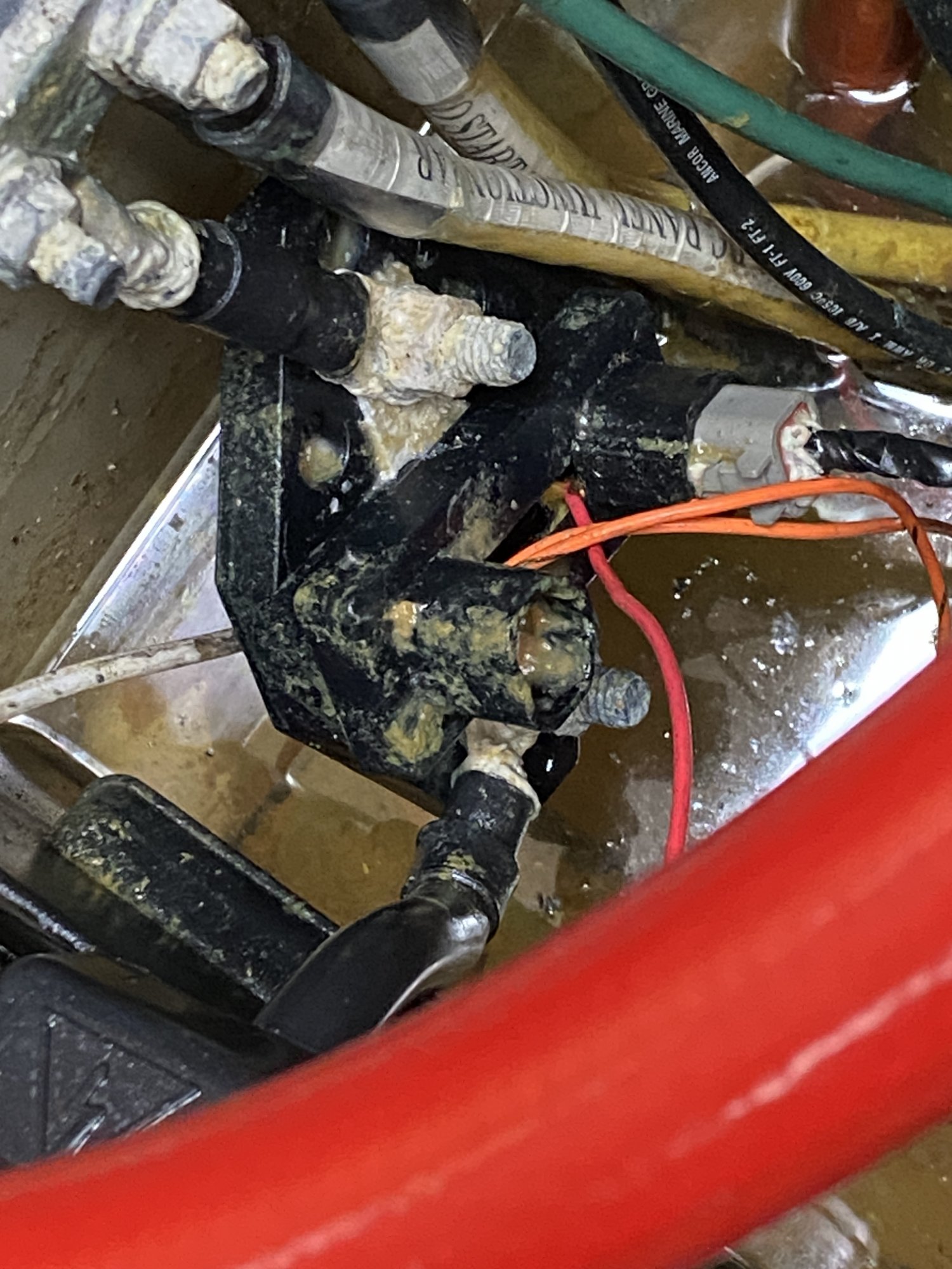

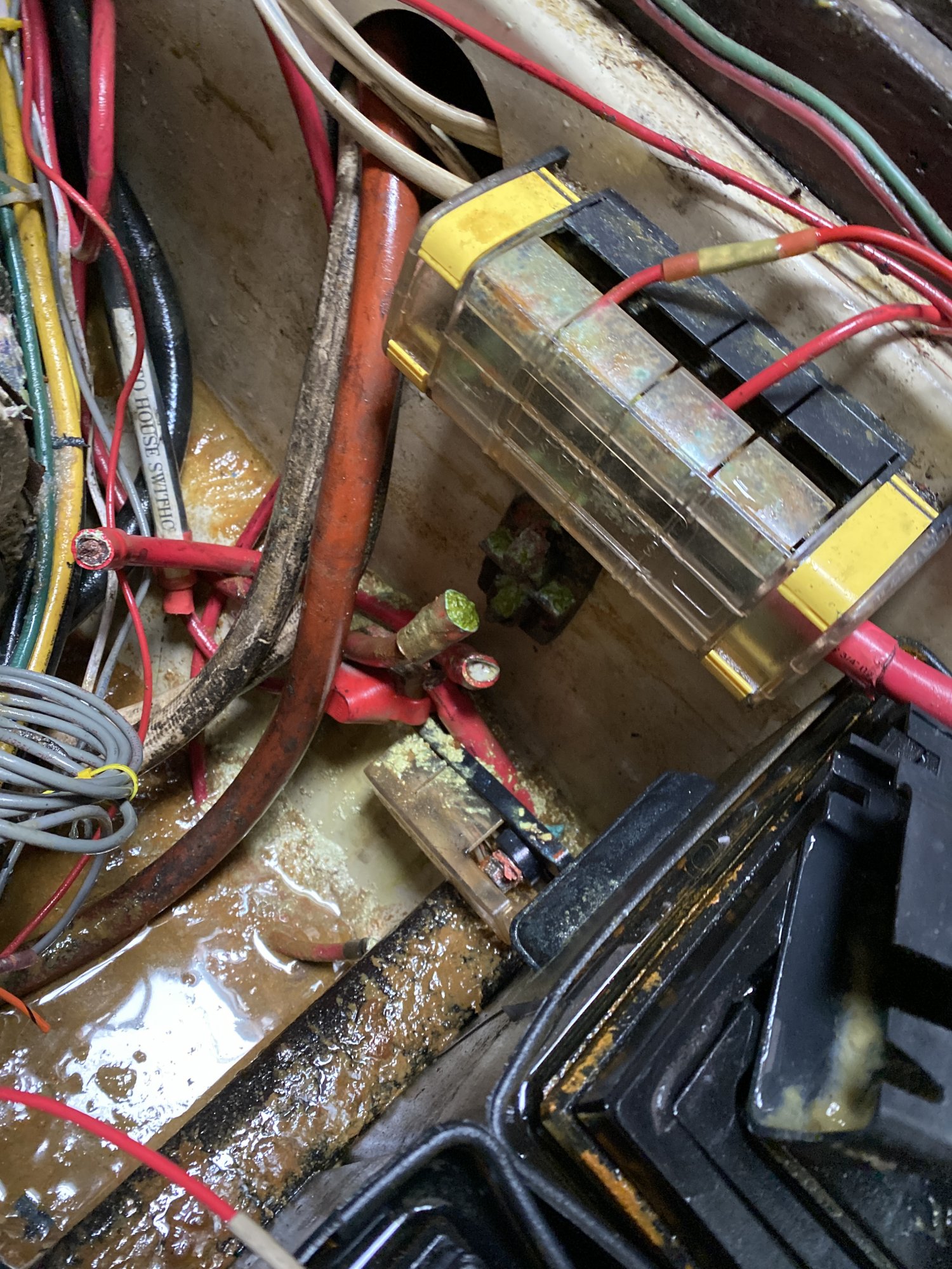

To provide clarity, my diver is a professional. He works commercial boats. He shares that diving to weld a part back on a commercial fishing boat is when he most often has experienced that tingle.
The issue is it can happen anywhere there is electricity and boats. Most often it is a poorly maintained power pedestal or an aged power boat with poor electrical connections. That said, It was an eye opener, last fall, when my boat filled with water. The damage to the batteries and the shorted cables was scary :yikes:.
I was on the phone with the marina maintenance crew (as I was driving to the boat) that was going to pump out my boat. I reminded to disconnect the boat from the power pedestal. The first reply was "What?" "Oh yeah! That would be a good idea." Of course by that time the batteries were dead.
Here is what I saw when looking at my battery connections. Talk about corrosion.
