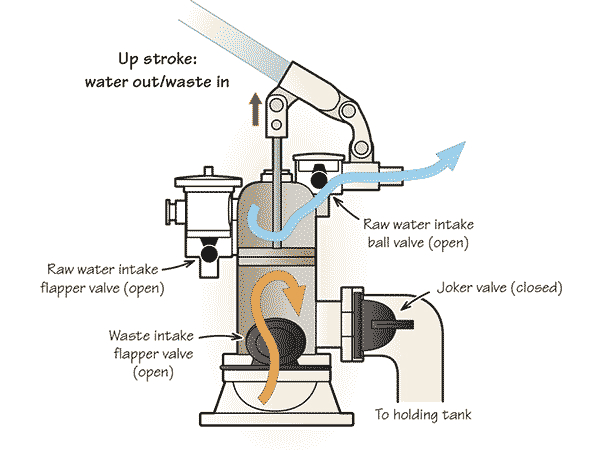

This may be one of the few times when replacing the joker valve may be the solution.
Most people think that the only thing the joker valve does is acts as a check valve to stop backflow from returning to the toilet...But that's a joker valve's LEAST important function...in fact, it's THE single most important replaceable part in a manual toilet.
Here’s why: On the upstroke of the piston, a vacuum is created in the area beneath the piston. This causes the joker valve to close tightly, and the flapper valve beneath the pump to open, allowing some of the contents of the toilet bowl to be drawn into the bottom half of the pump. Then, on the down stroke of the piston, the flapper valve is slammed shut, and the effluent is forced out of the bottom of the pump, through the joker valve, and off down the line. But when the joker valve becomes worn and/or there's a buildup of sea water minerals on it, it can no longer seal tightly on the upstroke of the piston...less vacuum is generated when you pump it. And as it becomes more worn less and less vacuum, till finally the bowl contents simply move up and down a bit, but don't go anywhere. Sometimes the flapper valve needs to be replaced too, which is why toilets should also be rebuilt at least every 5-6 years as PREVENTIVE MAINTENANCE.
