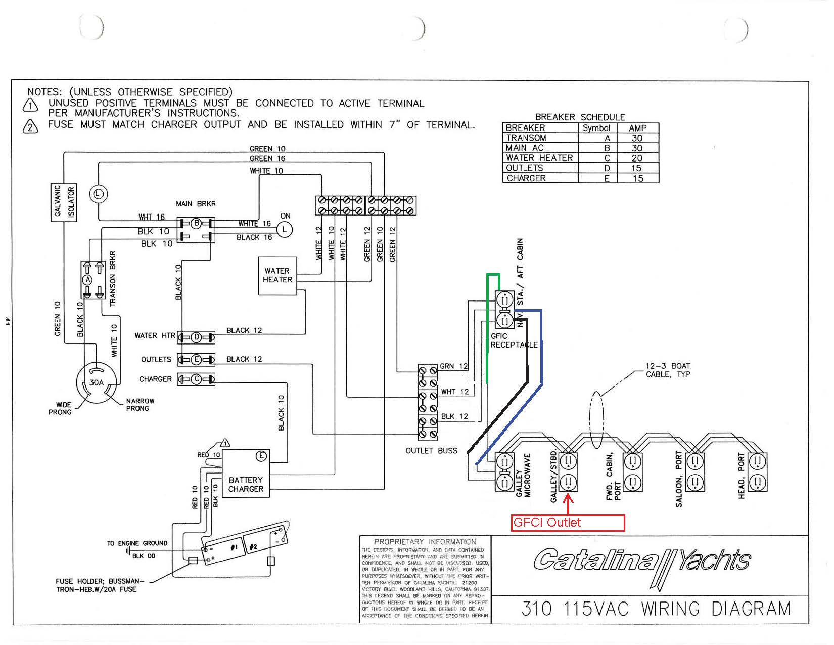

We have two GFCI Outlets on the boat. GFCI Outlet #1 is at the navigation station and according to the wiring diagram should be the only outlet connected on that run. GFCI #2 is at the galley counter and should be the first in the line protecting the rest of the outlets on the boat.
Now here is where things get a little strange. When GFCI #2 is tripped, no problem. All of the other outlets are tripped down the line. But when GFCI #1 get’s tripped, it also trips all of the outlets, including GFCI #2. Further, the bottom outlet on GFCI #1 will continue to work when tripped.
Looking at the wiring diagram there is no reason why tripping GFCI #1 should disable the outlets on the leg for GFCI #2. But it happens.
Also, I don’t like the fact that the bottom outlet on GFCI #1 continues to work when tripped.
My plan is to verify the wiring is as per the diagram. I suspect that somehow the factory wired the GFCI outlets different than shown. I am also going to replace both GFCI outlets, which brings up another question.

I'd check to make sure that GFCI circuit 2 is not fed off the load side of GFCI 1...also check that the GFCI outlet 1 is properly wired with source on the source terminals not on the load terminals

Centerline it sounds like GFCI #1 is improperly wired. The A/C Power goes from one breaker on you panel and the black wire should go straight to the hot side of GFCI #1 AND GFCI #2. The hot wire is running to GFCI #1 and through it and to GFCI #2. If you make sure the hot wire, is direct to both GFCI #1 and #2 (sorry I can't draw this out for you) you will stop this problem.

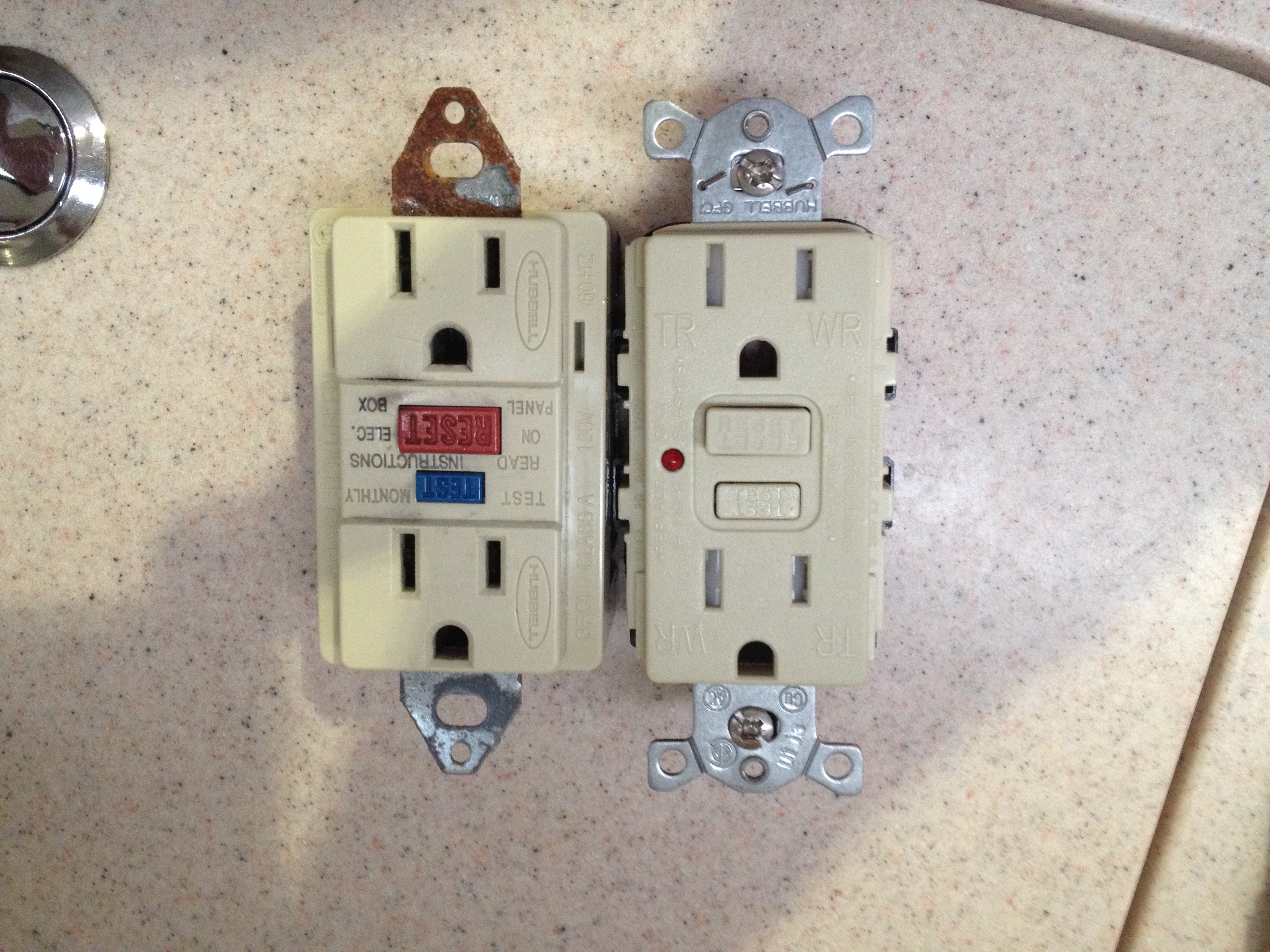

I ordered the new GFCI outlets. I went with the Hubbell GFTR 15: http://www.hubbellcatalog.com/wiring/section-h-datasheet.asp?FAM=Ground_Fault&PN=GFTR15
It's a commercial grade, tamper resistant, weather resistant, UL 943 Class A GFCI receptacle. It is not hospital grade. I couldn't bring myself to spend that money given our current plans.

Your boat wiring diagram is correct. Each GFCI receptacle is wired independently.

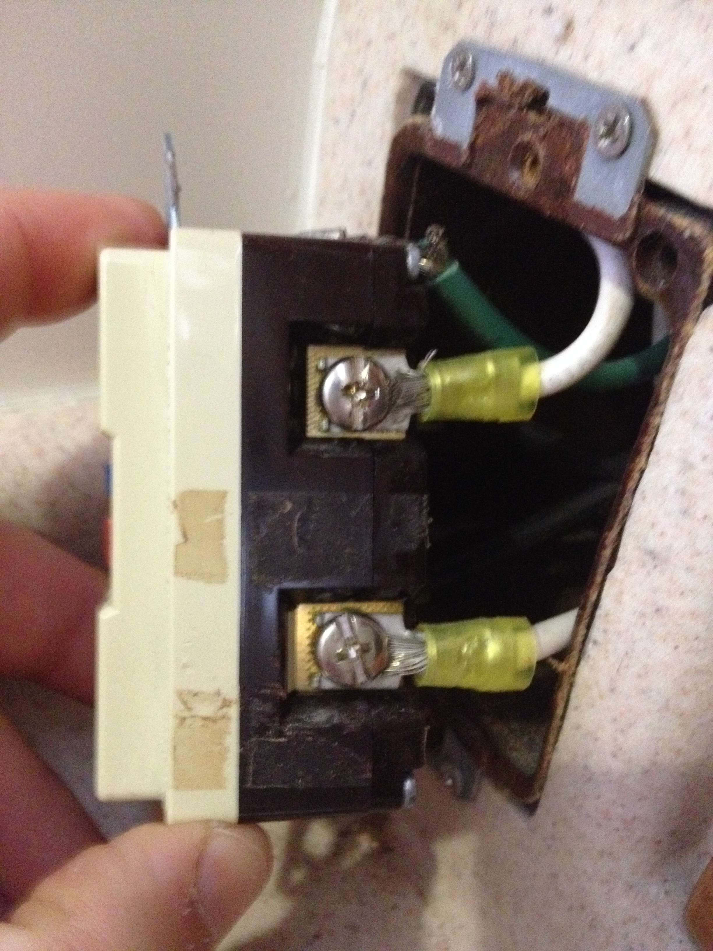

Yesterday I worked on this issue and here is what I found.
I started with the outlet in the galley. This one was easily accessible and the wiring was as expected.
Existing Wiring
Old Outlet on right (Hubbell Class A UL 943). New Outlet on left (notice the TR and WR)
I completed the change on the first outlet without an issues.
When I took out the second outlet I found an issue. According to the wiring diagram provided by Catalina, this should have been a single leg outlet with only a feed line connected to the top of the outlet and nothing connected to the bottom, load side. Well it was connected on both sides. I tried to look around and figure out exactly how everything was run. However, all of the wires were bundled in wire loom and I couldn’t follow it easily. It’s a little cool out and the temp in the cabin had dipped below 55 degrees so I decided to just put the new outlet in and then figure out how the wires were run.

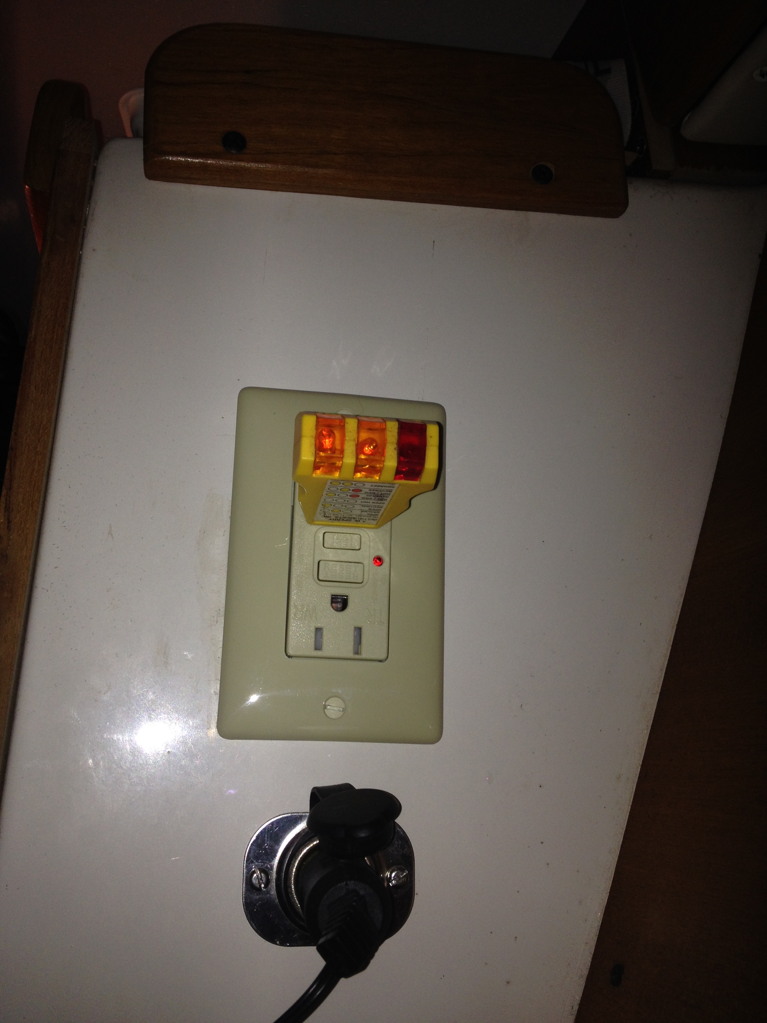

I re-energized the outlets and checked to make sure I wired everything correctly. I used an outlet tester to make sure I had the polarity and ground connected correctly.

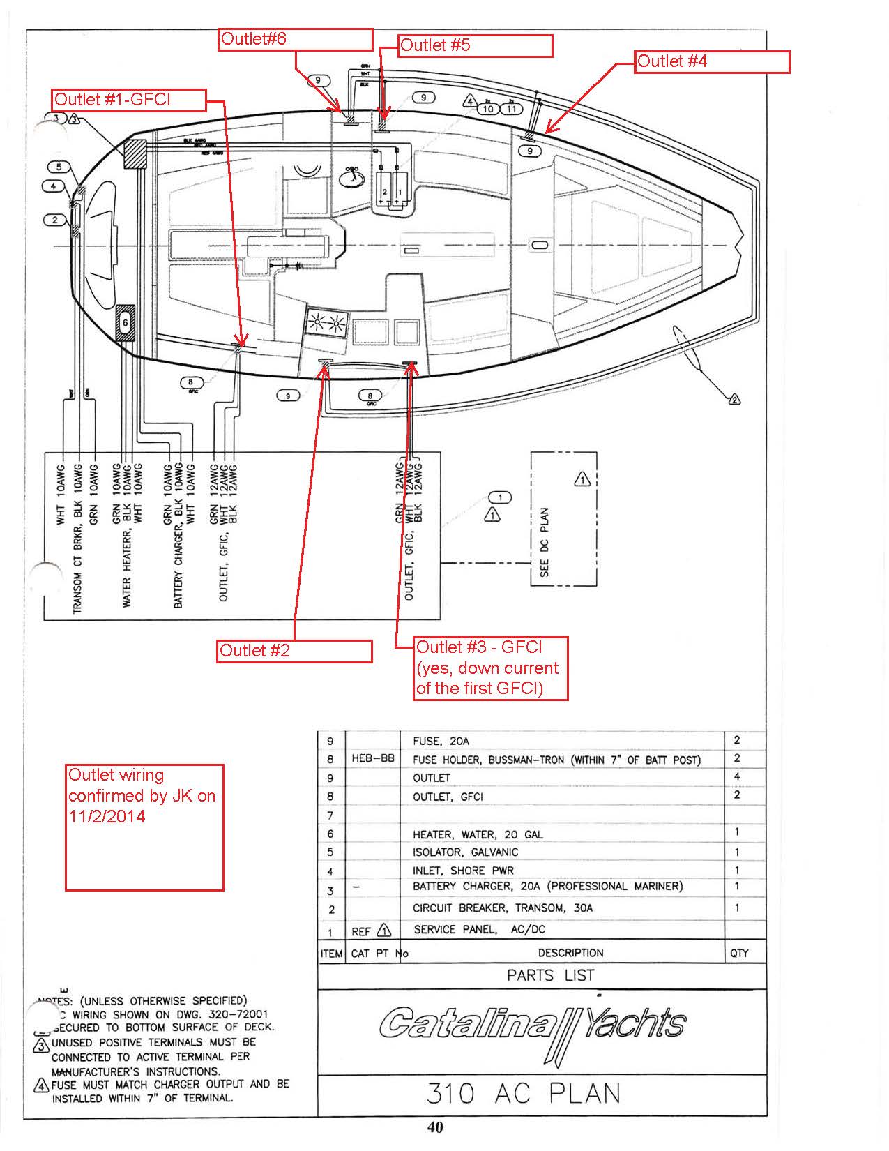

I then went through all the outlets and figured out what order they were wired and what the GFCI’s affected. Here is a revised wiring diagram based on what I found.
So all 6 outlets are on a single leg of outlets and the 1st and 3rd outlets in line are GFCI. This is incorrect wiring and probably responsible for part of the strange issue I was having. At the very least it’s a redundant GFCI.
My plan is to split the outlets into two legs. I think I will have outlets #1 and #2 on leg one and outlets #3 – #6 on the other leg. This would mean running a new 12-3 wire from the electric panel to that outlet. And then disconnecting the wires that run from outlet #2 to outlet #3. I am not a big fan of keeping unused wires in place so I will remove the old wires.
But now I am wondering if this is necessary. All the outlets are fed by the single 30 amp breaker. If I split the legs, both legs would still be fed by the 30 amp breaker. So is there any benefit from separating the legs?
If not, I could just remove the second GFCI outlet and replace it with a standard outlet. I could then save the GFCI outlet for next time I need to replace GFCI outlet #1.
