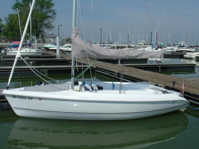

Some of us are lucky
My 2005 H170 never had any cracks. However, I did store it inside in the winter. I had read the abundant warnings about avoiding any sudden temperature changes or temperature differentials on the hull. They are pretty little boats, but do require a bit more knowledge regarding their care & feeding. Hunter probably should have used a different material that was more forgiving to the average boater. Fast little fun boat though!
